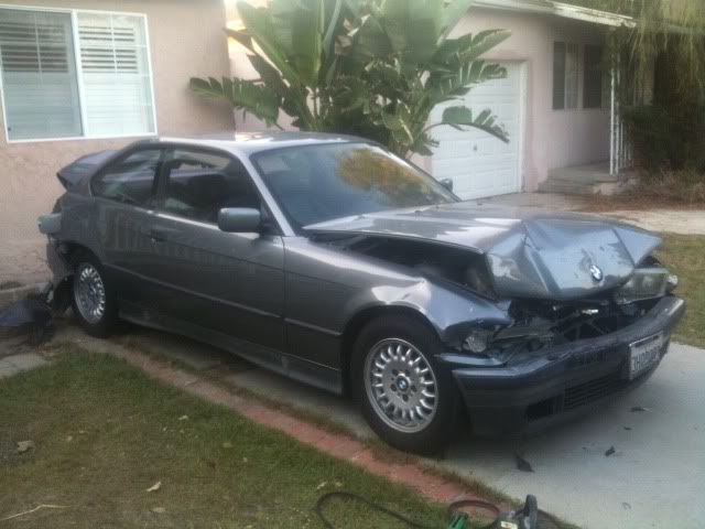

should i get this or not
  • KillaCam
    • 2103
    its a 94 325is auto with 194k
    was in a front and rear accident hit by a drunk driver
    its still starts up and the exhaust smells normal
    no signs of over heating. but idk if the motor is okay
    im hoping to get it for 400 but i know i can get it for 500
    give me your opinion,.....im only getting it for the engine, rack, seats, dash, and all electronics, and the 5 lug front
    My plains are to swap the m50 for my dying m20b27 and throw my late model m20b25 trans on the engine
    In your experience does the engine usually survive these kind of accidents and is it worth 400-500 dollars

      As long as you plan on rebuilding, I would jump on it.

        no rebuild just straight swap, if i want to rebuild someting i would start my 2.8 stroker

          I think $400 would be a good price but I don't think I would go over that for this car.

            That mileage is on the high side. You could put that $400-$500 in to an M20 and make just as much power.
            Let's not forget you'll still need other parts to do the 24v swap, that E36 doesn't have everything you need.

              Offer the guy $250, then its worth it!

                I'd say it's a decent deal. The interior and stuff you may be able to sell if you want and recoupe some cost.

                  you know that the is will have the wrong front geometry right? you need to use 96+ m3 parts to keep everything working right.

                        I buy e36 M3's for a bit more than that w/ less miles. Gotta look for deals man.

                          About to pick it up tomorrow for300$

                            300 bones sounds like a good deal to me, E36 arent free up here yet like they seem to be down south.

                              What parts for an m20???
