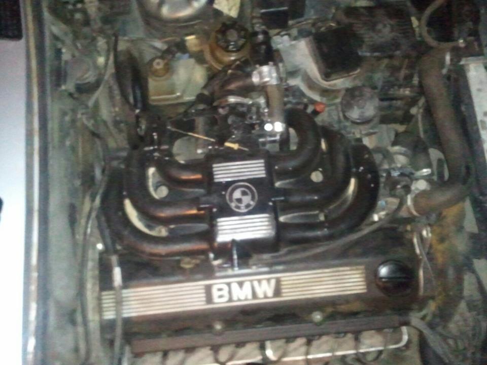

Well the guy I bought it from said the head on it was replaced from a previous timing belt breaking. Gonna see if he went ahead and put an i head on it. I'm not really upset about it, just kind of unexpected.

Hang in there, salvation is in this forum, you've made your down payment.well it is an 88 "super" eta. Whatever that means. I've tried researching that but all I get is the "my 'super' 1988 e30 build"...don't care. Pics are on a previous thread titled "finally an e30 owner". And no I didn't really think of the tachometer only going to 6k cause I was too fucking excited cause I finally found an e30 in my area, and at the time I didn't know the redline differences, yes, huge fail on my part.

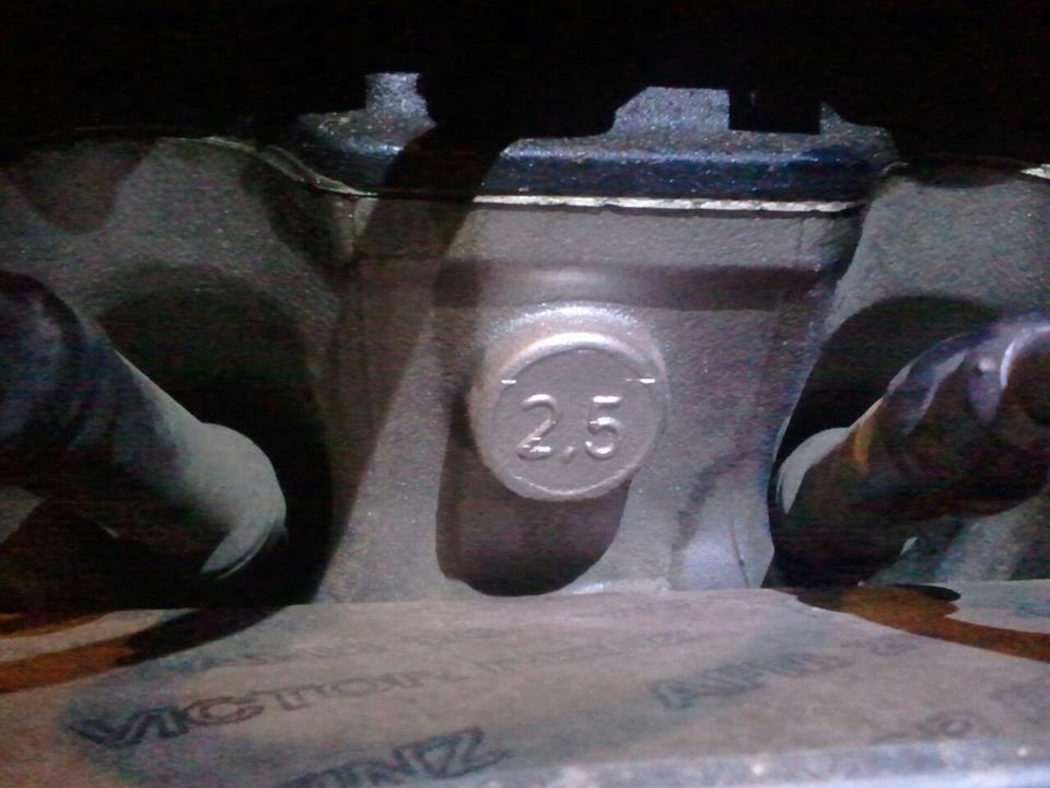

^thanks I'm already on it looking up the 327i builds. Reading more on these builds and results makes me feel better about this misunderstanding ha. Per dollar in the end would the "super eta" be more potent wise than a 325i? I read that 1988 has an 8.5/1 compression which is great for boost.Originally posted by Wh33lhopThis is r3v. Check your vaginal sand at the door.Comment
I really don't think the 2.7 i is more potent than the 2.5i, it seems compression ratio is the main problem. There are ways to get the cr up, but it costs.

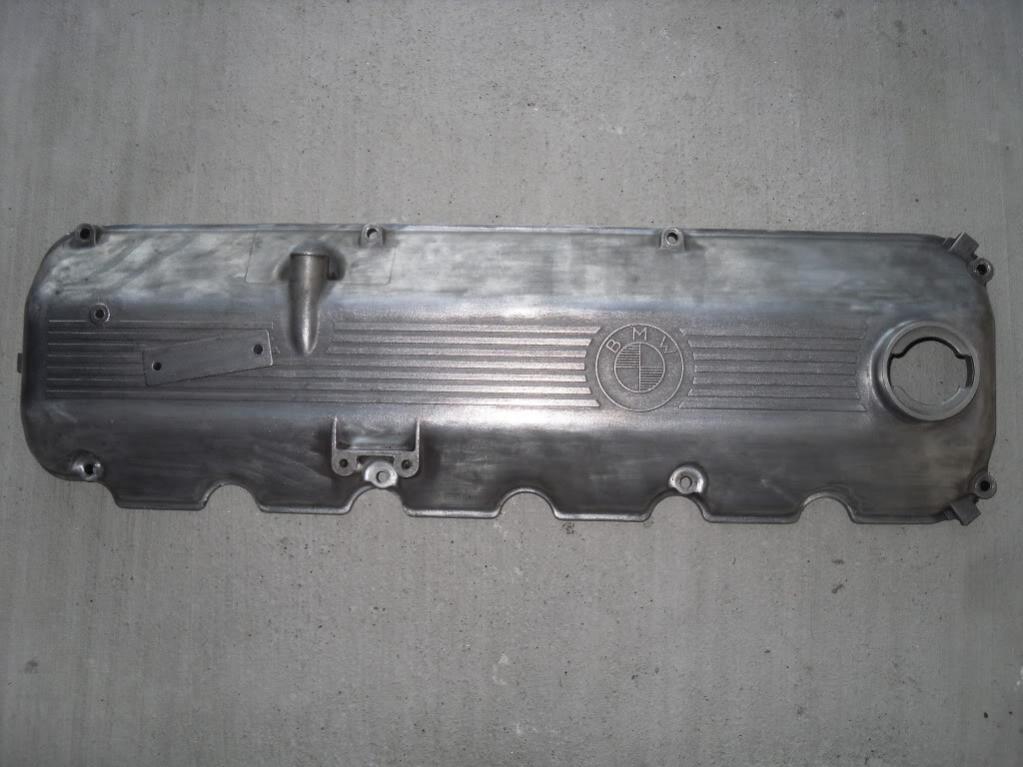

Pull your valve cover and see if you have dual valve springs or single.sigpic

Yeah, I think that's an e intake, not a super e or i intake. Are you sure about the valve springs? I thought only the i came with dual valve springs (one inside the other @ each valve).sigpic
