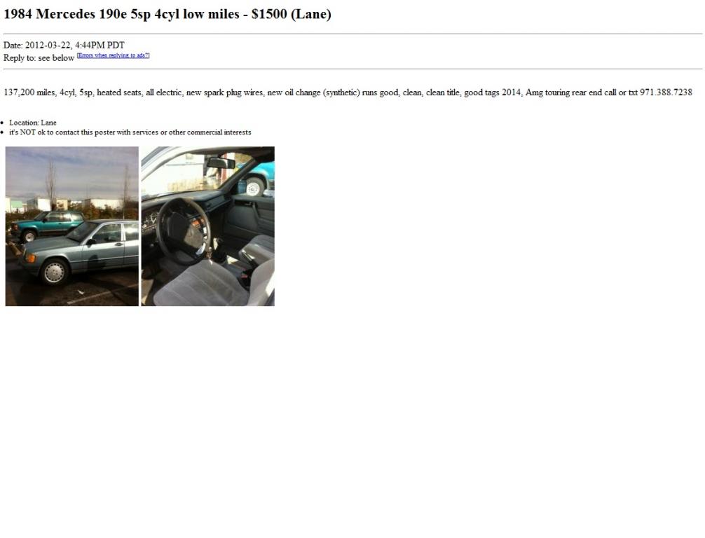

                Well after almost a three hour round trip, I turned it down. Never seen a car so misrepresented on craigslist before. This things paint was shot and some of the panels had different shades of blue. The bumper covers were cracked with creases in the rear body with rust in the creases. Likely fender benders that were never fixed. The interior was trashed with entire chunks of foam missing from the dashboard, and the door panels were peeled up from the sides. It was parked in a parking lot where we were supposed to meet. I got there early and saw that one of the windows was partly down and it was pouring rain. Even the roof trim was not attached and pulling up.
                Thank you Tom from Eugene for wasting my gas money. After looking at it, before he even arrived I called him and told him I was passing. I thought that was the right thing to do instead of just driving off, he then has the balls to say "Well you could have told me earlier you weren't serious about buying it".
                Dick.
                Here's a screenshot. I'm serious in that these crappy cell phone pics are probably the best angles to show this car. Just because I want a cheap car doesn't mean I'm a sucker. Should have known things were shady.
