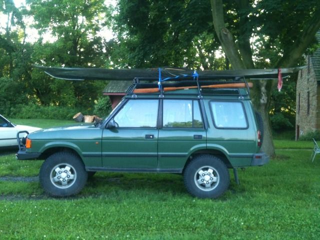

                    #114
                    Here's mine

                        Originally posted by quickervicar
                        Here's mine
                        Nice! Love it!
