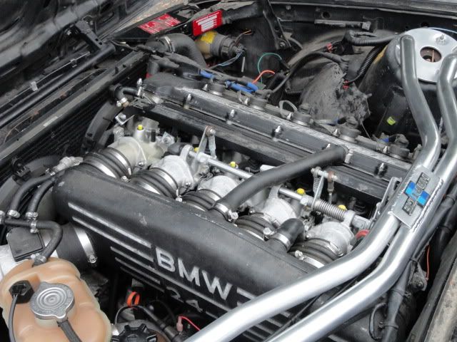

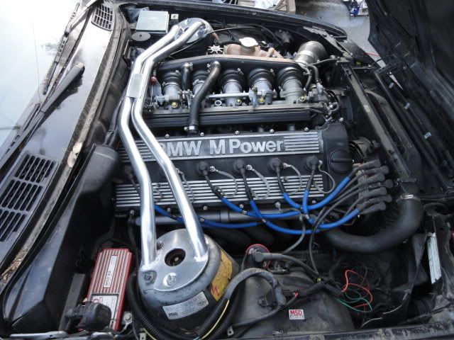

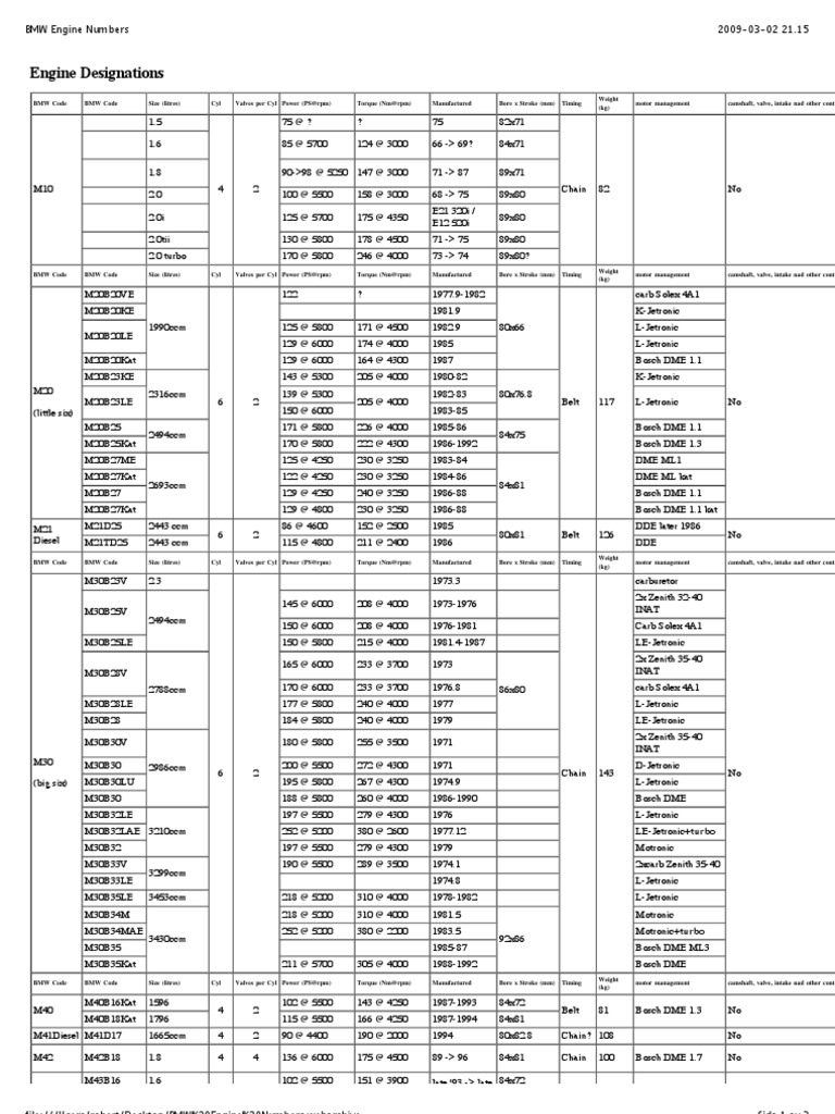

E30m3+m30b35=?
  • dude8383
    • Jan 2005
    • 10387
    This thread is clearly going places...
    • TurboJake
      • 3780
      Fuck it.
      Leave Me Transaction Feedback
      • Mr. Tasty
        • Jul 2011
        • 3421
        m20b27
        2014 Alpine White 335i MSport
        (Daily Driver)
        Full Mperformance Aero
        2007 Black Sapphire Metallic E92 335i (6MT)
        KW V2 Coilovers
        VRSF Catless Downpipes
        • Robotin
          • Jun 2011
          • 4471
          s38B38 FTW...
          i also think its strange when people swap non S-code motors in ///M's.
          i know that there are alot of non S motors, that are more powerful than the s14, but i just figure you should stay in the S family when workin on an M car.
          1989 325i SETA stroker [delphin] R3V'd 8/31/2011
          1989 325ix [zinnoberrot] $OLD
          1970 2002 [Nevada]
          Originally posted by Herr Faust Schinken
          guy must have slid into something that doesn't look like a car vs car hit
          Originally posted by ak-
          Must of slid into Rob
          • Mr. Tasty
            • Jul 2011
            • 3421
            Originally posted by FunfGan
            inb4burnhimatthestake
            ftfy
            2014 Alpine White 335i MSport
            (Daily Driver)
            Full Mperformance Aero
            2007 Black Sapphire Metallic E92 335i (6MT)
            KW V2 Coilovers
            VRSF Catless Downpipes
            • Robotin
              • Jun 2011
              • 4471
              Originally posted by codyep3
              ftfy
              diaf
              1989 325i SETA stroker [delphin] R3V'd 8/31/2011
              1989 325ix [zinnoberrot] $OLD
              1970 2002 [Nevada]
              Originally posted by Herr Faust Schinken
              guy must have slid into something that doesn't look like a car vs car hit
              Originally posted by ak-
              Must of slid into Rob
              • e30m3s54turbo
                • Jun 2010
                • 3212
                S38 b35 or b36 add some Hartge parts.
                • fronton
                  • Oct 2009
                  • 1262
                  Originally posted by VinniE30
                  The M30 is about the same as an M5x engine in weight.
                  S38 is much more heavy and big though so I wouldn't do that.
                  False. M30 weighs 8kg less than the S38b36. That is not much difference. The S14 and S38b36 only have a 100lb difference which may seem like a lot but by the time you remove the AC and air pump, you are half way to even... with 125 more hp and ft/lb of torque.
                  Worth it.
                  • e30m3s54turbo
                    • Jun 2010
                    • 3212
                    In 1998 installed the s38 in my m3. I love the hp an tq it puts out. If you want a link to the 89 Hartge 35-24 its on a site in Germany. I owned Alpina B6 2.8 m30 an Hartge cars.
                    Here some more pics.
                    • ethirtydavid
                      • Jan 2008
                      • 2331
                      ^ yes
                      • Shangsta
                        • 1485
                        You got an M3 Pat?
                        :shock:
                        • VinniE30
                          • 2113
                          Originally posted by fronton
                          False. M30 weighs 8kg less than the S38b36. That is not much difference. The S14 and S38b36 only have a 100lb difference which may seem like a lot but by the time you remove the AC and air pump, you are half way to even... with 125 more hp and ft/lb of torque.
                          Worth it.
                          Bullshit.
                          The S38 weighs 26kg more than the M30. That's over 50 lbs.
                          The S38 also fits terrible in the e30 engine bay. The m30 can sit farther back in the engine bay with less hammering on the firewall because of the smaller 12v head.
                          oem weights:
                          If the car to be swapped is an e30m3 I would definitely choose an S54 over an S38.
                          Zinno '89 <24v swap in progress>
                          • fronton
                            • Oct 2009
                            • 1262
                            This document provides information on BMW engine codes and specifications from 1973 to 1990. It lists engine sizes from 1.5L to 3.3L, including the M10, M20, M21, and M30 engine families. For each engine code, it specifies details like displacement, cylinders, valves per cylinder, power output, torque, years of production, and fuel/engine management systems.
                            http://www.bimmerforums.com/engine_faq.php
                            Both these sources back up my numbers but who knows without really weighing them side to side will all the belt driven items connected. I'm confused where an extra 50 pounds would come from since they use the same block more or less.
                            Either way, s54 would be sweet too but not period correct which makes the difference to me. To each his own as always.
                            • =======Live Fast!
                              • Nov 2011
                              • 248
                              Originally posted by fronton
                              http://www.scribd.com/doc/46874380/BMWEngines
                              http://www.bimmerforums.com/engine_faq.php
                              Both these sources back up my numbers but who knows without really weighing them side to side will all the belt driven items connected. I'm confused where an extra 50 pounds would come from since they use the same block more or less.
                              Either way, s54 would be sweet too but not period correct which makes the difference to me. To each his own as always.
                              I say s54 as well. More power than the s38, newer, not too heavy, and theres a bunch of them around. Not sure what parts cost for the s54 but I can tell you that the cost of parts for the s38b35 went through the roof in the couple years I owned that car. I can only imagine they're more expensive now.
                              sigpic2000 323ci
                              1987 325is super etta
                              1988 M5
                              2000 M5
                              1989 944 turbo
                              1989 325is
                              • e30m3s54turbo
                                • Jun 2010
                                • 3212
                                Here some pics of my e30 m3 s54 turbo waiting on wire harness.
