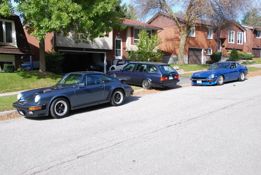

              I've had my '87 3.2 carrera for about 6 years and absolutely love it. It's a great all round car and does everything very, very well. I've used it for long distance tours, track days, and just driving around for errands. The build quality makes my e30's seem cheap - (yes, the P-car is built to a different price point)
              Drive many examples through many years to decide what flavour is right for you. Pre '89 cars are becoming very collectable and prices are creeping upward. '87-89 cars have the g50 transmission which most feel is better that the previous 915. Rust is also a problem on early cars. Engines cost a lot of money to make right if something internal goes wrong. Wrenching on them isn't difficult, but there are tricks you need to know to do things right, probably not a car you want to start your mechanical schooling on, but not impossible.
              Pre-purchase inspection is a must, and I'd stay away from heavily modified examples (unless done by a reputable shop with documentation)
              Like everything, it's a matter of what you like - check my sig ... I have a lot of cars to play with and the 911 is one of my favourites. If I only could have one car, it would be the 911
              lgb240
              `05 E46 325xiT, `89 325i Touring, `87 911 3.2, ' 74 Caterham Super 7 , `71 240z Convertible, `71 240z, `67.5 2000 Roadster, `58 MGA x2, '56 MGA vintage racer, '04 Mini Cooper S
