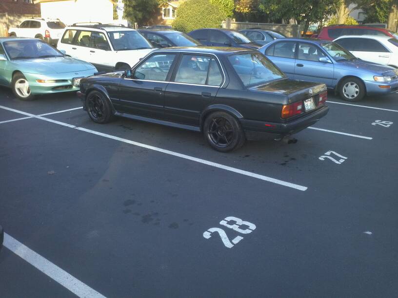

                          #42
                          AWD helps. I ran all seasons last year but really want to try the Altimax or Winterforces. My boss just put Winterforces on his 524TD and they look GREAT.
                          Take your time and have patience. Like someone said before the key is to anticipate and make the necessary changes rather than react suddenly. Smoothness is your friend here.
                          Sent from my LG-P999 using Tapatalk 2
