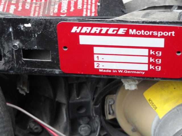

                    #39
                    Alpina keeps records of all the cars they built.
                    Hartge did not keep records of their cars they built. Hartge would put on a red Hartge vin. tag on their cars. The only e30s that I seen that would have the red Hartge vin. tags would be a Hartge H35. My old Hartge H26 did not have a red Hartge vin tag.
                    The tag should look like this.
