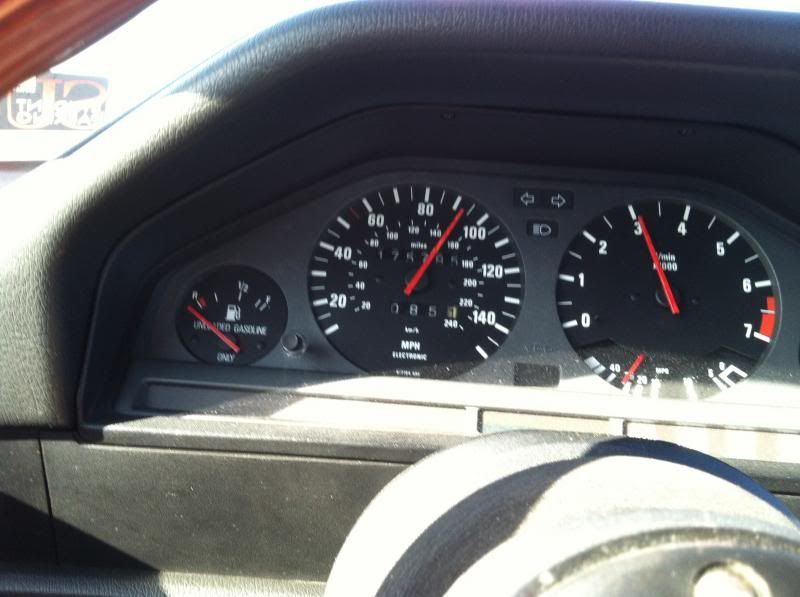

                      A m42 turning 3600 to 4000 r3v at 80mph uses more fuel. I was in the same boat as you holland before I started messing with gear ratios. I wanted to lower my freeway revs cause my car was annoying to drive such long distances at such high engine speeds. I drive almost 500 miles at a time so the higher ratio just wasnt cutting it.
                      After I swapped in a 2.93 the pep of the m42 was no longer noticeable, at least until you shift down about two gears. At 65mph on the freeway the m42 is great with 4.10 the only problem is your going 65 and you are constantly avoiding being run over by semi trucks ect. I saw a steady 9mpg increase with a 2.93 and it makes cruising at 85+ mph so much more desirable. with a 2.93 out back and the g240 trans the m42 turns about 2700 revs at 80-85 mph
                      Ive also found that other things come into play when trying to squeeze the most miles per gallon out of m42 cars. Obviously weight is a huge factor and so is wind resistance. A lowered car gets about 1-2mpg better. A car that has less air turbulence underneath it cuts through the air better. blah blah blah.
                      To stay on topic the answer to the question is yes. The m42 can handle the high revs for an extensive period of time provided it has been maintained properly and is in running well. Have fun driving it turning 4k for hours on end trying to listen to music and or hear yourself think over the constant buzzing. If you have exhaust or an intake it makes the noise significantly more annoying. expect somewhere between 27-30 mpg at best with a tailwind. As stated above the diff shouldnt be your biggest worry driving that far in an e30 anyways.
                      pic to prove im not full of shit. yes I know my gas gauge is broken. this is pushing it but you still see the mpg indicator which gives you a ballpark idea of what you are getting at that exact time at that rate of speed. This is on flat road, no wind bout 40% throttle if I had to guess.
