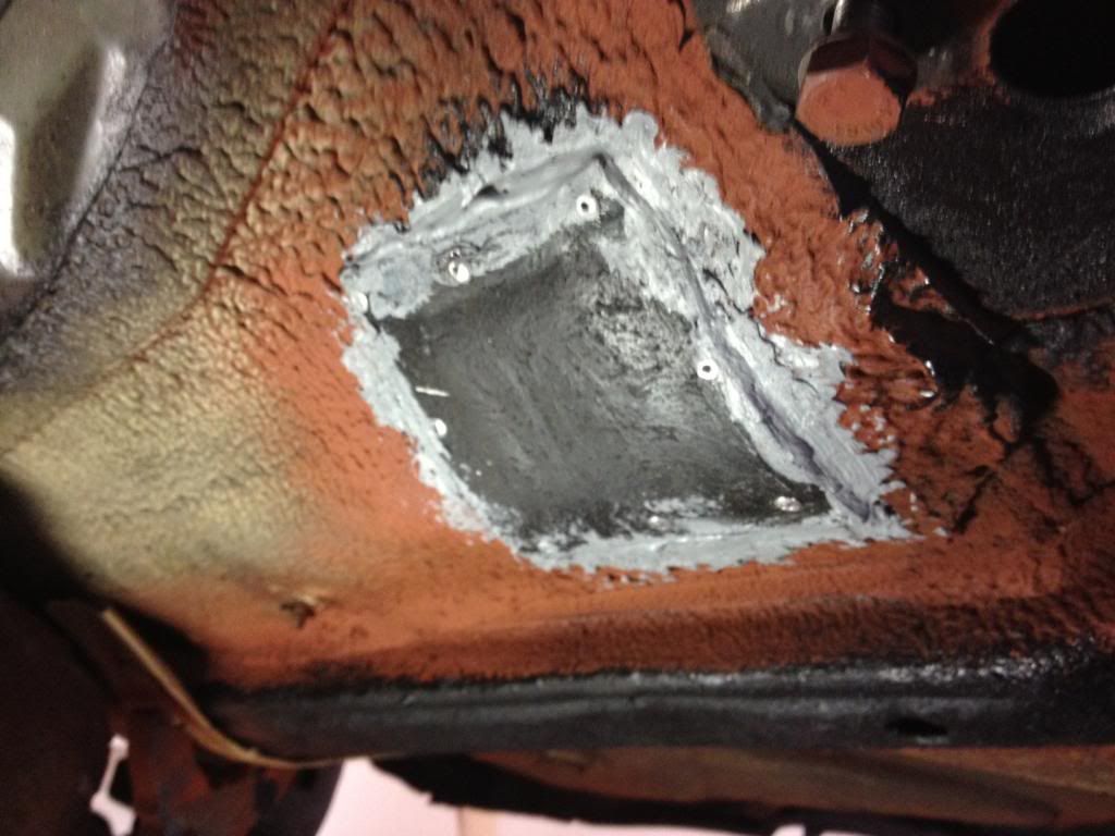

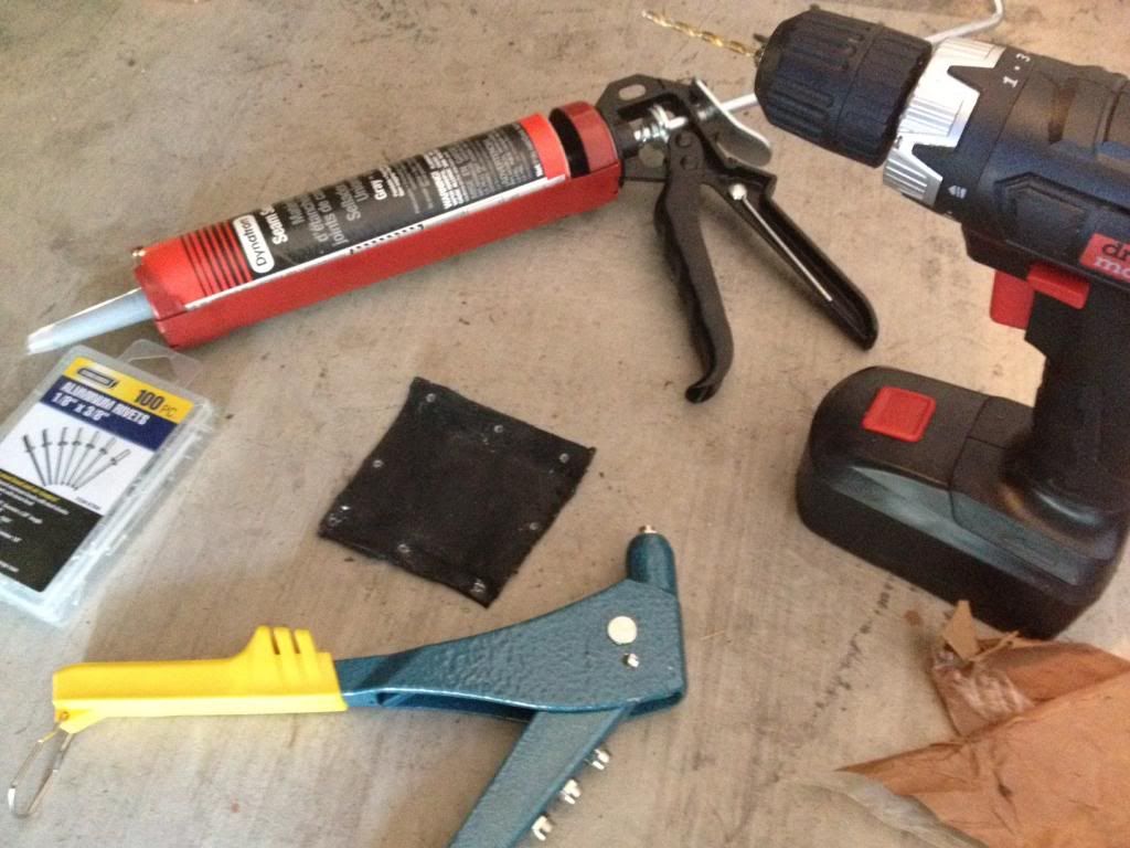

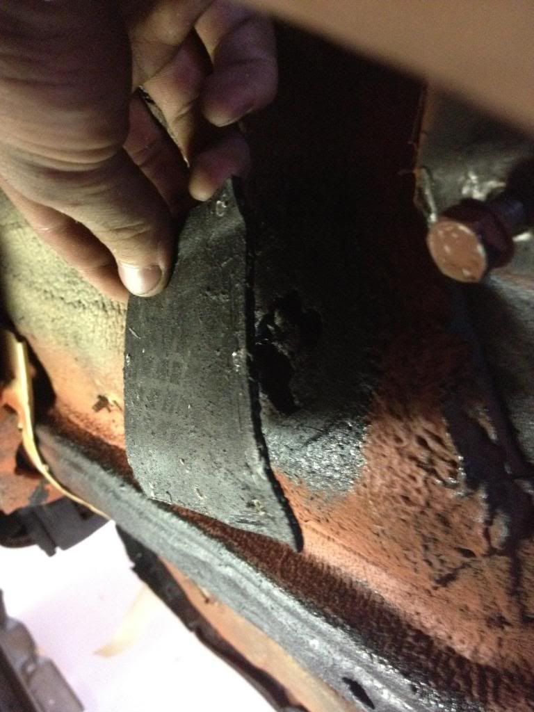

            Rust repair can be cheap.. but not to make it look nice. my only rust hole was on the bottom of my car luckily, so I grinded all the rust away down to bare metal on BOTH sides, then sprayed with some krylon zinc rust primer, then some bedliner, then riveted in a nice patch.
            That thing will last the years I need it to until I'm rich enough to pay some guy to weld all that in.. or when I'm profficient enough with a welder

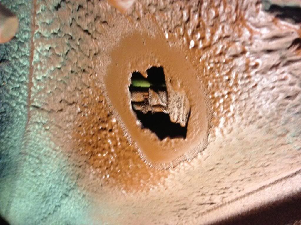

                    OK i have an update on the rust... tons of pictures... i need to know if this car is worth saving. the car is driving and idling great it may need a clutch or just new tranny mounts soon and needs some other stuff that i plan on doing.. but if this rust is too bad and not worth me trying to fix then i see no point in going any further with the car and will just off it on craigslist and start over again... which would suck... balls.... big ... WAFFLE BALLS!! but please be honest. i need opinions and suggestions..
                    I tried to take the best quality pictures i could possibly take with my terrible cell phone..
                    passenger side directly behind the door above the rocker panel
                    Passenger side bottom corner of the door frame
                    Drivers front fender, its covered in electrical tape at the moment lol i figured it looks
                    better than rust and its letting less water in we'll see if the fender is repairable or
                    must be replaced. this fender has the vin sticker but was showing body filler/bondo between the original rusty metal and the paint
                    Passenger front fender. this fender is missing the vin sticker i assume its been replaced due to rust
                    Hood
                    Trunk lid
                    Passenger side rear fender
                    Drivers side rear fender
                    BOttom corner of drivers side door frame
                    Under the drivers side door sill(passenger side is very clean with no rust that i can see)
                    of course the ends of the bumper that someone tried to glue together instead of buying brackets.
                    now its being held on by tape until i can afford the proper ebay brackets it will then be sanded and painted cause it looks like shit.
                    Sunroof
                    Rear trunk latch
                    passenger side plate light
                    drivers side plate light
                    Under the brand new trunk seal above the license plate(someone neglected the trunk seal for a LONG time, the tail light gaskets are also leaking :-\)
                    i was extremely depressed when i pulled of the old trunk seal :(
                    i would have taken more pictures of the rust under the seal but i really am afraid to take the trunk seal off.. the rust was so swelled on the seam weld where the seal attaches to that i could barely fit the trunk seal on it in a couple spots, took a lot of force...
                    • NeedaE30
                      • 397
                      #55
                      Any opinions on the rust posted above? what should be my plan of action? i've never repaired rust before and really don't know shit about body work/rust repair
                      should i keep pouring money into this car and work towards fixing the rust? or is it too far gone? this is just the visible rust.. i really am scared to go searching for the hidden rust...
