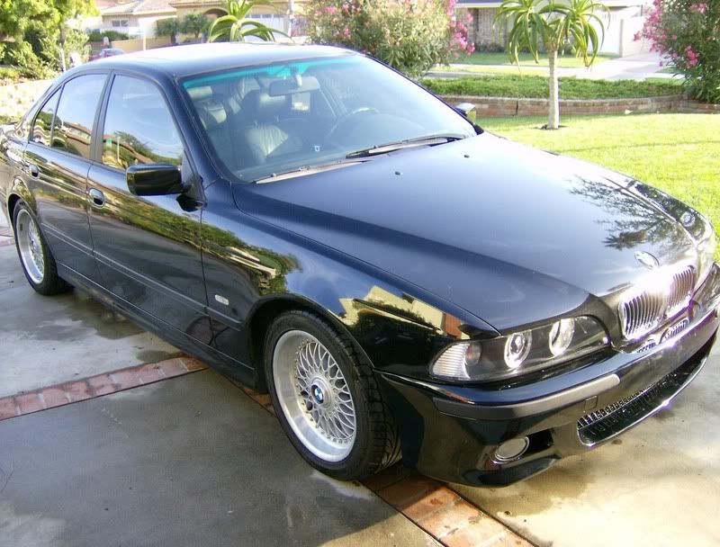

                    I've had a couple over the last 7 years. I opted for the 98 528i sport package that I facelifted to look like the later models. I am just missing the ///M steering wheel. First I had the auto, then sold it for a 5 speed. The difference is night and day. The 5 speed performs way better and gets better gas mileage. So far, I've changed tires, brakes, 4 window regulators, 2 interior door handles and a secondary air pump in addition to regular maintenance which is easy with the M52. Didn't care to get the v8. Get an OBD II code reader if you don't already have one. It will make your life much easier. The E39 is a lot of car for the money right now, making it an excellent value.
                    98 528i sport package/winter package, 5 speed, wide grills, M5 rep bumper, Euro Hella Angel Eyes, Hella Celis LED rear tails, DICE ipod integration kit, subwoofer.
