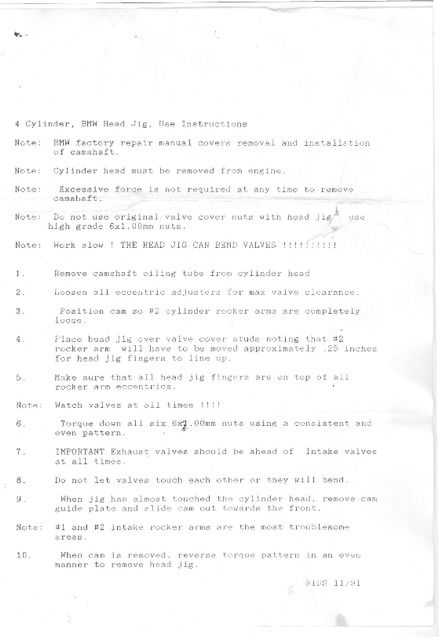

                    Found instructions for the M10 tool. Note it uses the valve cover studs.
                    Read this thoroughly, plenty of possibility to fuck up using this tool. Prob why BMW says to use it with the head off.
                    Sorry about the crappy quality.

                      the valve cover studs are unlikely to hold the strain
                      They do just fine for the M10 tool.
                      Having used that, I wouldn't use it with the head on the block. You have to dance the
                      intake and exhaust just so, and there's a real chance of bumping them into each other.
                      Which bends them, usually.
                      After going to rocker clamps (instead of the springs) I never bothered- remove the clamps,
                      and you can finagle the cam out without too much trouble.

                        Awesome LJ! Thanks!
                        Yeah, next time I'm chalking it up to a headgasket job. Fuck doing this again.
