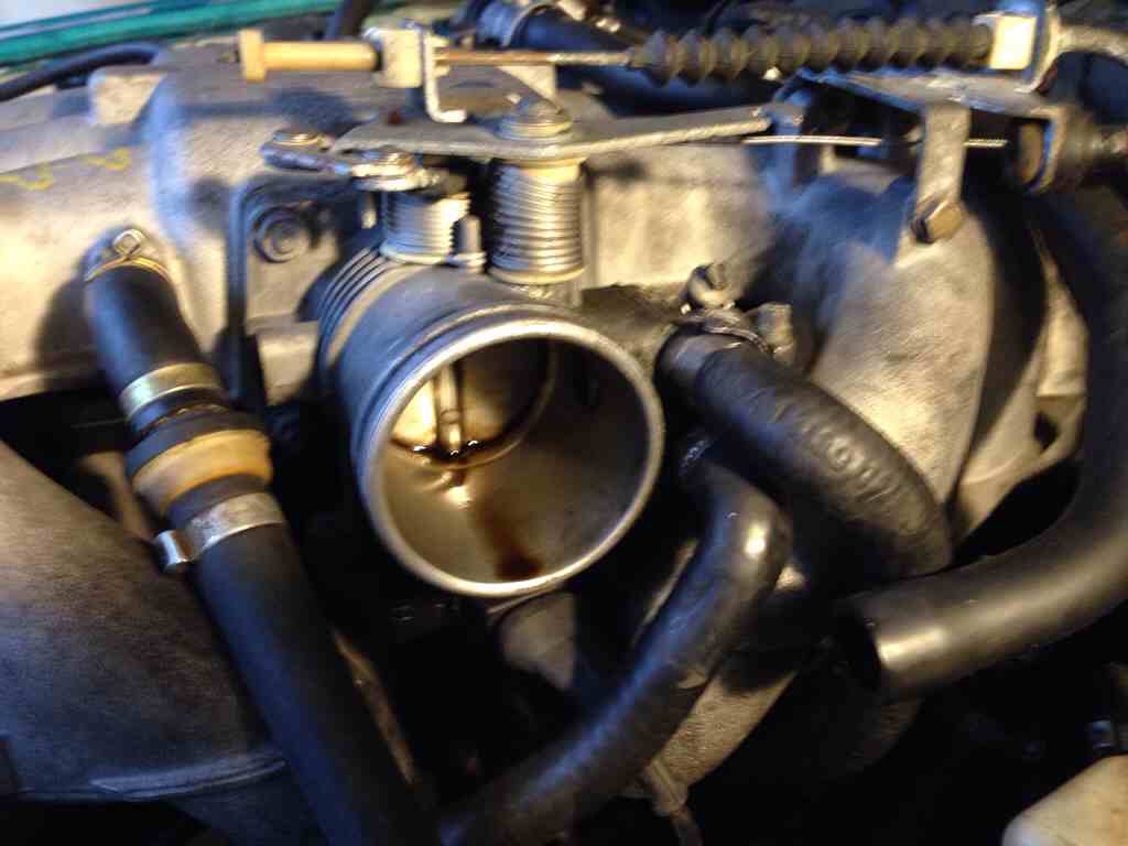

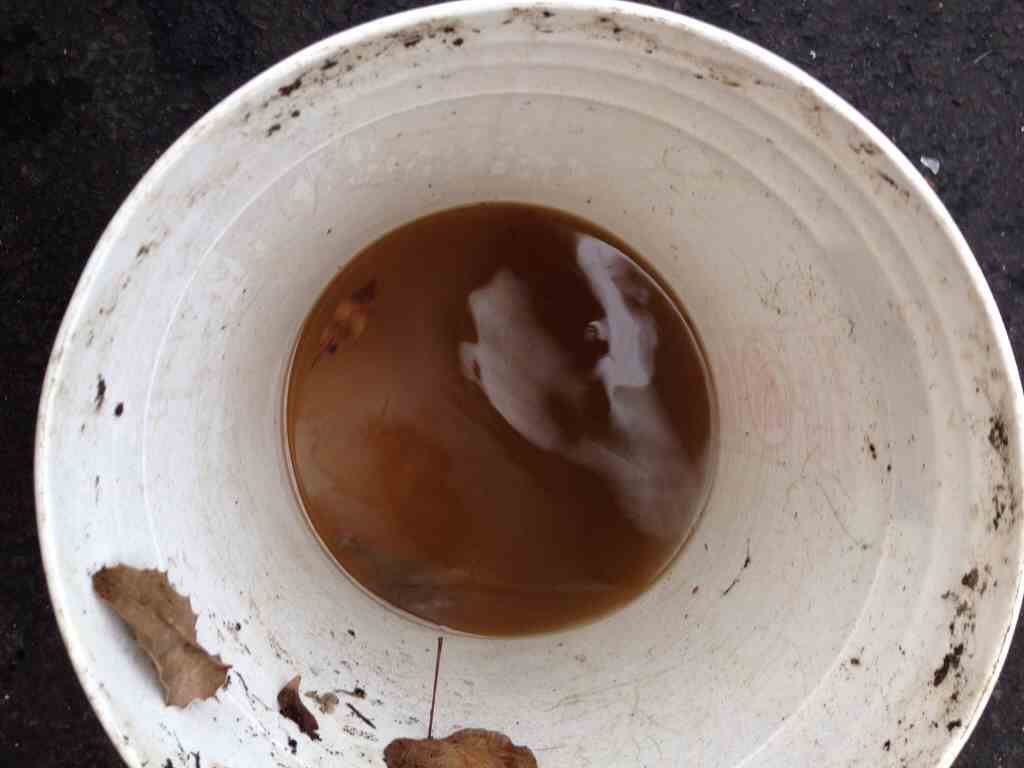

    I need help located in Bellevue,Kirkland -Seattle 206-427-3224 1985 325e if you say in the area and can help please call !! I was checking the boot for leaks and found oil in the manifold ? Also the engine coolant is brown???? I need to replace head gaskets and have no clue where to start ? 206-427-3224 Alex Click image for larger version

    A little oil in the throttle body is fairly normal.
    Brown coolant may just need to be flushed with new coolant.

      op why do you need to do a hg. more info pls.

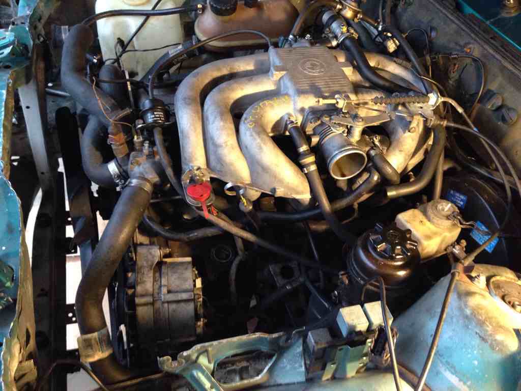

        Looks like the real issue is that alternator bracket. That thing must eat V-belts like crazy
          this x2 before you jump on the head gasket band wagon

            Flush the coolant, if you don't know when the last time it was done, right now is a good time. Also the oil isn't a big issue. It's likely from your crankcase breather.

              it is but that looks like more than a little to me, it shouldn't form a puddle. extreme vacuum leaks can cause something like that. for me it was the tube under the intake that wasn't seated properly.
