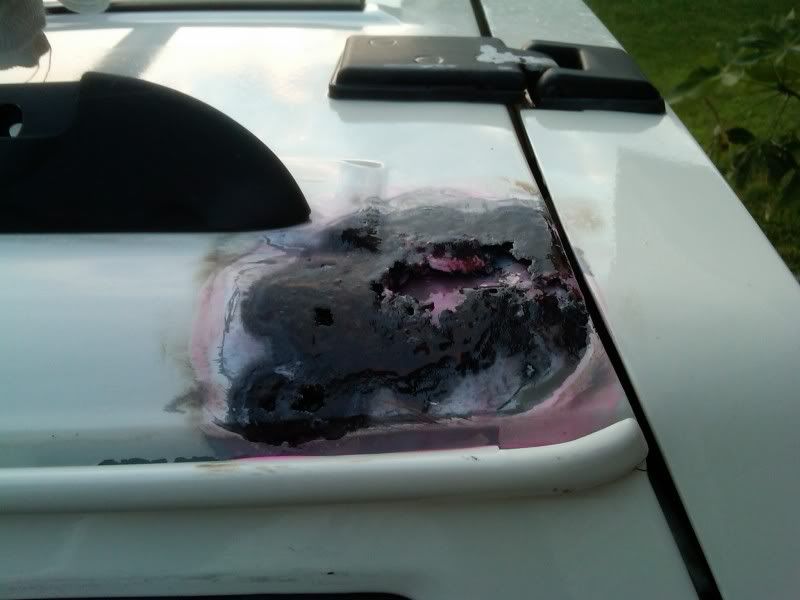

      For shits and giggles. Here's my last Cherokee. If they didn't get 16mpg every where they went I'd buy another. $75 in fuel a week gets old quick.
      Had a rust hole on the roof I fixed.

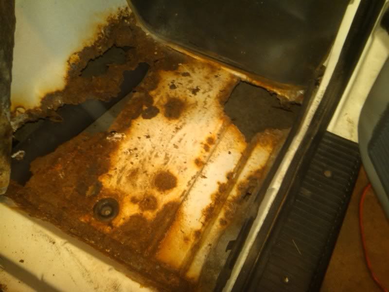

      Then I "fixed" the rust on the floors. When I looked it to buy it this was nothing more than a maybe a three finger size hole. Started tapping with a hammer and before I knew it half my floor was gone. Shit. I can't weld so I took the side of the dryer off my EX's drying machine and cut it to make patches.....she still doesn't know, shhh.

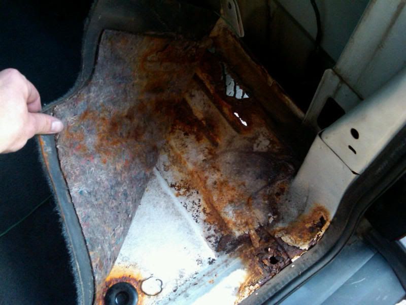

      Maybe the back isn't bad...this is before I started removing metal. That entire side came out. Had to find another dryer.
      Didn't take any finished photos. I sold that Cherokee to my good friend about 3 years ago to buy my e30. So far, the rust hasn't come back on the roof and the floors haven't fallen through and it still runs great.

              Water pumps like to fail, U-joints, RUST RUST and RUST. Check the floors, mostly in the areas I posted pictures of. The engine itself is fairly bullet proof. Check for the usual signs are age like unusual knocking or ticking, oil leaks. Check the difs as they like to leak, alittle is normal, alot is bad. Transfer case also. I'd put it in 4lo and 4hi and drive it around a bit. If it pulls to a side, whines or clunks very hard out of gear it could be trouble some but you can find replacements everywhere cheap.
