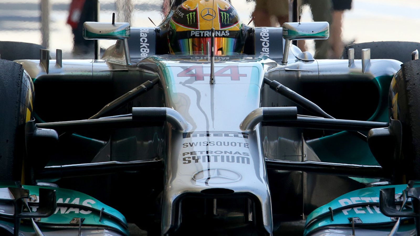

    I think this is a brilliant idea, discuss ?
    W05s technical secrets disclosed with Sky Sports F1 analyst Mark Hughes revealing that Mercedes dominant car is running with its turbo turbine and air compressor split
