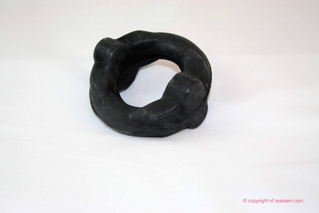

                Rear exhaust rubber ring part# 18211712838
                You can pick up almost anywhere. Bluntech, pelican parts, etc.

                  Wait the rear exhaust gasket is plastic or rubber?

                      awesome, still need to find the correct rear exhaust donut gaskets, not hangers or isolators.

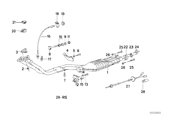

                            This should help
                            01 Rmfd-exhaust pipe catalyst 11761716743 ENDED
                            02 Hex nut M10 18301737774 $1.65
                            03 Gasket Asbestos Free 11761711717 $18.37
                            04 Bracket exhaust pipe 11761716360 $16.08
                            05 WasherA8,42 33311108205 $0.16
                            06 Hex bolt M8X20-ZNNIV S 07119903039
                            07 Hex bolt with washer M8X25-Z 107119901687 $0.62
                            08 Hex bolt M8X35207119913676 $0.36
                            09 Washer A8,42 33311108205 $0.16
                            10 Rubber bushingD=8MM 18207546579 $2.86http://www.realoem.com/bmw/photo.png[/IMG
                            11 SELF-LOCKING HEX NUT M8 07129964675 $0.56
                            13 Hex boltM8X18 07119913627 $0.24
                            14 WasherA8,42 33311108205 $0.16
                            15 Hex nut with plate M82 51117070183 $0.77
                            16 OXYGEN SENSORL=640MM10 9/1987 11781720860 $215.65
                            17 Protection plate 11781710590 $33.49+core
                            18 LAMBDA-PROBE BRACKET 11781721039 $1.17
                            19 Lock Ring 12521732696 $2.10
                            20 Cable clampD=6MM 63121364431 $0.93
                            21 Cable clampD=4,5MM 61131353865 $0.42
                            22 FLANGE 18111712064 $12.64
                            23 GASKET RING ASBESTO-FREE 45MM 18111723541 $8.37
                            23 GASKET RING ASBESTO-FREE 45MM 18111723533
                            24 Gasket ring 42MM 18111245960 $8.37
                            25 Hex bolt M8X55-8.8 07119902957 $5.27
                            26 Hex nut wiht flange M8 11621711954

                              That sure does thank you very much!
                              Get that guibo thing ordered and get the exhaust and new guibo thingy sorted!
