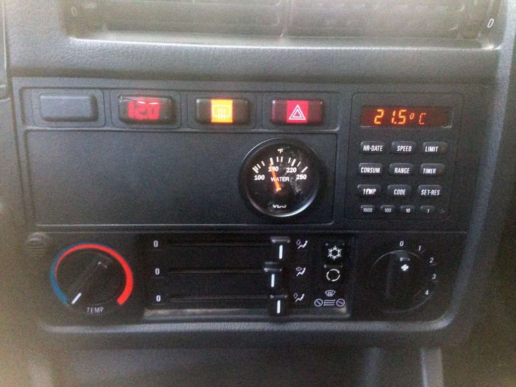

            My stock gauge also likes to jump around sometimes. It also will read high without jumping, tricking me into thinking the car is running hot.
            When I have the cluster out for something else, I'll check the grounds to try and get it working. I'm in no rush, because...
            I decided to upgrade to something more accurate and reliable.
            I've only had it in there for about a month, and it's already notified me of a pinhole coolant leak I had.
            $50 well spent IMO.
