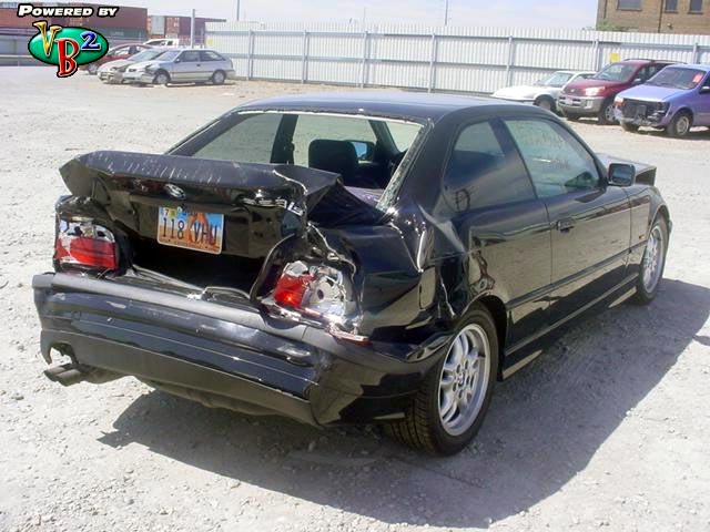

    I was following a salvage auction yesterday, and
    had a chance to pick up a wrecked 97 328is with minor damage in the front and massive damage in the rear..... so I did. 'got it for less than a thou. It's a stick car with about 100k on the odometer.
    Unfortunately, I didn't have time to come back to this web site and make sure it is a good candidate for swapping the motor into an e30. It seems like I read here a while back that the OBDII motors are harder to swap. Did I screw up?
    Richard

    They are, but I'm pretty sure you can swap the head and convert to OBDI for not a whole lot.
    If I ever did a 328i, I'd go the aluminum block route, personally.
    Something funny - the way that totalled rear end looks, kinda makes it look like a Mercedes at first glance. lol

                the fronts are useable, however you'll need 318ti trailing arms if you wanted to complete the swap.

                  Need to swap some sensors and you're good.
                  Keep it slideways!!
                  • blunttech
                    • 12850
                    obd2 head is fine. youll need cam and crank sensors,ping sensors,intake and throttle body and a few other misc items. nice score for 1k. you cant go wrong for that

                          Also, the 328i has the OBD-II midpipe, which is a true dual pipe design and shares the same part number as the OBD-II M3.
                          You should be able to use the 328i driveshaft with the 328i ZF 310/320 transmission for the swap.
                          The M52 is a pretty capable engine. If you convert it to OBD-II and swap in some S52 cams (around $250 - 300), you can make a tad over 200 whp with a few other mods.
                          Other items that you can sell for a decent price include the OBD-II air pump that is on the passenger side of the car, next to the wheelwell. These go for around $50 - 75. The climate control computer is worth around $75. You can sell the sunroof cassette for around $125. That's a sick pickup for $1000.

                            I haven't picked the car up yet, so I haven't had a chance to look at it up close. I get it tomorrow. Here is what the front of the car looks like.
                            Richard

                              Hey, looks like you can salvage the fog lights too! ;)
