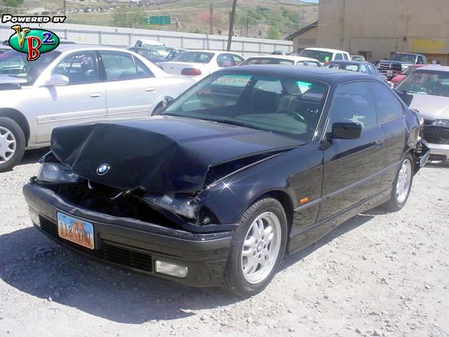

                            I haven't picked the car up yet, so I haven't had a chance to look at it up close. I get it tomorrow. Here is what the front of the car looks like.

                              Hey, looks like you can salvage the fog lights too! ;)
