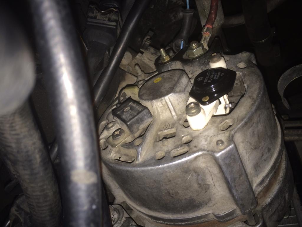

          Thanks guys, but what are the red and blue connections to the alt? Are they grounds?

            Red wire goes to the starter and the battery
            Blue goes to ignition
            I am probably missing a few things but I think that the main stuff

                  The Blue is D+ and is your number 12 pin in your C101 connector, the red one is B+ and it goes to the starter.

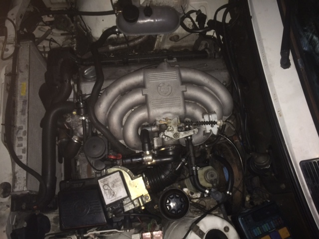

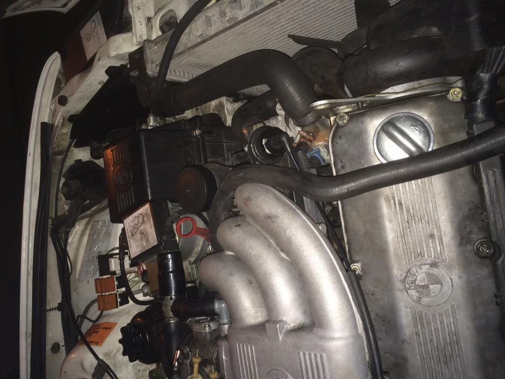

                          As far as your engine, your pictures do show an "I" intake manifold and the proper looking components. To determine which Motronic version you have, you'll have to look at the label on the ECU. It resides under a plastic cover over the glove box. Two screws and two plastic clips hold that cover on. Report back on the number and color of the label.
                          Your cooling system is a hybrid! The coolant overflow tank is for the early model cars(which yours is), but the radiator is from a later model. I'd have to see a picture of the water pump and front of the engine to decide if the rest is correct for an early or late model car. The later models use a coolant overflow tank on the driver's side of the engine and a "spider" hose. It looks like someone just tried to cheap out and attach the hose across the engine to the earlier model overflow tank. Is there any issue with engine overheating and does the interior heater work correctly? It might be perfectly fine but it sure looks odd.
