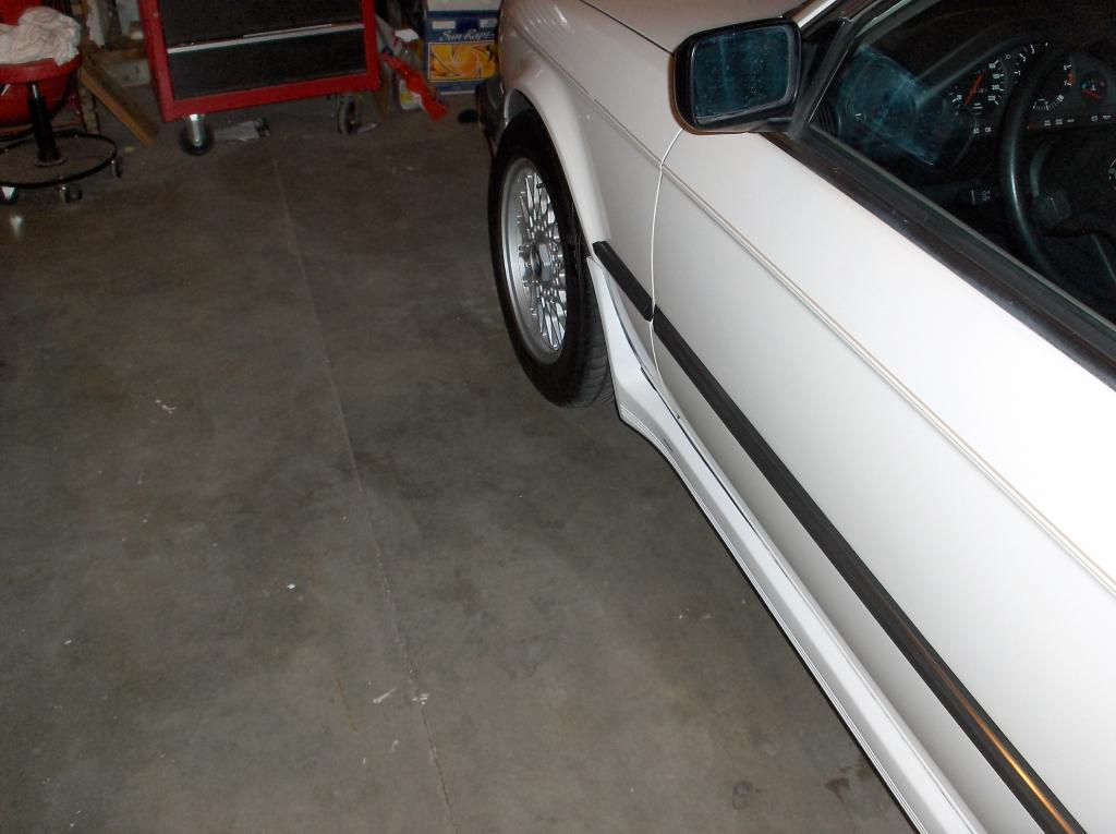

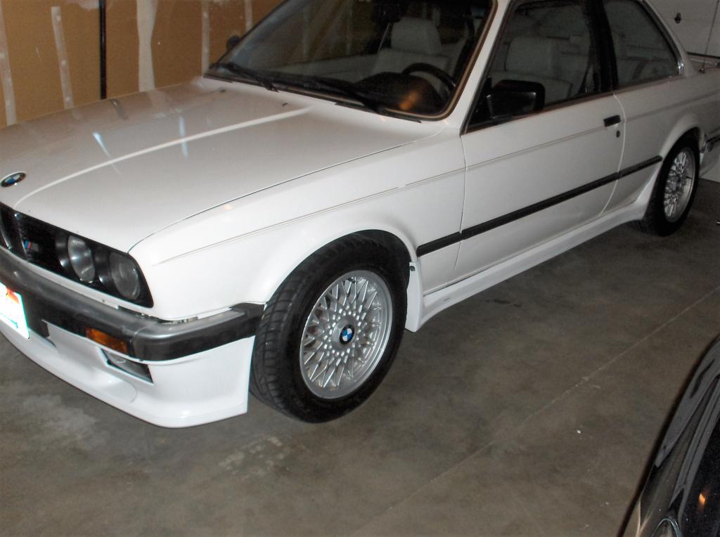

              side skirts
              Well, I confirmed, at least on my car, the back of the skirt goes on first and then the front and then the middle part. Guess the front is more flexible and will 'bend' around the wheel well better than the back. Here are a couple of pictures. Now to take the rear valance off again and fix the brackets:)

                #187
                What did you use to mount it on the fender wells ?

                  #188
                  Sent from my iPad using Tapatalk
                  used the same screws that are used to mount the clips down at the bottom. They are about 1/2" long.

                    #189
                    Do we have an MTech 1 Thread?
                    Oh Ok-So what is the blk spot I see in the pic. A grommet or a cover ?
                    I forgot to send you pic of the clip they use on the factory set up. They use rivets to attach it to the wheel well.

                        #191
                        When I drilled the hole, a chip of paint came off, so I have to fix that. That is a 8mm hex screw that you are looking at.
