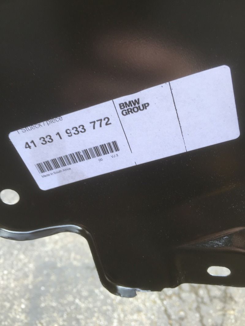

        Originally posted by Chachi
        I have a brand new 772 from the dealer. My shop foreman ordered it 5 years ago when he owned my car and it happened to come in just before i quit!
        Should i use, or hack my US valence and sell this sheet of OE gold?
        Originally posted by bradnic
        That valance doesn't look right. The part number is for a eurovalance, but the open upper ends aren't supposed to be there
        Look more like a 771 DB valance.
        the 227 valance is the plastic bumper version. there's an 84-85 2 piece valance as well, came on the first euros and early grey market cars like the one kronus has. they also use different plastic lips / spoilers than the one piece valances. MT1 works with both eras, but as mentioned the 227 plastic bumper valance needs to be cut to work with an MT1 front.
        this is the 41331961227 plastic bumper valance. used worldwide. there's also a version outside of US without the oil cooler ducts. the fog/brake duct holes are low which makes this fairly simple to modify for an MT1. If you do that you of course need to replace the metal valance if you ever remove the MT1 setup. not a big deal to source though since they're used on all plastic bumper E30s.
        all of the pics below are 1 piece 'diving board era' valances.
        here's a DB valance with eurobumpers - haven't painted my 772 yet. If you want to run euro bumpers with a DB valance, there's metal right where you don't want it, and no metal where you do :-)
        here's a 41331933771 diving board valance - same one in your 2nd pic above
        here's a 770 eurovalance (no oil cooler / ac ducts)
        770 valance mounted on e30rapidic's vert (he has an alpina spoiler now - I assume he cut the vent holes in to his 770 part).
        and here's a 772 eurovalance
        and Southernboy's alpina C2 B7 with a 772
        Look at what just happened to me - same thing that happened to chachi. the top valance is a repro 772. the bottom one was just received from BMW. RIGHT PART NUMBER FOR A EURO AC VALANCE, WRONG PART DELIVERED!
        BEWARE ordering euro valances from BMW.
        mislabled 772 valance by bradn, on Flickr
        772 repro vs mislabled 772 by bradn, on Flickr

          just to prove I'm not crazy about the 772 euro valance:
          http://www.realoem.com/bmw/enUS/part...772&series=E30
          Part 41331933772 was found on the following E30 vehicles:
          3' E30, 316, Coupe, M10, MANUAL, EUR, (1051) : FRONT PANEL

          The part they shipped was a 41331933771, mislabeled as a 41331933772
          http://www.realoem.com/bmw/enUS/part...771&series=E30
          Part 41331933771 was found on the following E30 vehicles:

                        Damn- they won't acknowledge their mistake. Probably cost them more than the part to resend you a new one and take that one back. And by the way She is looking sharp.
                              I just got some expensive goodies yesterday
