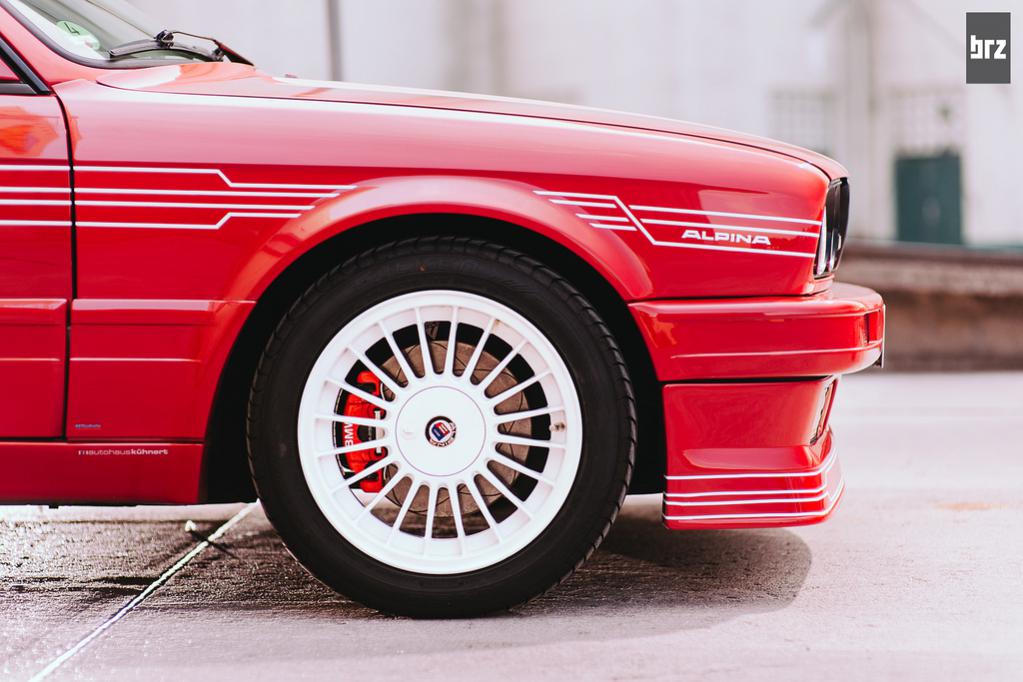

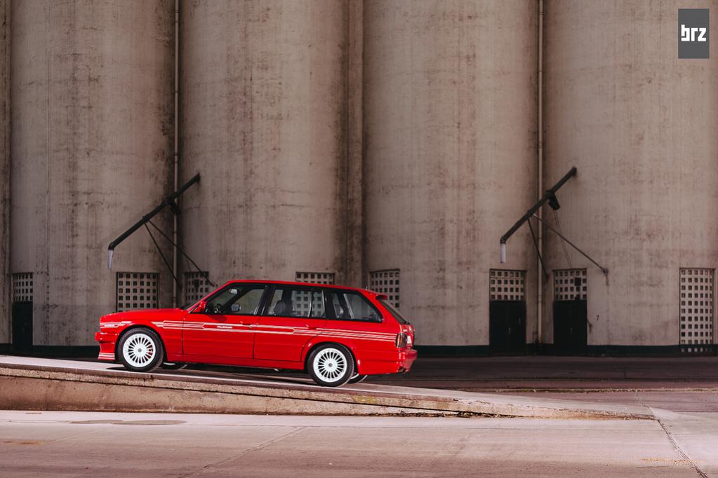

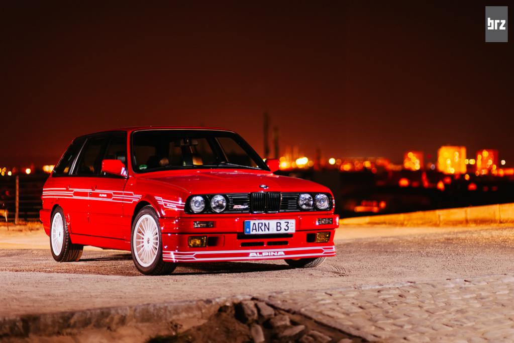

    Sorry if repost! Pretty sweet car.
    B3 2.7 Alpina Touring

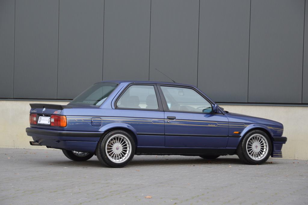

    Although I'm pretty partial to a dark blue coupe myself.....

    i loves me some alpina blue. i wonder if the wagon is a factory built car or a tribute?
    Gigitty Gigitty!!!!
    • LateFan
      • May 2013
      • 4402

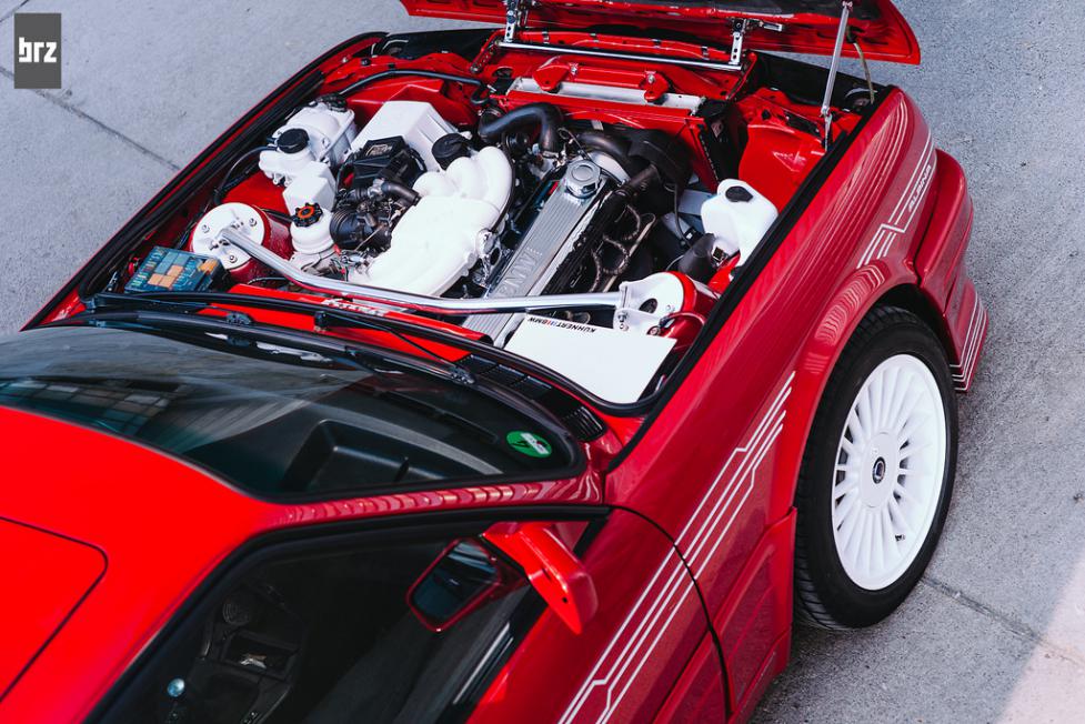

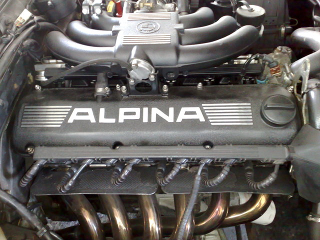

      Dunno - I bet others here can spot that. If real, though, where did the Alpina valve cover go?
      Well we always knew they did – we count approximately ten on the Alpina Register (though who knows how many of them are still on the road) – but this is our first time getting a good lo…
      Didn't find it on the Alpina Register.

        Who paints their fan shroud?...
        • LateFan
          • May 2013
          • 4402
          ^^^ especially if it's an original car.

            It is a nice car. I don't see a Alpina vin tag. It looks like a original BMW vin tag. Alpina offered deco pin stripes only gold and silver.
              ....or anything under the hood white??
              • djjerme
                • 5082
                There's still a few cars here and there that aren't on the registry.. He tries to keep it up to date, but it's only one dude, and he has all models/builds to keep track of (which with the recent changes to them being produced on the BMW assembly line and pretty much becoming mass produced models now, it's a lot..)
                That being said, to find out it authenticity, you'd need to see a few things:
                -The Alpina VIN that Raul mentioned.
                -The correctly numbered plaque
                -If a Bucholoe built car, the stamping in the shock tower (Synter cars didn't have this.)
                -Also if it's a Bucholoe car, the crossed out BMW cowl VIN
                -The 4 digit stamping on the head
                -The stamping on the Engine block (Alpina engine series + car number)
                And even these days, people won't accept that as 100%. unless you have the build sheet. Either the original, or a reprint from Bucholoe.
                I've seen a lot of crazy stuff done to Alpina's, so even with all the painting and what not, doesn't rule it out as legit.

                    I say tribute.. That looks like 5 lug brakes

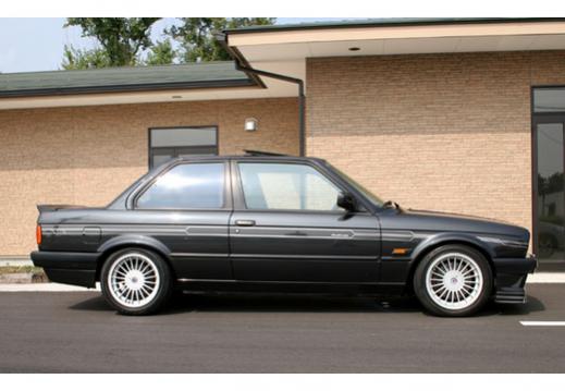

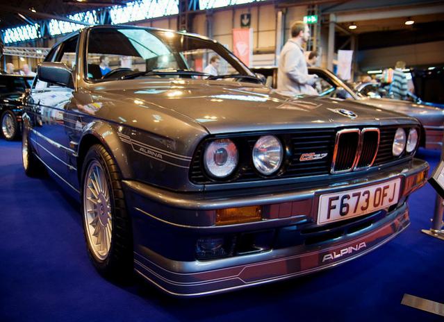

                      They're such good-looking cars.....
Name:	C2 2.7 grey.jpg
