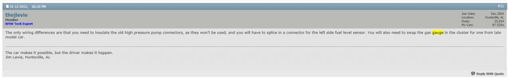

                  Popeye, My Friend, I have a proposition for you...
                  I'll gladly give you TWO early model fuel gauges tomorrow for one late model fuel gauge today. ;D
                  Look what I just found on the web from 2012 by jlevie:

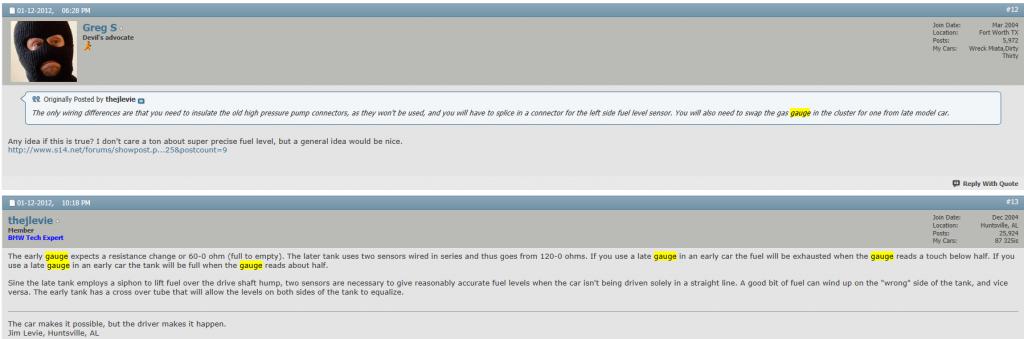

                    Dude...

                            Oh, you beat me to it- you have 2 early gauges. And a late car. Early gauge- 60 to zero. Late gauge- 120 to zero via 2 60 ohm senders in parallel.
                            Because sucking jet valve.
                            You could hook gauge one up to each sender and have a meter for each half of the tank.
                            Jim helped me with this one years back.
