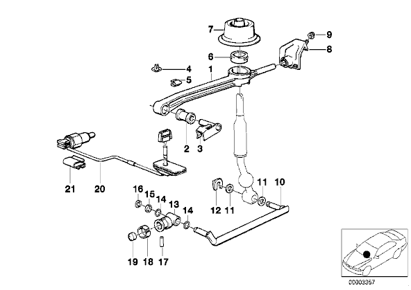

        ok, here she is :). btw im not sure about the timing belt, its not going to be on the road just quite yet so ill start with that. I still need to fix the shifter, its extremly slopy. the Steering is not so great either. Theres no "spin back" after you turn the wheel. All in due time.
        Get an alignment, and get the following parts for your shifter:
        1X #02 BEARING SLEEVE, ROUND 25 11 1 220 832
        1X #07 RUBBER BOOT 25 11 1 220 912
        1X #08 BEARING, SHIFTER ARM 25 11 1 220 707
        3X #11 PLASTIC WASHER 25 11 1 220 439
        I would go the extra mile and also get for your gearshift connector:
        4X #14 O-RING 25 11 1 221 243
        2X #15 SPACER RING 25 11 1 220 199
