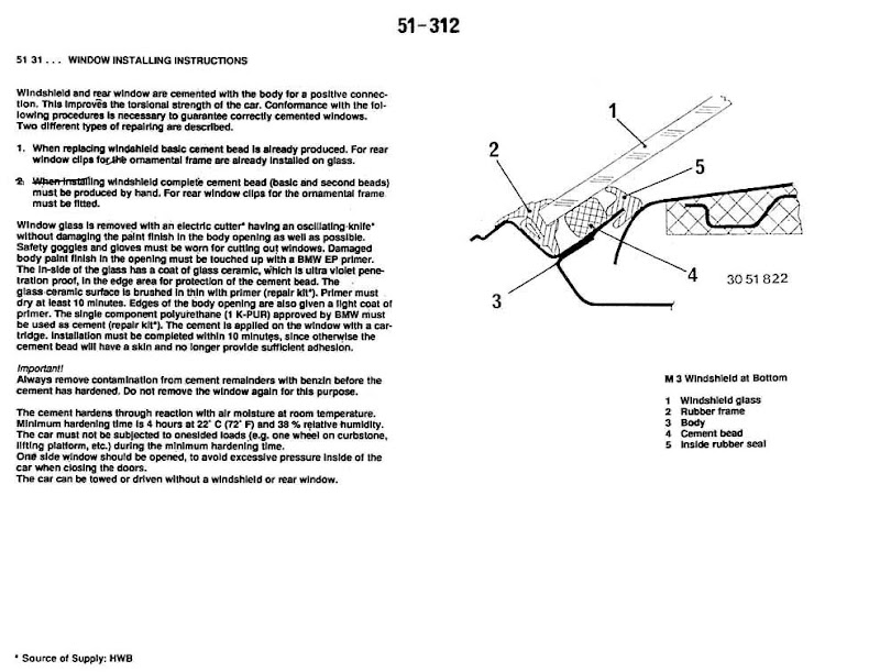

                    E30 M3 windshields, front and rear, are bonded to the body. They are a structural member of the vehicle.
                    Non-m e30's front and rear glass are all held in with a gasket and lock strip. No adhesive was used on any of them ever from the factory. Its presence on your car only shows someone previously installed it wrong.

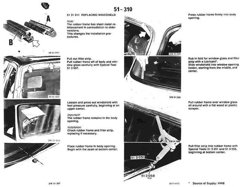

                      From the factory manual:
                      As Jordan stated, the M3 is glued in place, but it has a special adhesive they use - looks like a more complex process than squirting goo on and plopping the glass in.
                      And FWIW, the installation instructions for the regular glass make no mention of sealant of any sort.
