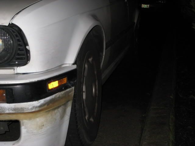

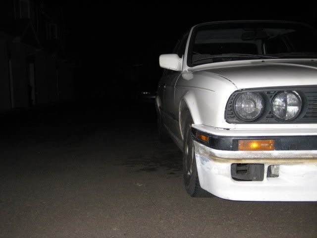

              Here are pictures of the show of camber on this car. Excuse the condition and cleanliness, but look at the camber of the front passenger wheel. Do you see what I see? I'll get a couple angles later maybe - ran out of battery. It's not as easy to see on the 14" steelies, but on my 16's or my new 17's we're talking severe tire wear? This angle doesn't show it the best.
              This was not there when I gave it to the shop.

                Looking at how the panels fit on the car, it sems like the body may have been hit or something. Driverside shot shows ill fitting fenders, grills and hood. Have you measured the distance between the shock tower?

                  The vehicle was in an accident on the driver side front corner, but it's the other side in question. And the grills/hood aren't really off it's just the fender is a piece of crap (have the part to replace it). Haven't measured anything myself yet but I should have answers as to all of the alignment specs by tuesday. ::crosses fingers ::

                      For your information, a bent suspension tower on one side, will automatically affect the suspension's symmetry with the other side. If the two towers are at different angles or height, then no more equal camber on both sides.
                      Before Spec can rightfully blame Boyd for messing up his e30, I'd be curious to see a report from another shop. The car's condition as shown in the pictures is not too good as it seems to be a pretty much trashed car. I suspect a lot of problems hidden underneath. The front end looks all fucked up, driver door in a different color. Major accident anyone? Rust maybe?
                      "This was not there when I gave it to the shop."
                      Well, maybe you did not notice the problem when the car was at standard height.
                      I have in mind a post from two months ago when a member gave shit to a windshield installer because the technician did not glue the windshield to the gasket and the gasket to the frame of the car like it is done with M3s... We all make mistakes in our assessments. Sometimes, wrongfully blaming a shop can have disastrous effects on its reputation... You even mentioned yourself you were "agitated"... There must be a reason why they told you to take a walk...
                      Please Spec, take decent pictures of the whole car, and in the broad daylight. Measure the strut towers too. I am sure we can find the problem.

                        Spec, I hate to say this but your car is fucked. I've been through this with my own car and several of my customers cars and the only way to fix your "camber" issue is to take the car to a quality body shop and have the frame straightened. When you car was hit it pushed the frame rail (and probably some other stuff) inboard a fair amount, affecting your camber. This wouldn't be as noticeable with the car at stock ride height but once you lower it, it amplifies everything. The camber on your right wheel is probably about were it should be with that amount of drop, it's the passenger wheel that's the problem.
                        The fender fitment is bad on the left side, yes, but if you look at the picture of the right side you can see that the front end is pretty racked. Working at a restoration shop I see a lot of this, and having sorted through it on my own car I've learned what to look for. Get your frame pulled, then get it aligned. The only thing you can blame on Boyd is the ABS light.

                                like i said, there is NOTHING any shop can do do add more camber to the car. there is no camber adj. possible on the front, or the rear of a e30.- stock suspension stuff.
                                it may not be a body shop thing either! it could just be a bent strutt tube. the smallest bend- that you wouldnt see with your eye, can equal a large degree of change in camber.
                                I am not saying it is either of your faults, and you also need to get the toe in adjusted to really see where the problem lies. if it is really far off, it can also make the camber off too.
                                lay off the guy!!! if it got hit on the drivers side, it would mean POSITIVE camber on the pass. side. you are all jumping to mighty fast conclusions-- kinda like the owner of the car at hand.
