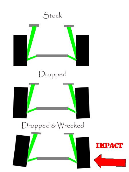

        This is how I can see it being caused, and yes it will be amplified by lowering it, so you may not have seen it until now.

          Curt, those illustrations are AMAZING.

            Its a rough depiction, but it just shows how the impact could cause the issues at hand.
            Why thank you Mr. Anderson, took me all of 3 minutes. :)
