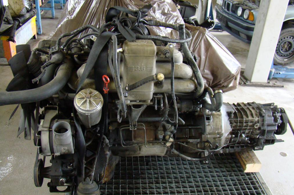

              Sure
              too easy....bolt on a 3.5....200hp to start.....yes i know not what you wanted to hear but either get in deep....go forced induction....or swap, thems the choices man.Click image for larger version

                Originally posted by ghonarea318i
                too easy....bolt on a 3.5....200hp to start.....yes i know not what you wanted to hear but either get in deep....go forced induction....or swap, thems the choices man.[ATTACH]12499[/ATTACH]
                Makes the car balance oh so nicely too...
