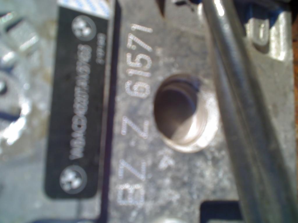

        pics
        [ATTACH]14748[/ATTACH]
        [ATTACH]14749[/ATTACH]

            • george graves
              • 20003
              Look for a VIN number on the block and run a carfax is what I would do. Otherwise stampings on the head/block might shed some light on what it is.

                • TDE30
                  • 7042
                  There were E36 Compact's in Europe with the M50, they were referred to as the 323ti (produced from 1/97 to 8/00.) However, the pictured motor looks very much like an M52 (judging by the intake manifold.)

                  • Rigmaster
                    • 3464
                    ^ what he said.
                    You might be lucky and get the info off of the white sticker that's on the back of the head or block, just above the flywheel. It's a white plastic sticker that has a bunch of info on it, and somewhere on there MAY be the engine code or the VIN code that will tell you what engine it is. Either take a good pic of that sticker + post it up or post up what's on the sticker and we'll figure it out for you.... ;)

                    • SpecM
                      • Oct 2005
                      • 4531
                      agreed, it is a single-vanos m50/52 with an 96+ mani, at least

                        I think this is the VIN wbacd4320tav37453

                            • Kilomph
                              • Oct 2004
                              • 599
                              www.realoem.com
                              You have an M52B28 I-6.
