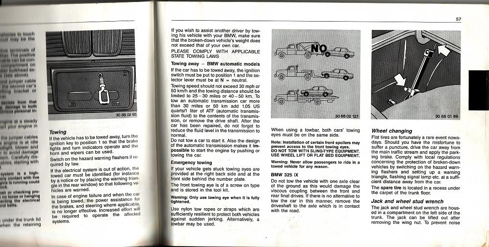

                      odd, according to the manual, you can tow the car with the front wheels off the ground with a few other considerations...

                            See it says only up to 30mph and to add a qt of atf!!!
                            Tell me of a tow truck driver that wont go over 30mph ha
