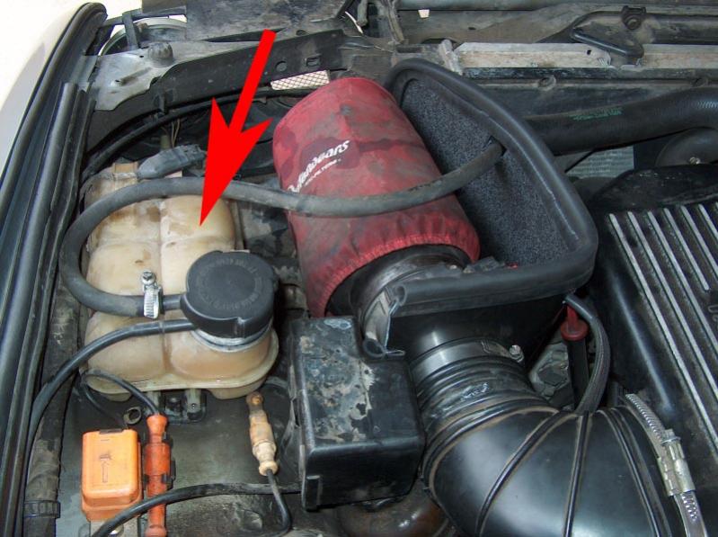

      with a proper CAI you can get colder air than the OEM setup. I'm looking into fitting a bigger air box on an e30 as we speak. possible one that holds a cone filter in it.

            #35
            Originally posted by SpecRaceM5
            See that plastic thing the arrow is pointing to. Hot coolant lives right next to your filter. The heat shielding in combination with the coolant tank is hot boxing your air filter.
            Another good place to pull air from if you are convinced on the filter on a stick upgrade, is cowl induction. You get a nice fresh air charge on the cowling where your wiper motor sits. Putting the intake there with proper heat shielding will get you a good fresh cool air on your intake.
            fixed?
                Was your OEM setup missing the plastic tube that directs cold air from beside the driver side highbeam directly into the OEM airbox? Can't get much colder than that...

                  #38
                  yes it had everything, its the fact there isn't enough air getting to it. if you notice as soon as you put the grill on, it block all the air that would be entering from the front. The OEM setup just catches what ever air goes by it, ive done the I.A.T testing, the temps on the OEM setup dont start really dropping until your traveling at 50-60mph.yes the airbox never really gets super hot but it still heats up.
