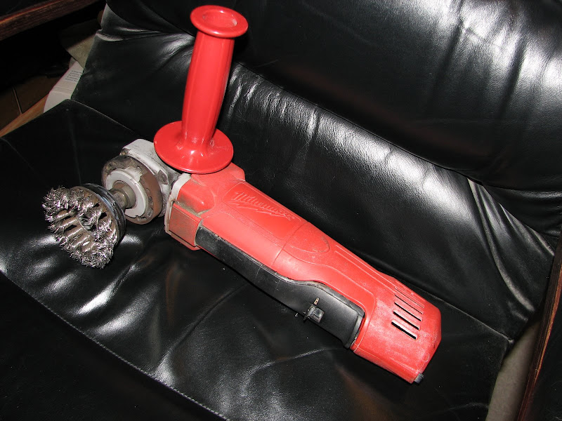

                Believe it or not but this works excellent for removing the rubber texture while keeping the factory epoxy primer intact. Just use at a reasonably low RPM.
                Only use this if you're concerned about preserving the epoxy primer because it takes about 45min of work to strip the valance. If you're just taking it down to bare steel then there are faster methods

                  do you have to be careful not to eat through the primer with that brush? or is it somewhat 'imune' to it?
                  keeping the factory primer is always a big +
                  90 E30 325i
                  • td325ic
                    • Feb 2006
                    • 786

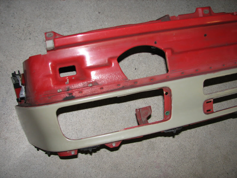

                    Well I've stripped two valances with my angle grinder and that wire brush attachment. As long as I keep a light touch and don't be careless then it is fairly easy to keep the factory primer intact. The factory primer is pretty tough. Of course, on edges and corners you're going to burn through to bare metal a little.
                    I'd keep the angle grinder under 1200RPM and just start off with a light touch until you get the feel for it. My wire brush attachment is pretty worn out so that may be what makes it easier for me.
                    Here's the first valance I stripped a couple months ago, all done with the angle grinder and just denatured alcohol to clean up any remaining residue.
