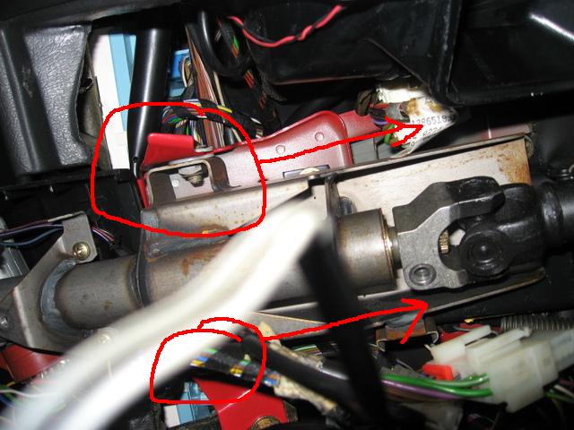

                          Any help? I wanted to remove the column and go to the yard and grab another one and swap it. Bentley show's nothing.
                          I got one nut and bolt out of the column (you can see it missing in pic 3)
                          The nut in pic 2 (next to the pedals) I couldn't take out. What way does it go?

                              1) loosen the silver/gold [Cadmium plated] bolt in this pic
                              2) Remove the bolt from the u joint, which you have done. Wedge a screw driver into the slot on the ujoint, then push the joint off the spline, which would make you push it to the front of the car. Large screwdriver/prybar works.
                              3) Should be a bolt under, or near the red circle. The green circle is where the column 'slips' into the chassis. PUSH THE SHAFT FORWARD [sound familiar????]
                              NOTE: The bolts that hold the column in may be infront of the green circles, towards the back of the car.
                              4)EAT MY ASS!
