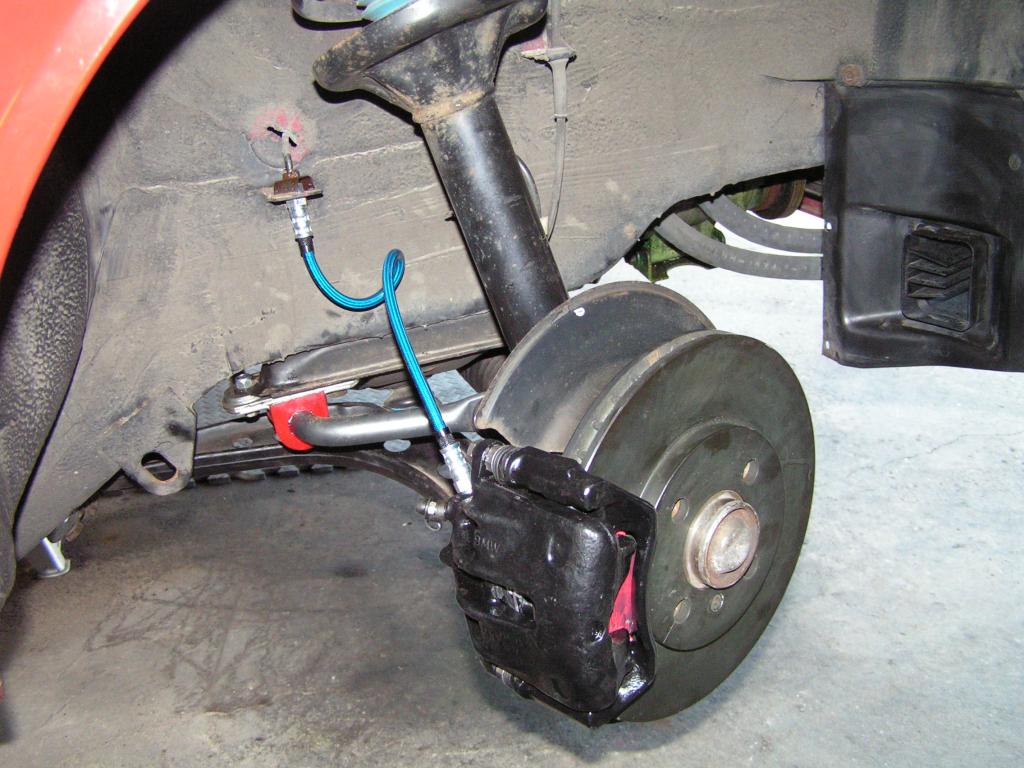

      Bought my blue Evo lines from Bimmerworld for $119 before seeing UUC apparently has the same lines for $109. Are they the same Rob?
      • Rob@UUC
        • Nov 2007
        • 420
        #33
        Nope. We use end pieces that have their own protective cover and DOT marking.

          I use the UUC lines, they look great. I can't comment on any performance gains, the main thing was I just don't want to deal with replacing them again. I think the biggest improvement is simply replacing the old worn out rubber lines, so if you're on a budget simply replace them with new rubber you'd be fine.
          I don't think SS line from UUC are too expensive though so I just went with that since they look cool and you'll probably never have to replace them again. It's a good idea to hold off on replacing the 2 lines near the differential until you get in there to do all the bushings so you can just do it at the same time and save yourself some stress, because it's nearly impossible to replace those 2 lines without getting shit out of the way. Some people say they are able to squeeze in there, but I've tried and tired, I think they're stretch armstrong or something lol.
