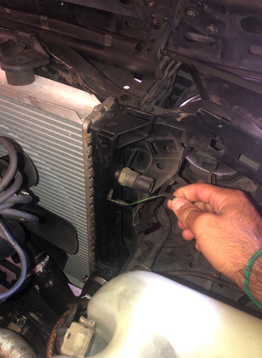

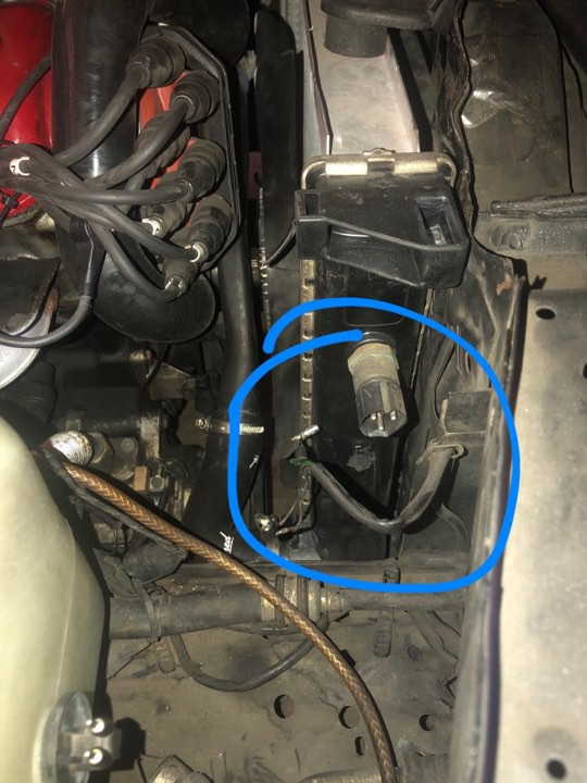

    Hello everyone, This sensor has been disconnected for a while now and I am trying to fix it. Does anyone know what this sensor do? Does it relate to the fan speed in any way?

    It's the switch for the aux fan (the electric one in front of the rad)

      Its the dual temp switch, turns on the aux fan when the temp up, and can turn the fan on low or high speed. is your car a early or late model, they changed the wiring when the late model came out and the switch

        Thanks for the info guys. Mine is a late model 1990. Should i just connect the 3 wires and see what happens?
