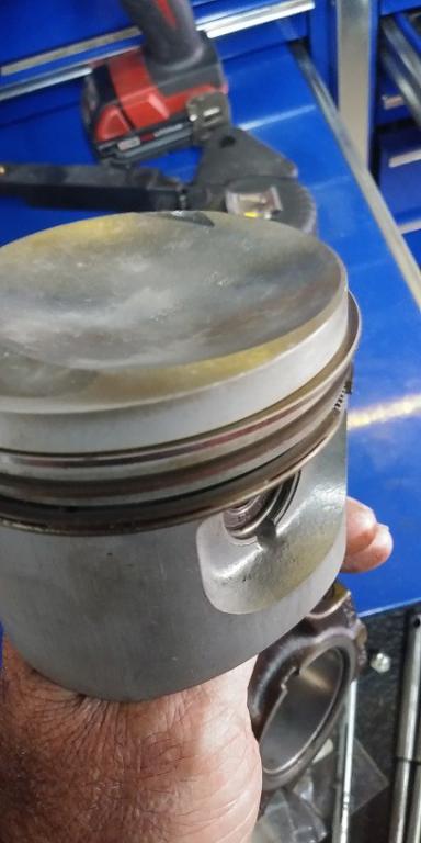

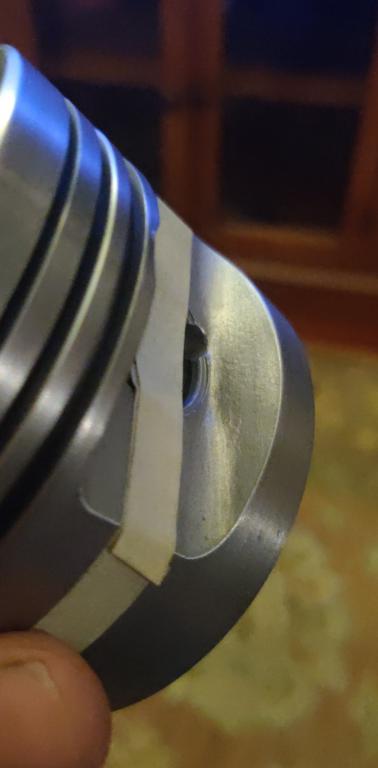

    What do you think of these pistons?
    Hey guys, I already made a post about this on the r3v FB group but the seller is now being aggressive towards me and basically saying 95% of people who commented on that thread have no idea what they're talking about.
    To me, when I recieved these pistons, it looked to me as if material was welded around the skirt of the piston near the wristpin entry. The seller claims it is simply casting marks, though from my knowledge casting leaves small divets and doesn't look like a build up of material. 2/6 pistons had similar markings in the same area. The 6 pistons I pulled from my b25 had no markings similar to it.
    I've included photos of both a piston in question and a "normal" looking piston from the bunch I purchased. Please let me know what you think. Click image for larger version

    Maybe casting marks but the machining is garbage....if that is indeed casting. Why should one want to install this ? Who is making those? Sent from my iPhone using Tapatalk

      Apparently these are OEM b25 pistons out of a very low mileage motor that were ultrasonically cleaned. Just weird that 2 our of the 6 would have those abnormal marks and that it would pass BMWs quality control.
          in that case .....who in the world would go through the trouble to weld old piston?? very very unlikely. I've seen a few oem pistons but don't recall that... Can you just ask the seller to exchange this one for you??? Maybe it's 100% ok but why not.... if it makes you sleep better

            Replacement might be difficult as I don't think he has any in similar condition, but we spoke about it. You're right though, it's super unlikely that someone welded them but it's possible they were cleaned up in such a way to make a sale. Just weird that out of 4 sets of 6 OEM pistons I've seen in the last 3 days these 2 are the only ones that made me raise my eyebrows.

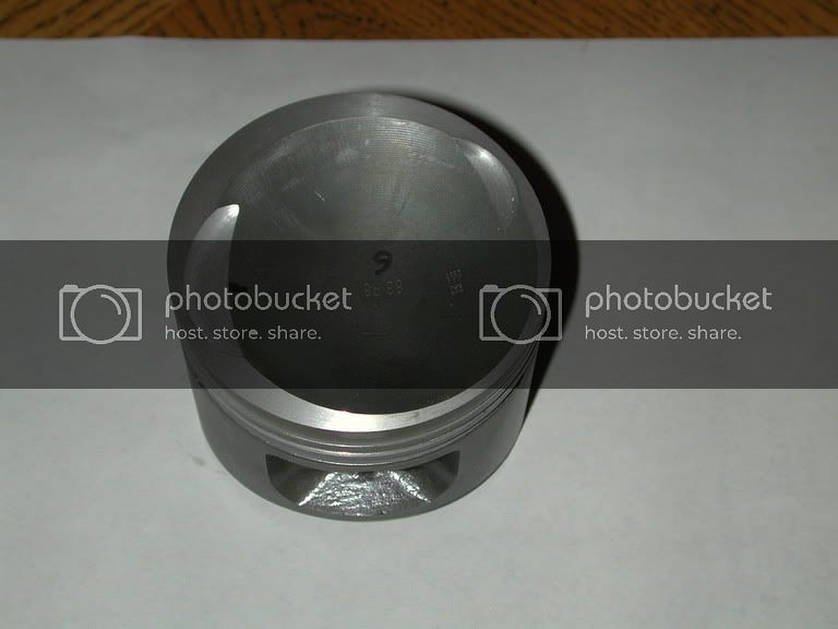

              if those would have been custom pistons, I would be very concern since not addressing that area would be a shortcut IMHO. Since those are mass produced pistons........... as long as all important surfaces are looking good, they are most likely ok. Speaking all important surfaces..... how certain are you that the ultrasonic cleaning is all these pistons have seen? Look a little too clean and shiny for just a ultrasonic from what I've seen before. Stock pistons have those tiny lines- machined marks. If they are gone on yours, some abrasive was involved for sure. Also maybe it's just your pictures but all edges are looking a little too smooth....another sign of abrasive?....possibly was used to shave some material and hide any skirt scoring??? I would be concerned about how they were "cleaned" if anything else. Honestly, I would rather buy good used pistons with ALL the carbon on them as a sure proof that no one f***d with them. This way you are able to evaluate they actual condition without any "cleaning" that can mask real problems or creates new ones (shaved edges on ring groves etc.. I would just soak them with kero/diesel fuel and a toothbrush (maybe soft brass brush for very stubborn carbon on the crown), that all they really need. Below is a couple of pictures: top picture of M20 piston that does show some casting marks in that area. (random internet pic. Bottom picture, piston came from my M20B25 (late model). That is how they looked after some kerosene/brush cleaning: no shaved edges, machine marks still visible as well as visible minimal skirt scoring( (I would be surprised to find any used P without any signs of skirt scoring) ... good piston and most importantly no issues are masked. Click image for larger version

                As zaq said, there's no critical dimensions in that area. A casting imperfection that doesn't affect operation was probably given a pass at the factory.

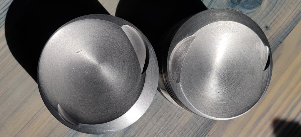

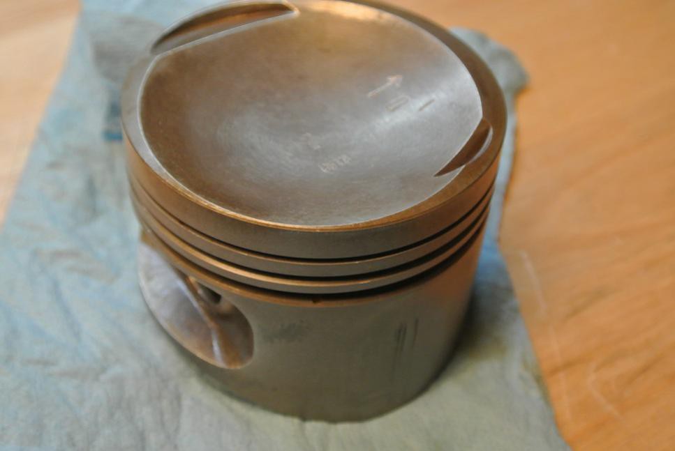

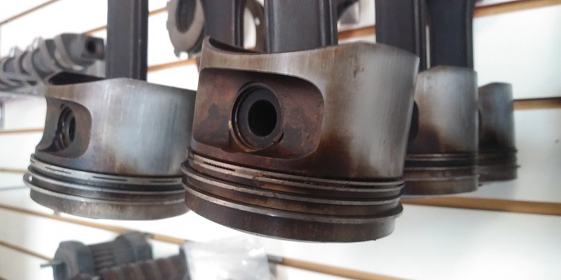

                As I said in your email, it appears someone cleaned them up beyond just an ultrasonic bath. This is a used piston I stuck in the ultrasonic cleaner with some degreaser. Note the patterns, which the PO probably was trying to wipe away from the ultrasound. They can be used straight away like this, have used this method to clean pistons many times over the years.

                And these are straight out of engines, untouched:

                  Originally posted by ForcedFirebird
                  As zaq said, there's no critical dimensions in that area. A casting imperfection that doesn't affect operation was probably given a pass at the factory. As I said in your email, it appears someone cleaned them up beyond just an ultrasonic bath. This is a used piston I stuck in the ultrasonic cleaner with some degreaser. Note the patterns, which the PO probably was trying to wipe away from the ultrasound. They can be used straight away like this, have used this method to clean pistons many times over the years. Click image for larger version
ID:	9926986 Click image for larger version
ID:	9926987 And these are straight out of engines, untouched: Click image for larger version
                  Good examples there. Pistons like cyl heads ports, just because they are shiny, doesn’t mean they are good or better than before Sent from my iPhone using Tapatalk

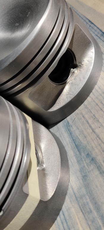

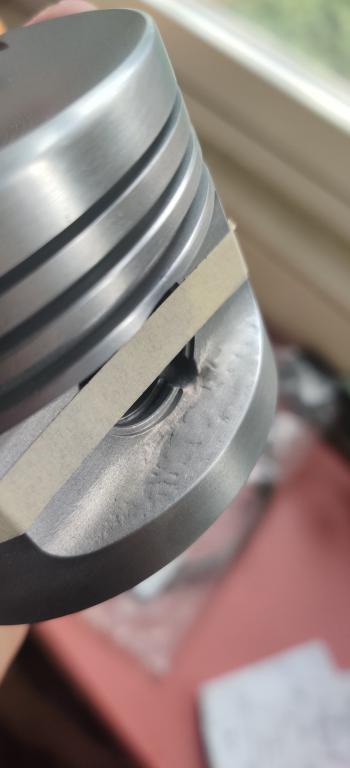

ID:	9927049 Click image for larger version
                    I'm attaching some comparison pics and other pics of the pistons to hear your opinion. He mentioned to me he also used steel wool to clean them. These pictures show very clearly the area of concern vs a normal looking skirt. The one on the right is very lumpy to the touch even and looks distorted while the others are much cleaner like the one on the left. The cleaning process also concerns me. The main reason I looked for new pistons is due to scoring on my old ones and these do have some scratches, albeit only on the surface, from the cleaning process.

                      Yeah, looks like they were chucked in a lathe and rubbed clean. They may be OK, but have someone measure them. If the PO removed any material, you would have been better off using the scored pistons. BMW's like very tight piston to wall clearances (.002mm or .0007" - less than 1/2 thou on a side). PLUS pistons are NOT round. So, if material came off in places it shouldn't you will have an odd fit when the pistons comes up to temperature. When shaving the skirts off the bottoms of the pistons, I indicate them to center, and they are about .010" out of round at room temp (indicator repeatedly moves +/-.005" every 90°).
                      The area you are concerned about isn't as critical as the outsides of them.
                        Thank you as always John for your input! I'll have my machinist measure them and let him be the judge I suppose.
