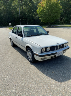

    Started out with a stock 325i with 170k miles.
    M20 that leaked from every seal imaginable + an automatic trans that only shifts gears when it feels like it.
    The interior was pretty wrecked, but the body was really straight and a good starting point for what I wanted to do.
    Wasn't too interested in taking many pictures of it stock so here's an old pic I dug up from the craigslist post.
    Click image for larger version  Name:	IMG_4067.PNG Views:	0 Size:	164.5 KB ID:	10028913

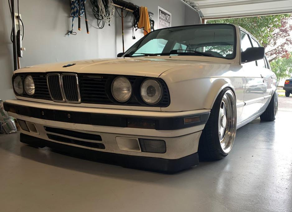

    - Air Ride P3 management, a 5gal tank, 1/4 lines and 2 444c Viair compressors. And spent a few weekends getting everything ran and dialed in how I wanted.
    Picked up a did a mild repolish + new bolts on:
    - 2piece OZ Fittapaldi 5 stars. 16x8 around ET -8 front and rear currently.
    The trunk isn't finished yet - still need to button up the false floor and tidy up some wiring but at least it looks good from the outside.

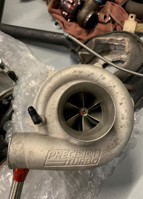

    Then started collecting parts for the motor/turbo/manual swap. Shooting for a ballpark range of 500whp/tq.

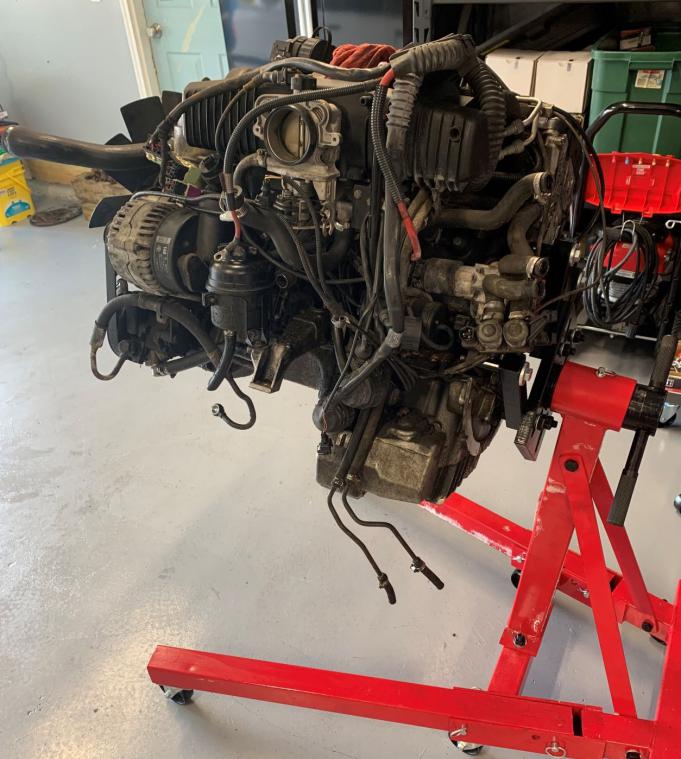

    Picked up an M52b28 local to me with 90k miles.
    Click image for larger version  Name:	AEFK8683.JPG Views:	0 Size:	80.4 KB ID:	10028916
    The plan is to run a single turbo on stock internals and stock ecu with ethanol.

    - Precision ball bearing 6262 turbo .82 A/R

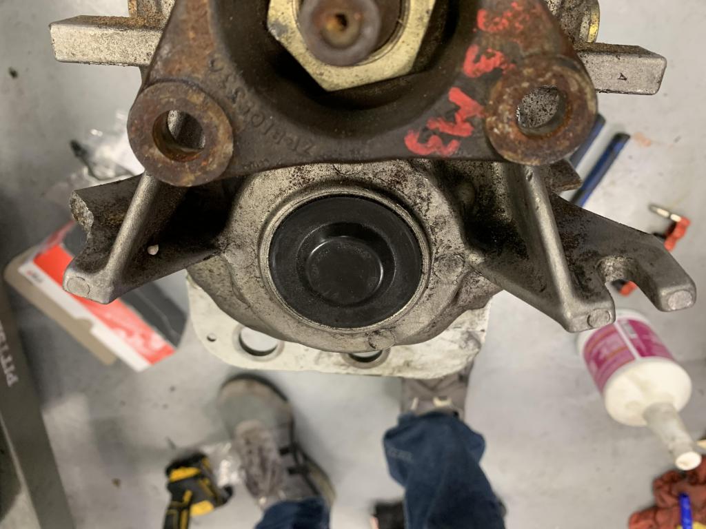

          Making slow progress. Trying to fit time in the garage with a lately busy work schedule and my first kid on the way - actually going tomorrow for the ultrasound. Still debating on what my fuel setup for e85 is going to look like. Keep going back and forth on going all out with new lines, surge tank, dual pumps, etc or just winging it with my (decent shape) stock lines + 1 intank pump and a new FPR. That's what most of my free time has been taken up with - reading and researching to hopefully learn from other's mistakes first. Anyways onto the pictures... Managed to convince my brother to come over for an extra set of hands. He's had my head sitting in his shop for over two weeks now waiting to get decked and pressure checked yet would rather help me do this. ​ 3 hours later and a shit ton of fluids to clean up but getting somewhere. Side note - anybody want a running 177k mile m20 + auto trans? I'm pretty much willing to give it away if I can't get a couple hundred bucks for it in the next week or two. Garage isn't big enough for all the stuff I have piling up. Tapped the block and JB welded for the -10 AN turbo drain. Threw on the S54 oil filter housing so I can try to fit an oil cooler on this thing and stripped the AC bracket/tensioner off. New water pump and tensioner, waiting for a new alternator and water pump pulley to come in soon. Red Loctite + safety wired the oil pump nut and threw on the M50 pickup tube. Waiting for my pan gasket to get here to get the M50 pan on. And a little sneak peak of something that just came in from Fedex today. Tramont Staria 3pc - 17x8.5 and 17x9 et21 all around ​ And a little project to clean up, some of my all time favorites - 3pc Schmidt Modernlines. Currently they're 16x9.5 and 16x10.5 but going to switch up the lips and go 16x8.5 and 9.5 most likely. No plans to do enough fender work to stuff a 10.5 in the rear​ Hopefully my next update will be with the motor fully dressed and put back together (or at least with a head and oil pan on)

            Remember that oil pump nut is reverse threaded so you should tension it the other way, one or two more holes toward the top of the sprocket in that picture.
              I like the wheel options!
              Good call, thanks man! Didn't even think about how the reverse threading would affect how the wire would hold it.
              I actually took the block tap return from your thread. Read through your build a few times and grabbed all the good ideas I could

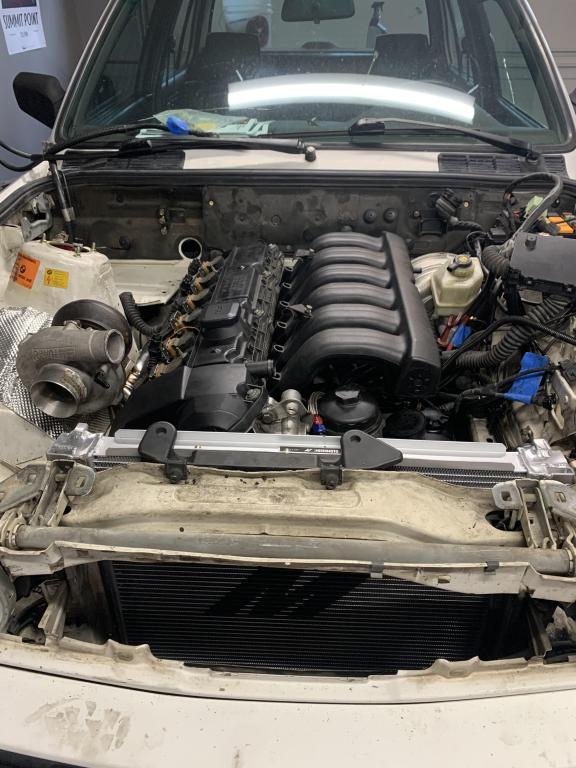

                    Planned to drop the motor + trans in at the same time but I'm impatient and didn't want to wait for the trans foot to get welded.
                    Got the turbo mounted and a test fit on the m50 manifold with the X3 booster. Had to shave down a few fins but sits smooth as butter now.
