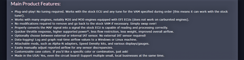

    SSSquid Tuning M20 Maf Conversion
    So the other day I finally swapped out my AFM for SSSquid Tuning's Maf Conversion Kit (MCK). I haven't driven it much but so far the throttle response is a lot better. It also seems to idle smoother. My cold start is still shit but that's another issue.

      That kit works with a stock dme?
      • It's Soda Not Pop
        • Jan 2022
        • 877
        yes it does.

                      How do they get "better throttle response" just from a different MAF? reacts faster than the OEM one i assume? or are they tricking the OEM ecu into adding more fuel on change in air mass flow? (bit like a throttle enrichment pump)

                          Better flowing and as soon as you crack the throttle there is an instant signal for air flow. Plus the SSSquid MCK has a conversion box for the signal so that the stock DME can read it.
