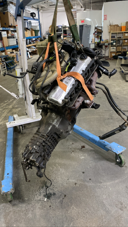

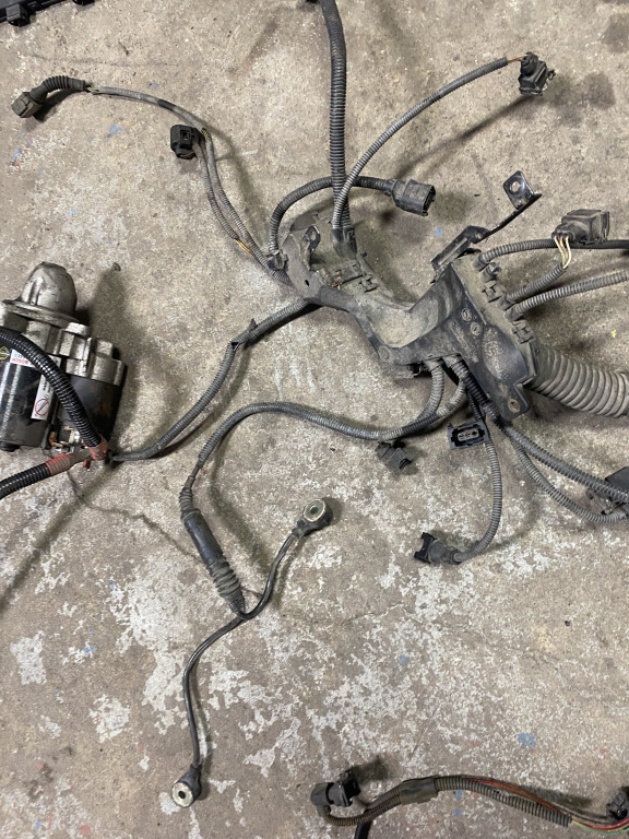

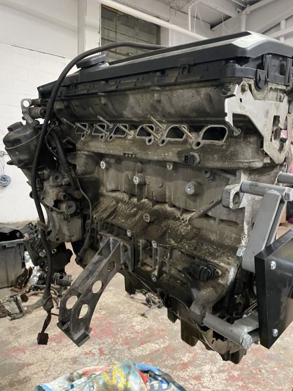

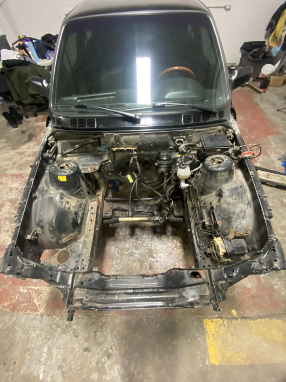

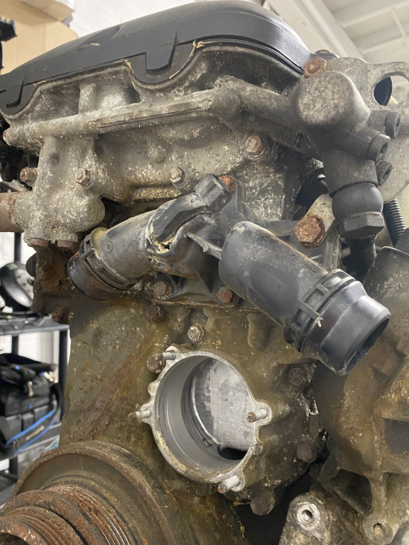

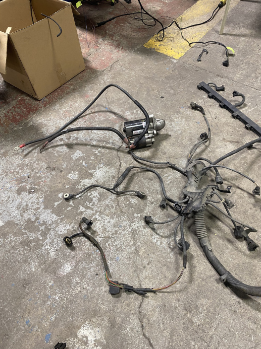

    Started taking a better look at the wiring that came with the motor
    Was told an X5 or E39 harness worked better to reach the glovebox for the ECU, so I found one local
    Need to go over every connector and wire to see what needs to be replaced

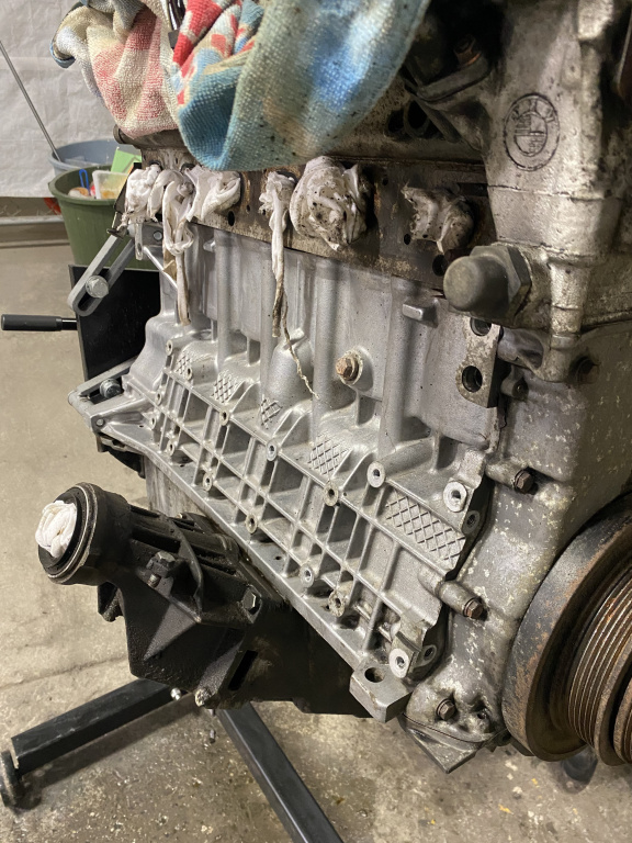

    Removing more components from the motor as I go along
    The plan is not to dismantle the internals this year
    Budget is going real fast
    One of the reasons I'm making the front removable,
    I plan on pulling the motor in a few years if it makes it there
    and redoing everything completely... maybe preparing for... Boost ?
    We shall see!

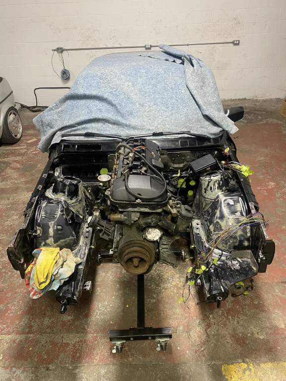

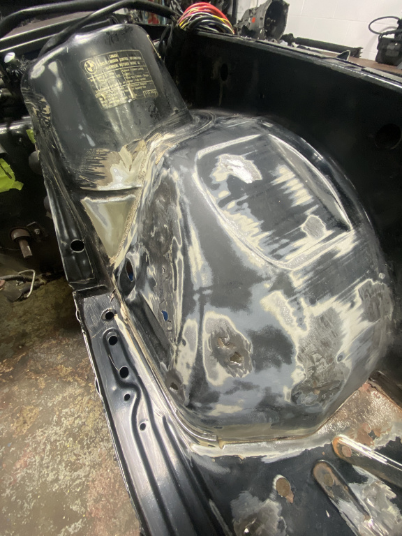

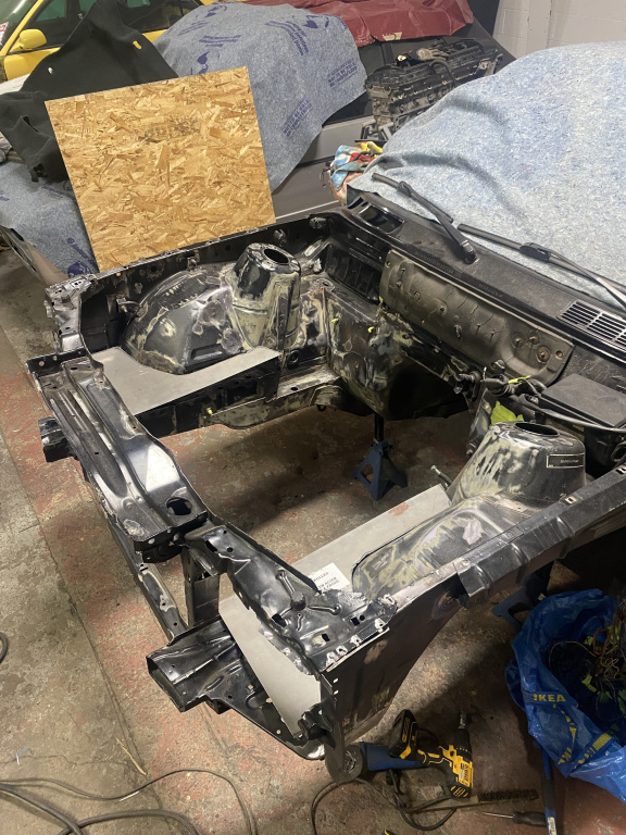

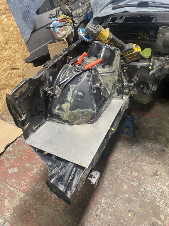

    Well at this point, youtube inspired me to go full shave, so let's go!
    keep in mind i've never done bodywork in my life, never used bondo
    gotta live and learn!! only way

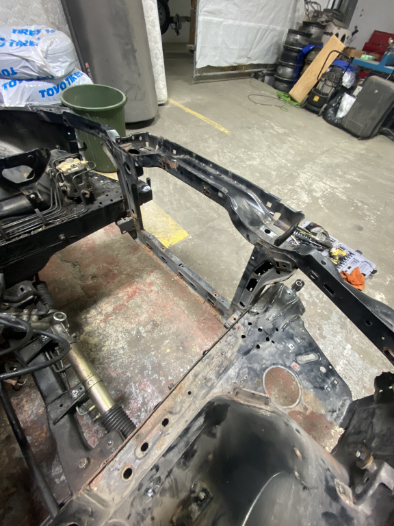

    Made both plates, and put the rad support back to get an idea what it will look like
    super excited!

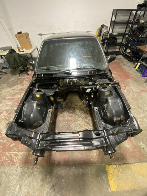

  • E30Rossi
    replied

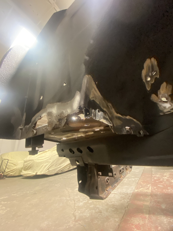

    Factory fresh, ignore that it got a little beat up, the underside is worse, from before I had my skidplate installed, but let's just forget about that

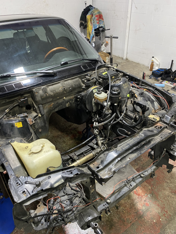

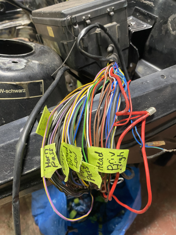

    Labelled every wire coming out of the fuse box, cut off the ABS wires and brake pad sensors but debating if I remove them from the fusebox completely
    Any advice on this would be appreciated too!
    Dreaming of the end goal!

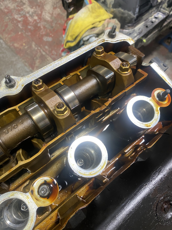

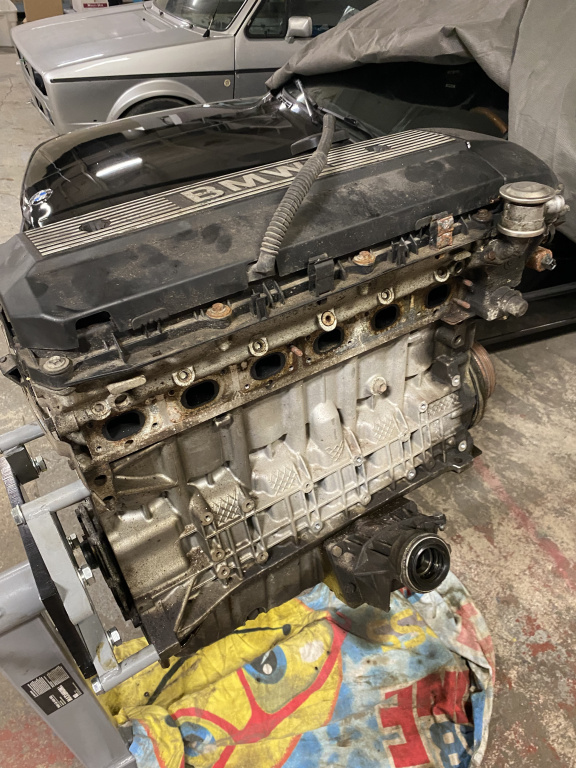

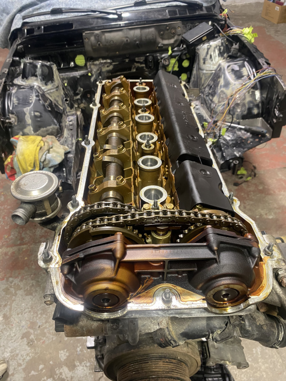

    Removed valve cover to get a first look inside the motor
    Nothing crazy scary yet!
    For the mileage this thing has, very surprised so far
    Leave a comment:

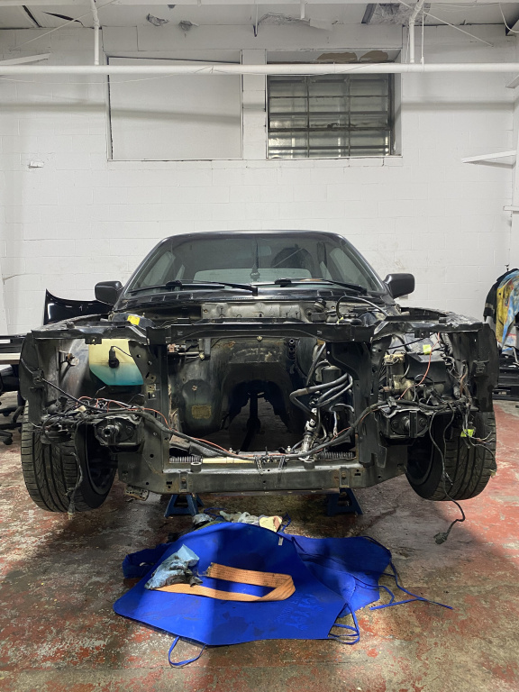

  • E30Rossi
    replied

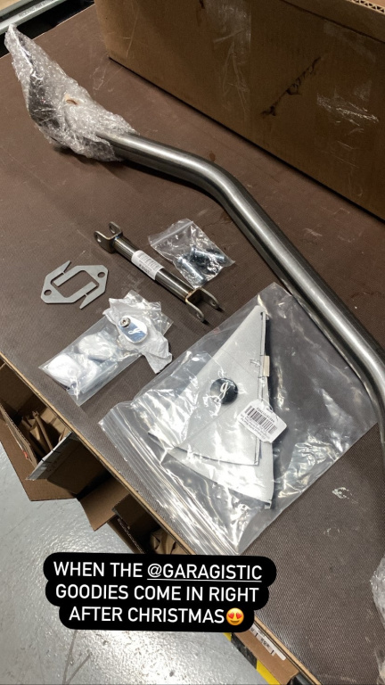

    Parts orders starting to show up! I got a little click happy on the add to cart button on several sites
    Garagistic order:
    Strut Bar - bare so I can powdercoat it
    Swaybar mount reinforcements - already have the other subframe ones from 3 years ago
    24V 10 Degree Twist DSSR - to match with the Chassis mount shifter
    Shift Boot + billet logo
    ABS Sensor Delete plugs - because they look nice
    Next up, ChaseBays
    Vanos Oil Line
    Clutch Line
    Ground Wire Kit

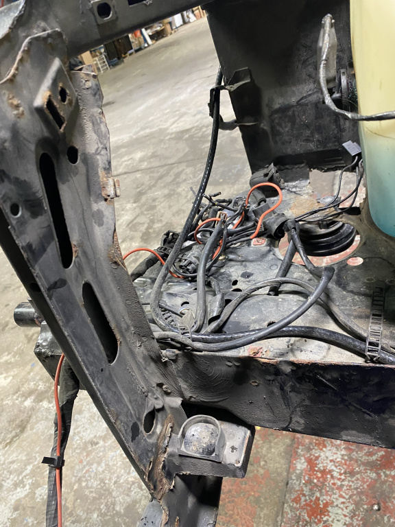

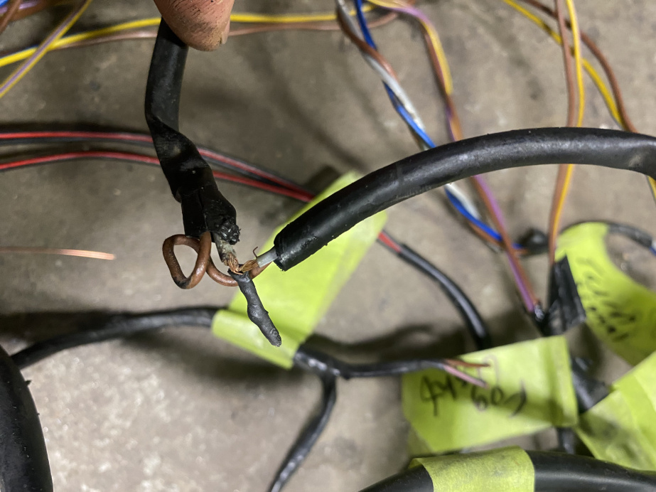

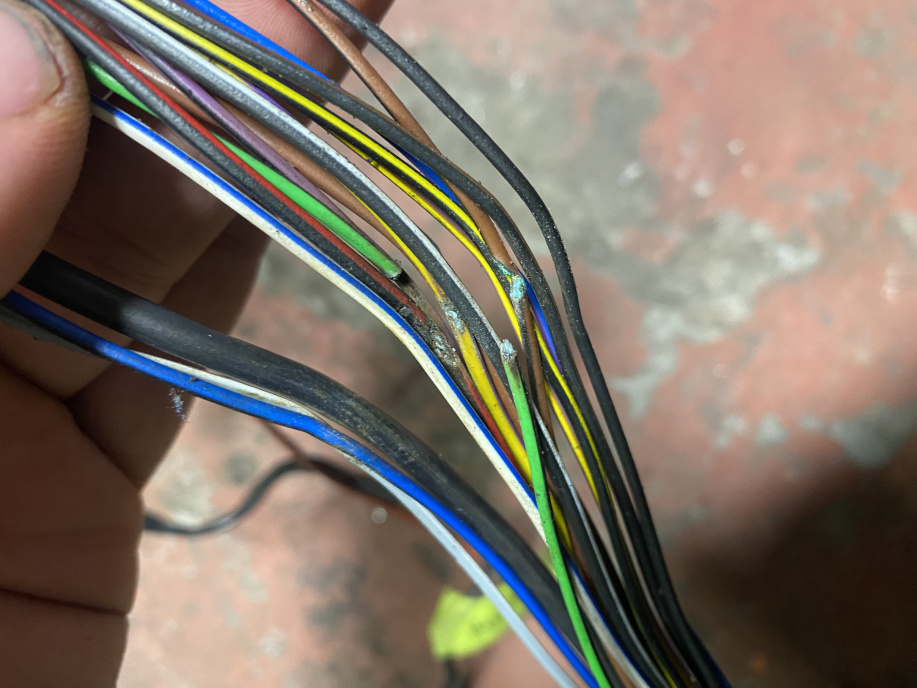

    Next up , removed all the tape from the front body harness, and revealed why I've had so many electrical issues on the car
    Sooooo happy to tear this down and repair all the wiring with a minor wire tuck, so I don't have to worry anymore
    Sketchy things

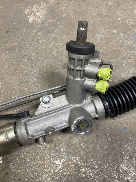

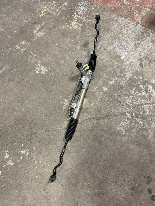

    While I was bored, Cleaned up my Z3 rack and got rid of all the oil leaking onto it for the past 3 years
    Cleans up nice, ready to go back on!
    Leave a comment:

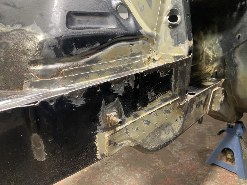

  • E30Rossi
    replied

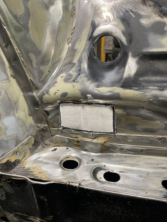

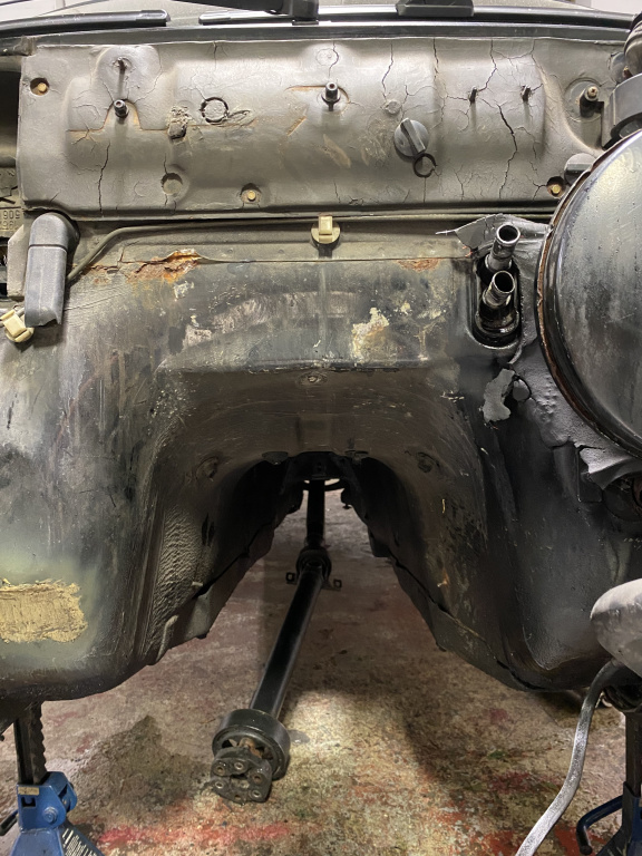

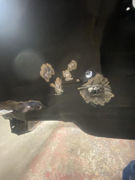

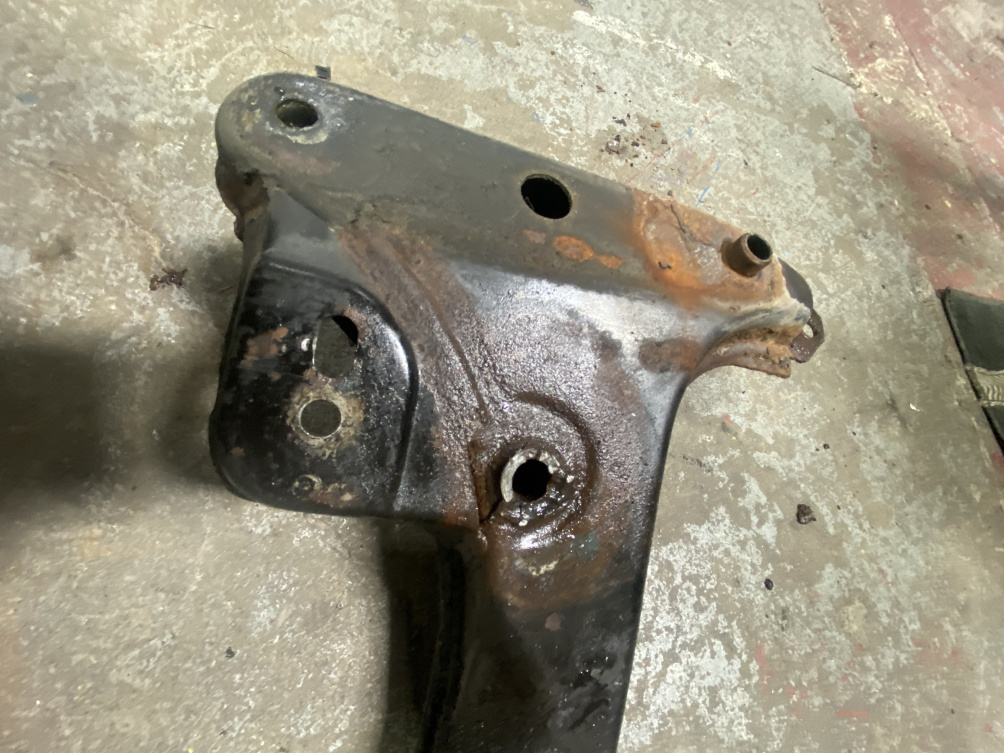

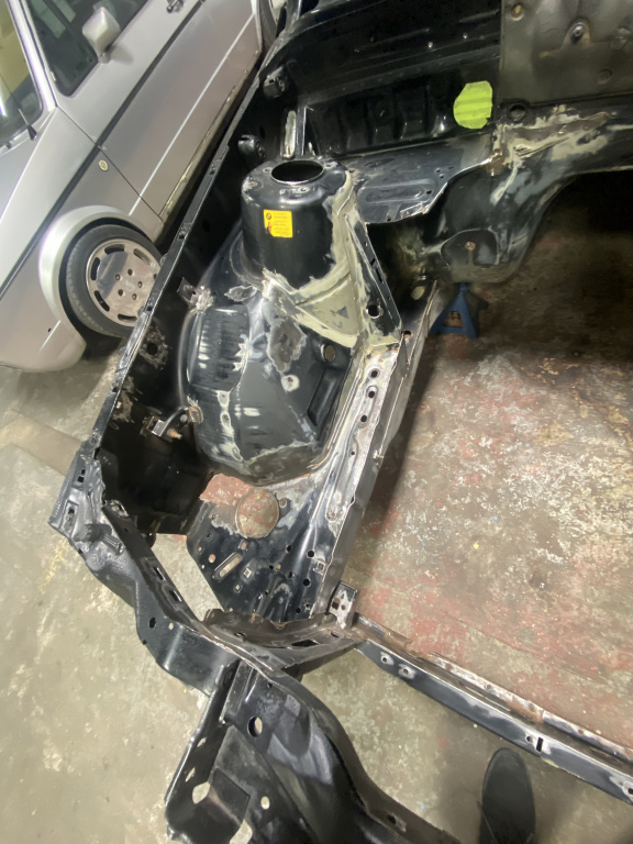

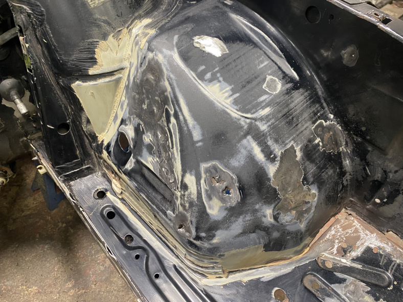

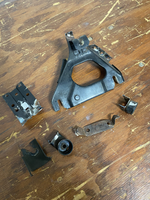

    The bracket that holds the ABS sensor wire and brake pad sensor was pretty rusty and I could pull it off by hand
    As I had already deleted the pad sensor wire, and was planning on ABS delete, cut it all out and made a template to weld a patch in

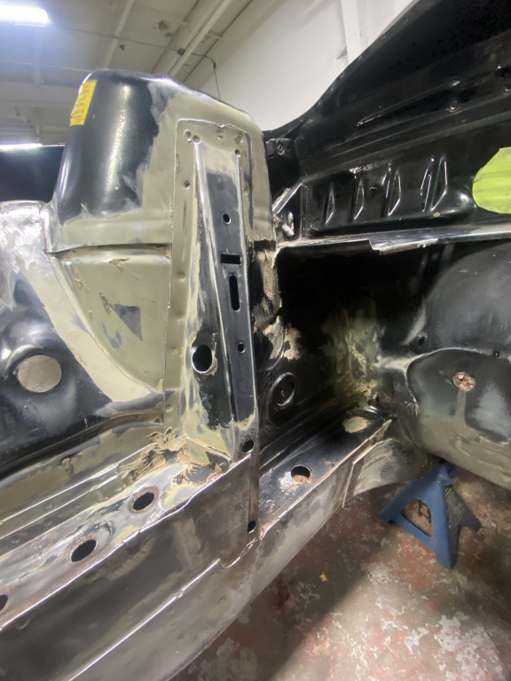

    The fun begins, which holes to leave, which to plug
    Don't need ABS sensor hole anymore, This starts getting addictive once you start

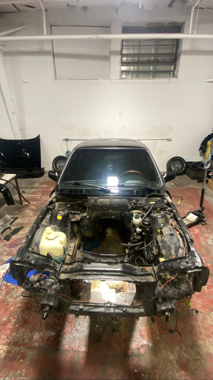

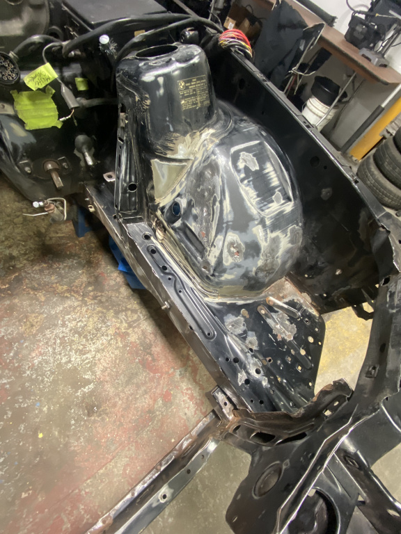

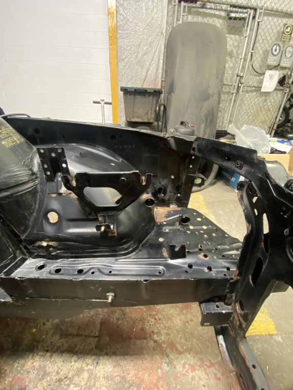

    The more youtube videos I watched of engine bay shaves, the more things got patched up or filled
    The 2022-2023 setup, can't complain at all with having access to this heated indoor space with access to so many tools
    Gotta really thank my buddy for letting me use the space at the family business to do all this! Couldn't have done it without him!

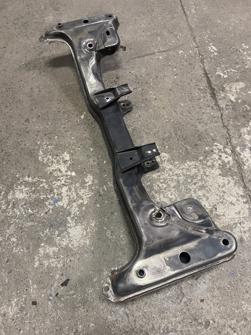

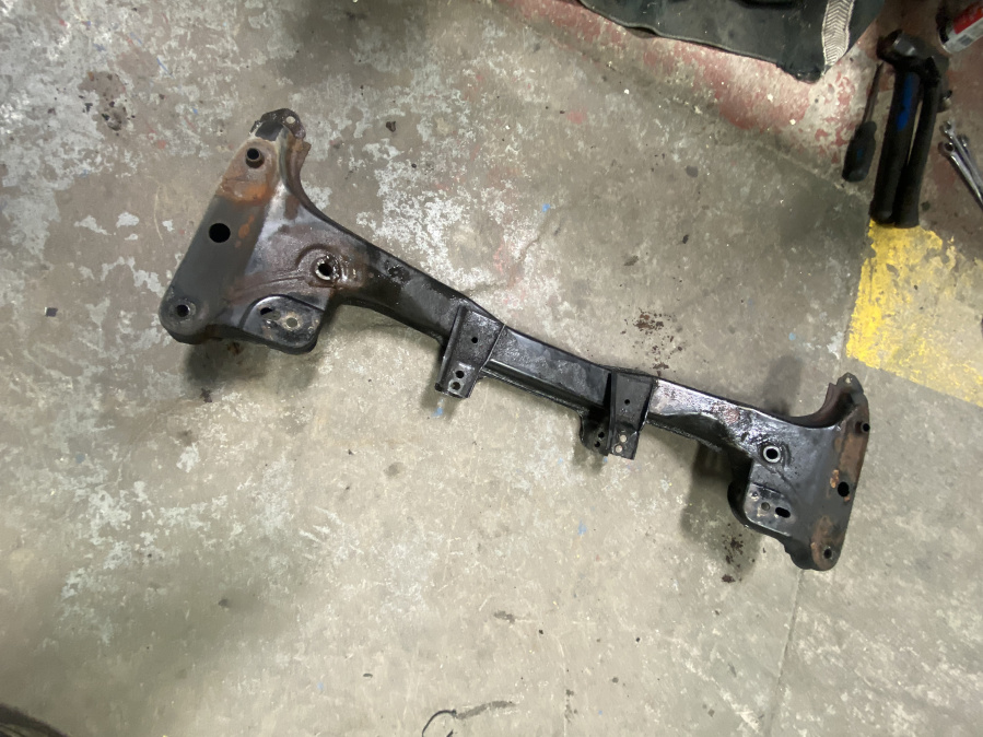

    Subframe wire brushed, waiting on reinforcements to get welded on! I will get there eventually
    For now all my time has been going on the engine bay so I can move forward with getting the motor in
    Leave a comment:

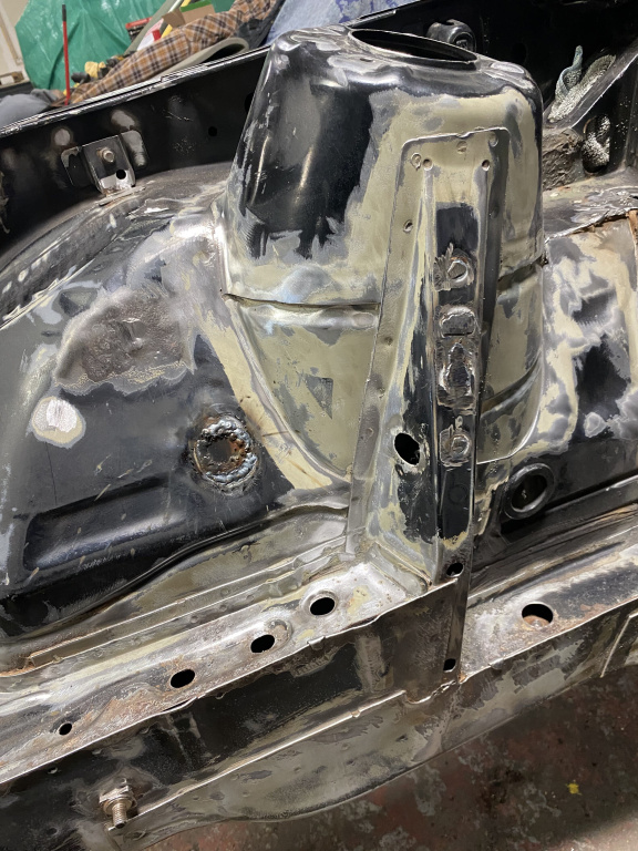

    Brushing off undercoating to reveal areas that need to be rewelded or patched up
    When I originally fixed all the rust on the car, I disregarded this front section because I planned on doing the engine bay eventually
    Now that time has come 3 years later

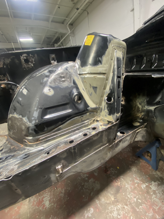

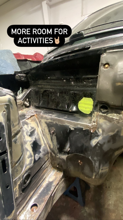

    Decided on cutting out the battery tray for more room for my swap
    Next decision was making the rad support bolt-on with rivnuts
    thought a lot about it, and it makes it so much easier to do all the bodywork, get the engine in and out, service the front of the engine
    Why not while I'm here right ?
    What's 16 extra steps

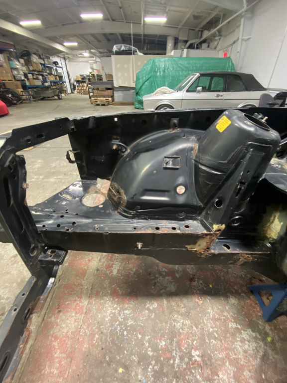

    Thankfully, most of the engine bay rust was just surface!
    A few problem areas to address but frame rails were good to go!

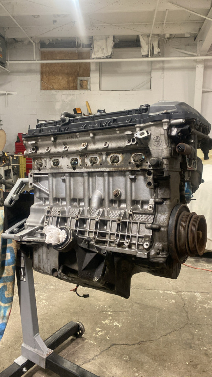

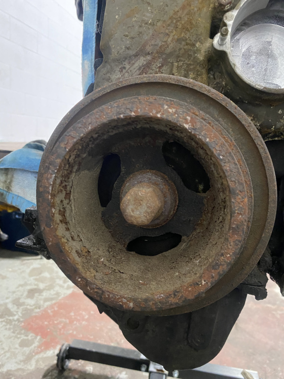

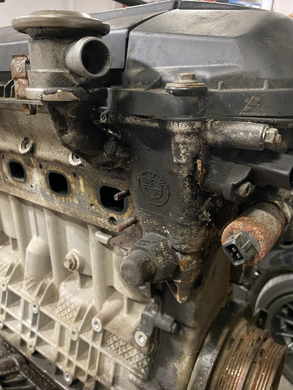

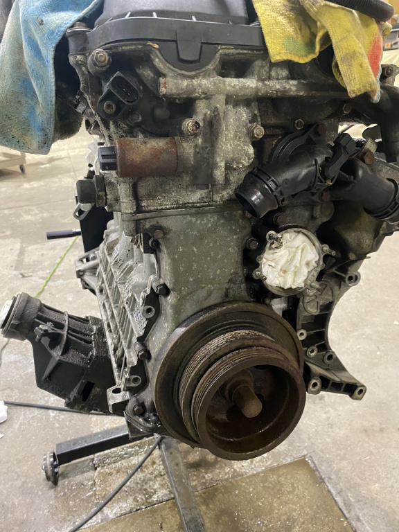

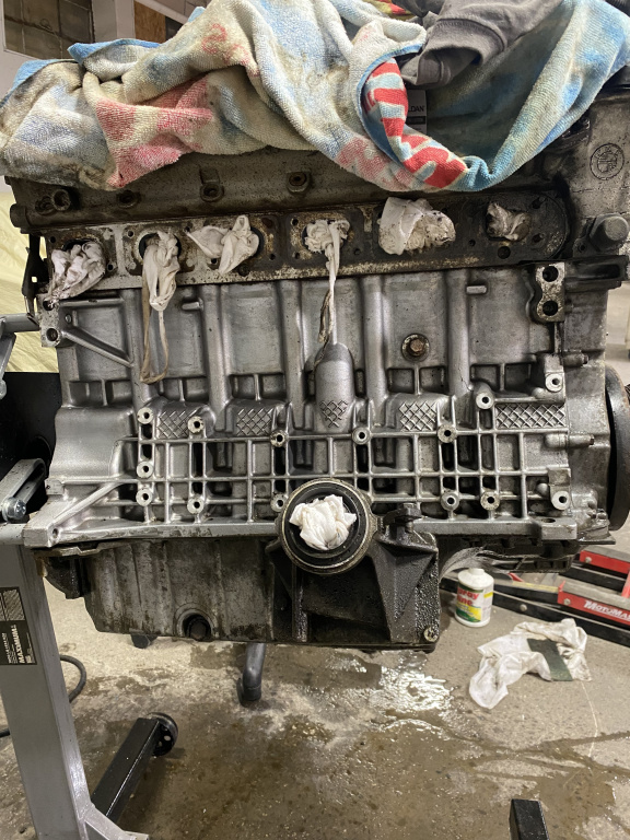

    Crank pulley has seen better days, still haven't decided what to do with this either
    I know the torque spec is 300 ft lb, and I don't have a flywheel to lock the motor in place
    But deep down I NEED to remove it and powdercoat it
    Any advice for this would be appreciated!

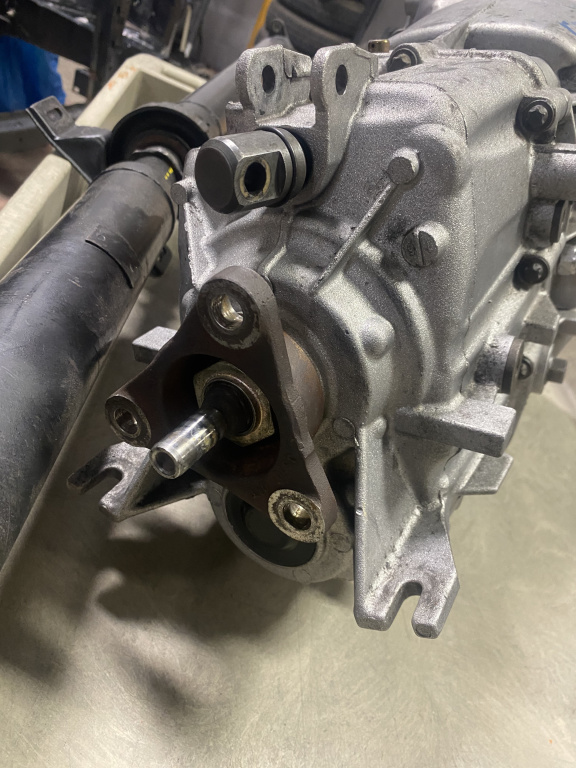

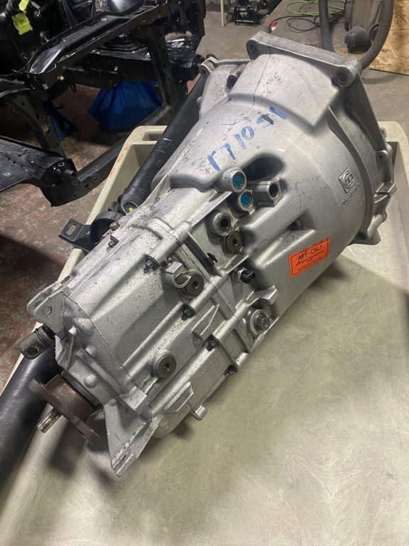

    Scored a great deal on a ZF320 from a friend
    Detent and pins were done as well as seals and selector joint!
    One more big piece to the puzzle
    Don't even need to clean it up, great condition

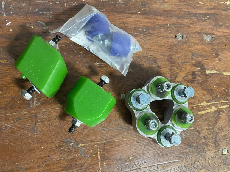

    Also got Revshift 24v motor mounts, garagistic trans mounts and Adapter Guibo to use E30 driveshaft with the ZF320 from the same friend

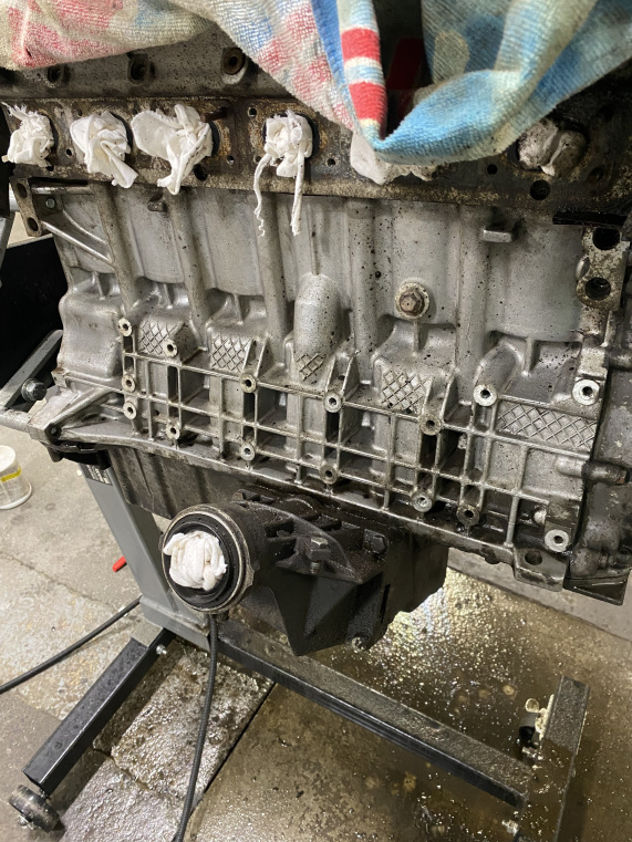

    Starting to clean up the motor, so much filth
    Oil pan is from an AWD, just leaving it in place while I clean everyting up

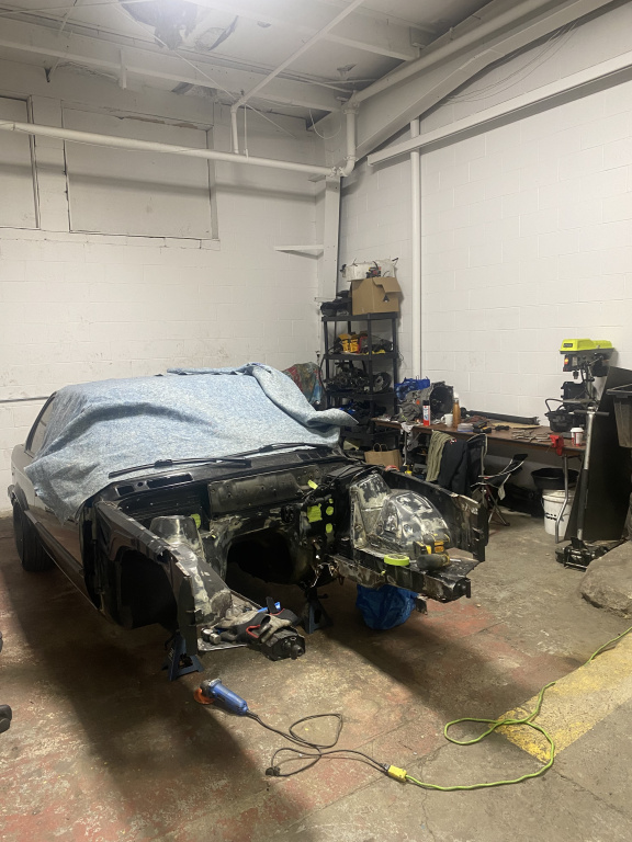

    Cabrio in the background is my buddies girlfriends car, getting an MK4 TDI swap
    Always fun to have company on builds like this , through a long winter!

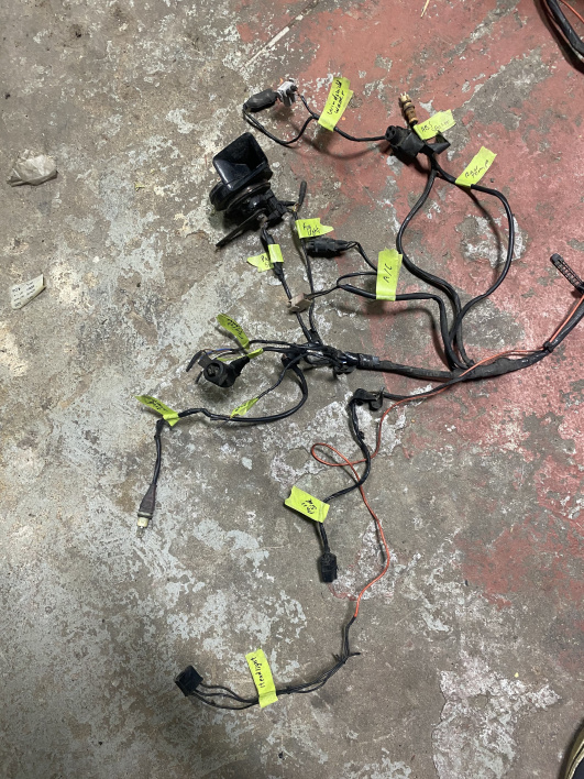

    Labelled every connector on the harness side, I wish the fusebox and wiring was easier to remove
    Definitely leaving it in the car, don't want to start messing with removing all the under dash connections

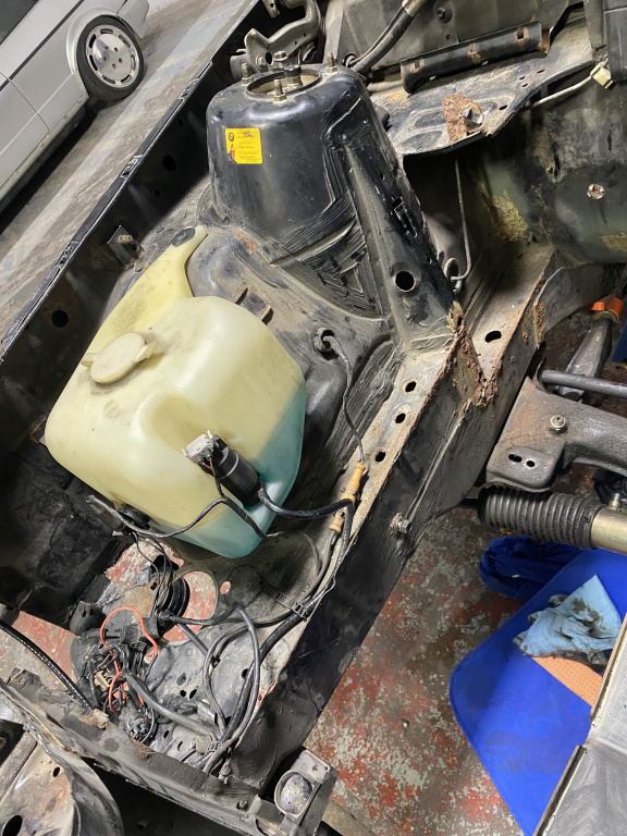

    Got a little trigger happy with the grinder, Cut off every bracket in the engine bay
    Won't be needing intake box, ABS, Washer reservoir, coilpack

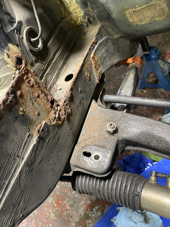

  • E30Rossi
    replied

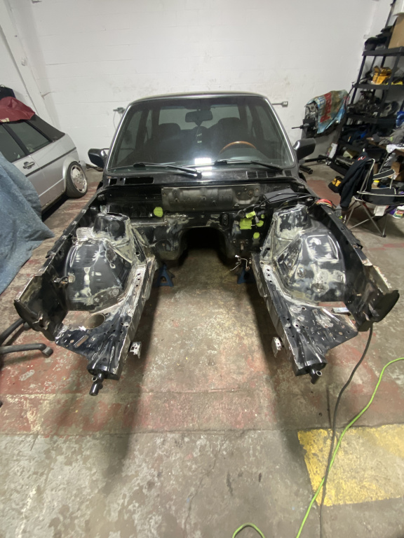

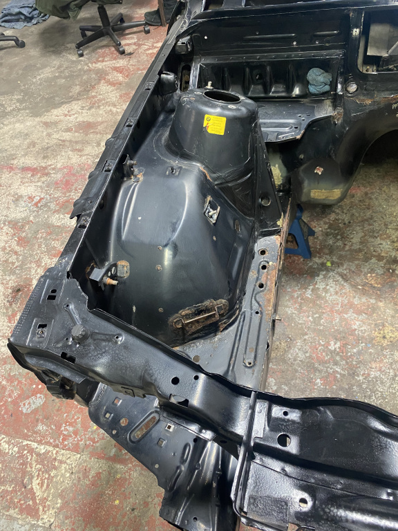

    Driver side not as bad, just needs a good sandblast

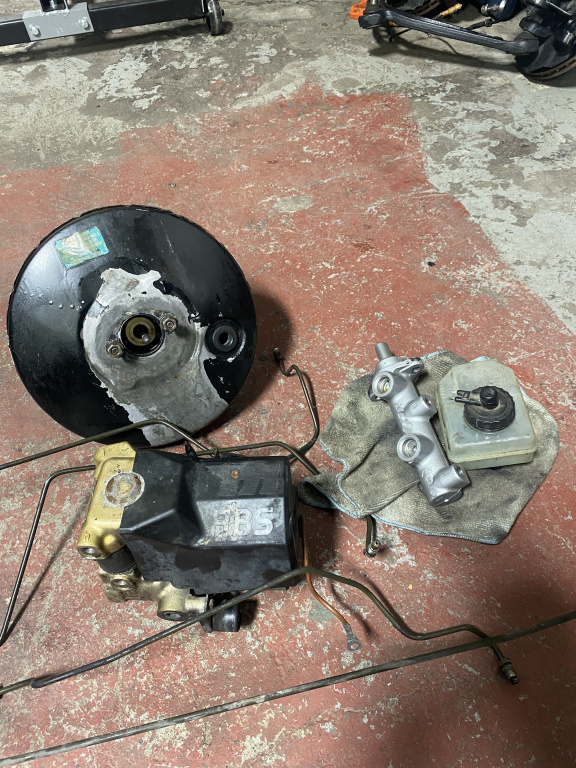

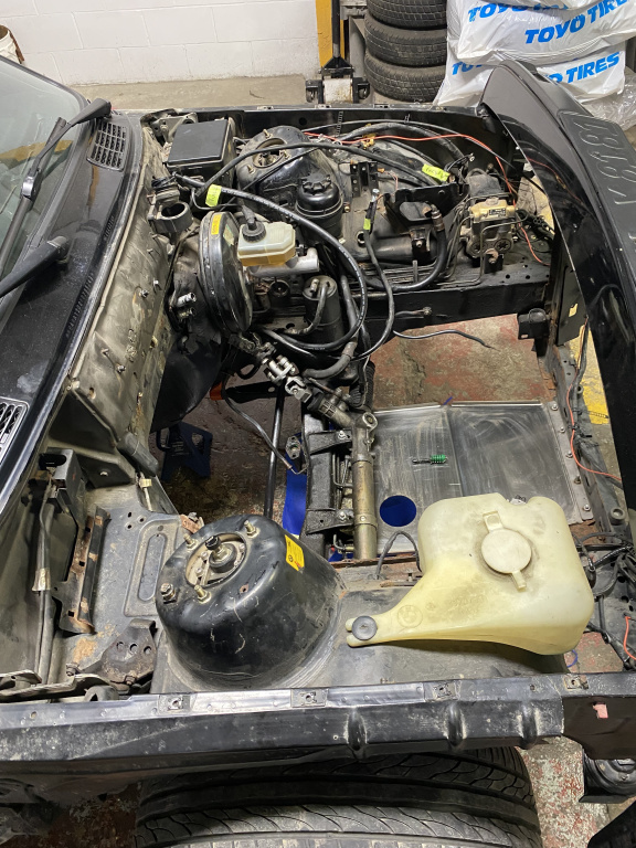

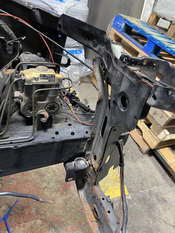

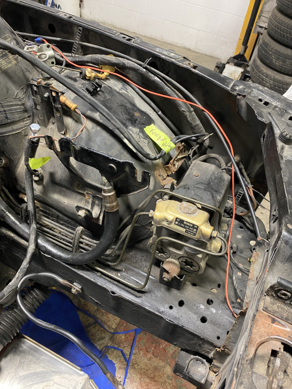

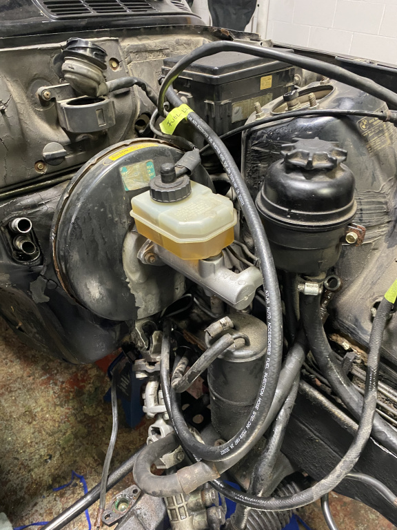

    Brake stuff out of the way, ABS isn't going back in, gotta decide on a booster setup
    Leaning towards X3 so far, but can't seem to decide.. so much info online about different experiences

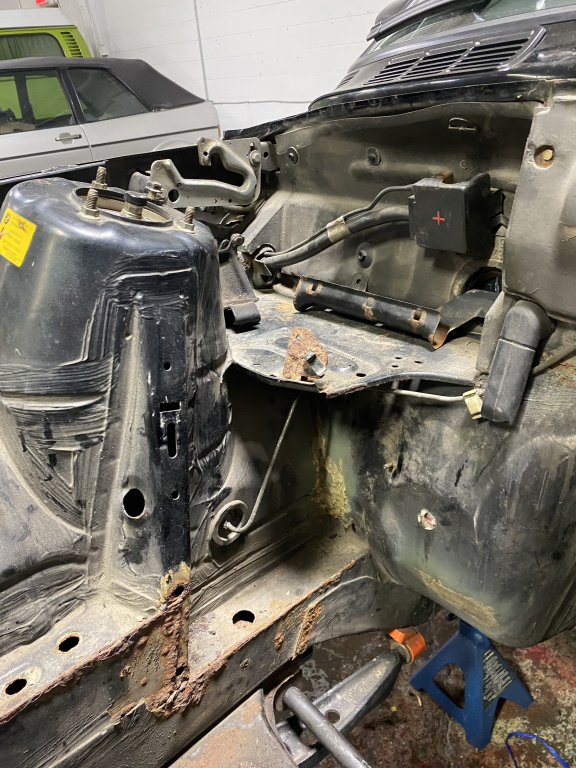

    everything gone, much better to have a better look at what i'm dealing with!
    Overall not in horrible condition​, to be expected with the age and it being a canadian car

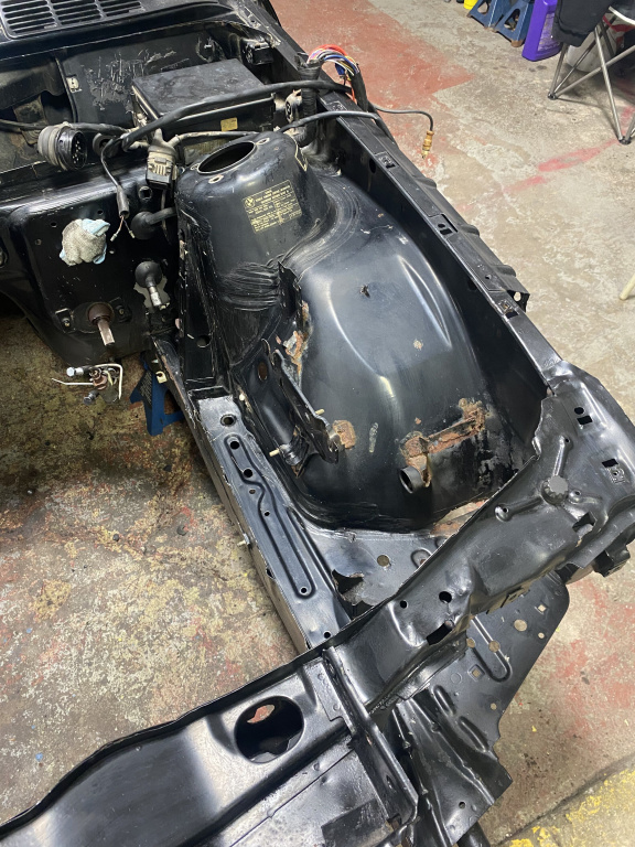

    Same on driver side, Only rust around brackets where water gets trapped
    Made me so happy to see it stripped down like this, waiting to be given the love it deserves to match the other 70% of the car

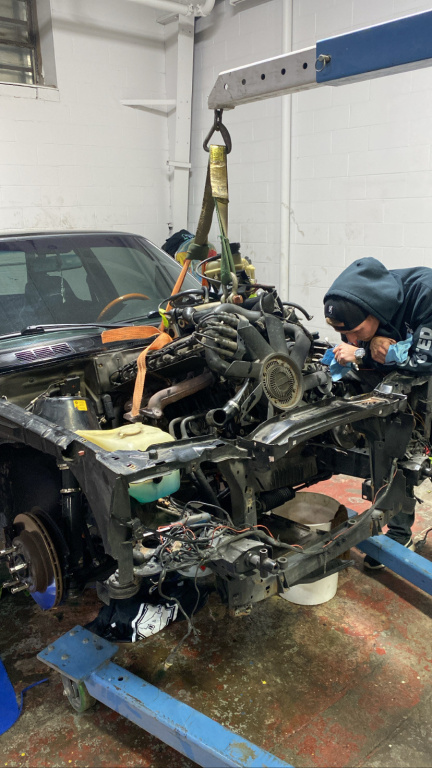

    replied

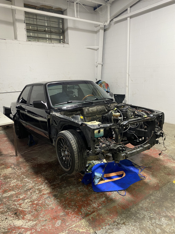

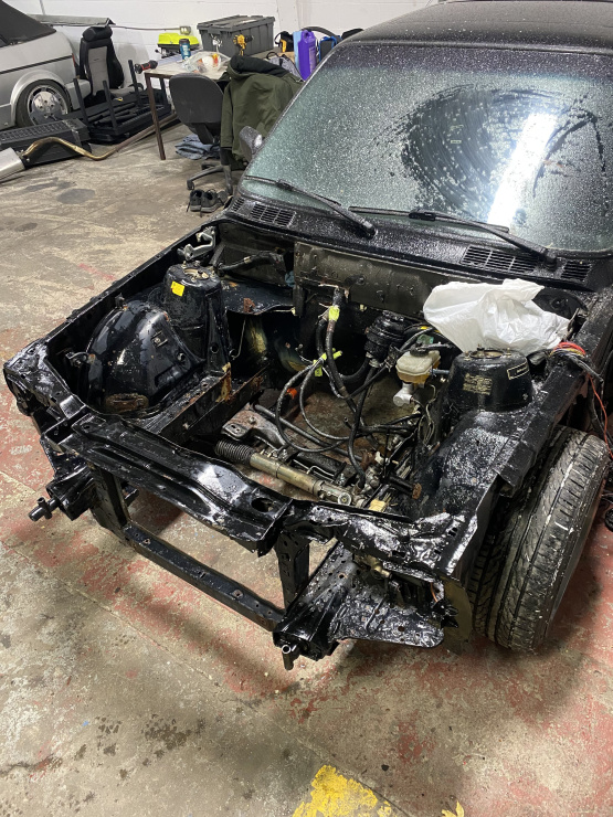

    Decided it was a good idea to pressure wash the engine bay while it was -3 outside, since it winter was coming fast and it was the last opportunity to move the car to where I could access
    the pressure washer without there being snow everywhere
    Cleaned most of the gunk out, but everything instantly froze, oh well, back inside to thaw out

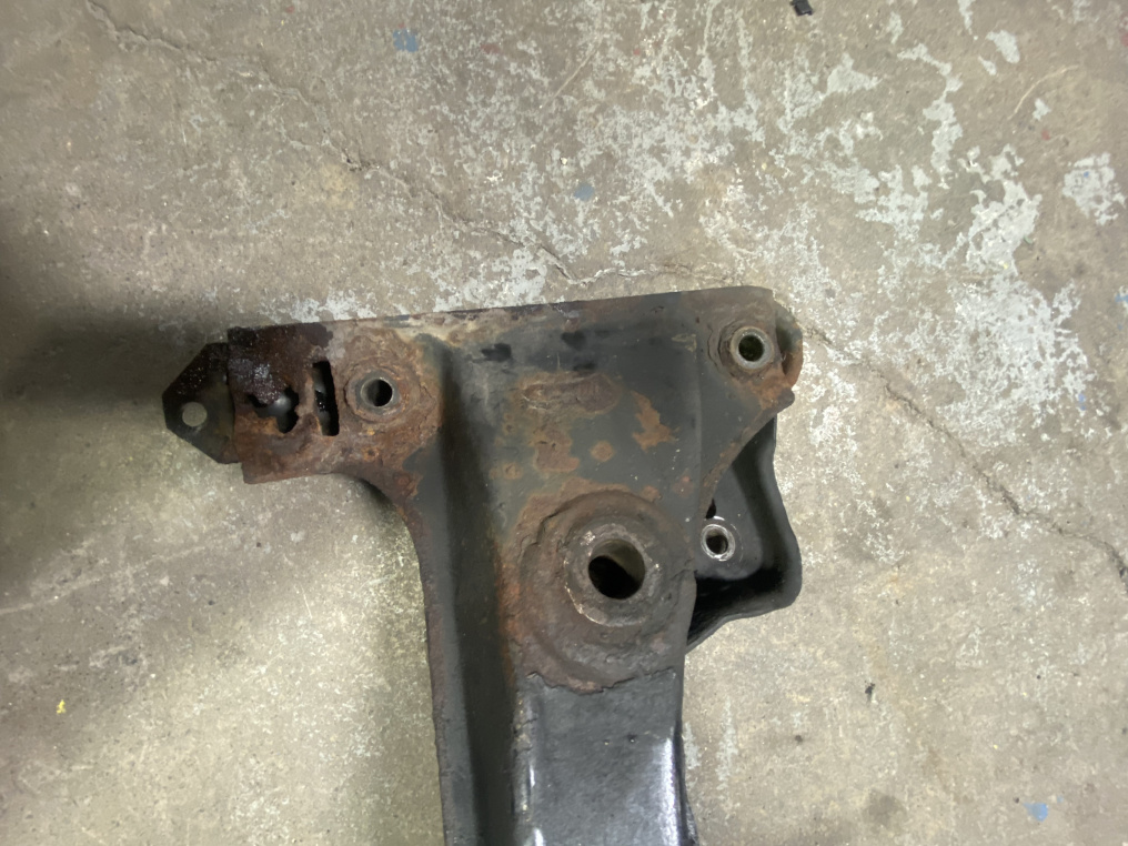

    Going to get the full Reinforcement and powdercoat treatment like the rear once the rust is gone

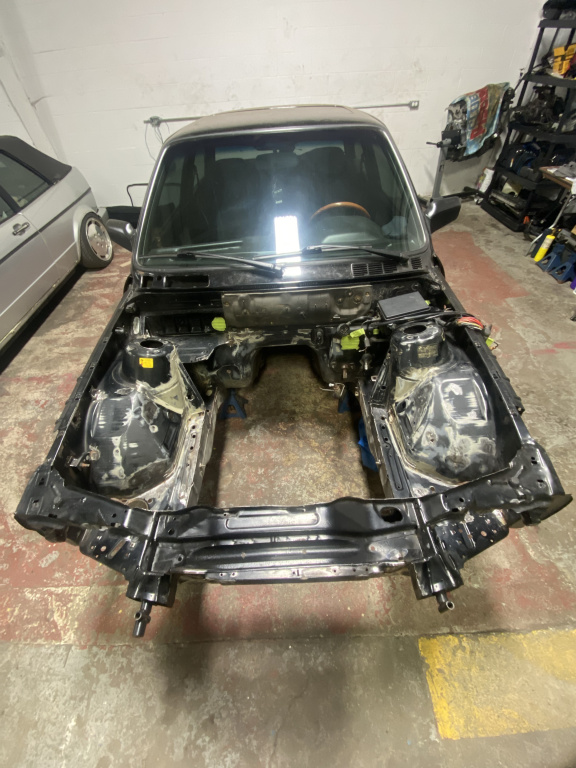

    Middle section was so covered in oil that it was mint

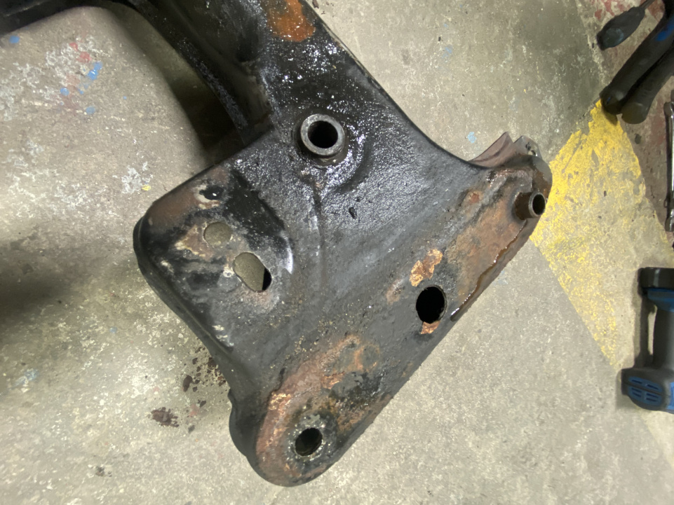

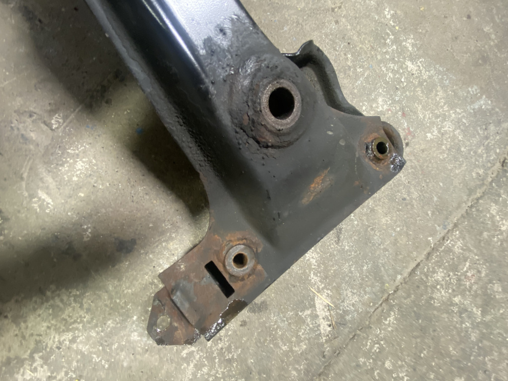

    Gotta fix the passenger side balljoint seat
    Leave a comment:

    Back to the well known jackstands after 3 years of being on the ground :P
    Back to work, let's remove all this junk!
    The more I remove, more I realize how filthy this engine bay is
    Crazy to see it so bare after all these years
    Plan is to delete ABS system completely, Remove all useless brackets and shave the engine bay
    First look at tranny tunnel, a few spots to fix up but overall not horrible
    Worst spot I can see so far, probably from exhaust heat for 30+ years
    Wiring mess I've been excited to rip out for 5 years now
    Rad Support has seen better days for sure

  • E30Rossi
    replied
    Fresh start for the E30 incoming
    Out for possibly the first time in 33 years! Buyer was already on his way to pick it up so didn't even have time to look at it thorougly
    Inspecting the engine bay after I've been dreaming of this day since I bought the car
    I made those previous patches when I was working on the rust repair, but couldn't access this side with the motor there
    Will make these repairs nicer now that I have the space
    Time to remove EVERYTHING else

  • E30Rossi
    replied
    Years of leaky BMW Motor, Due for a cleanup!
    Love the fact that it's aluminum block so minimal rust areas!
    Time to tear it apart and clean everything up to match the rest of my build
    Took about 3 hours with a few friends and a few beers to get motor/tranny out and ready for the new owner to pick it up
    Room for activities!
