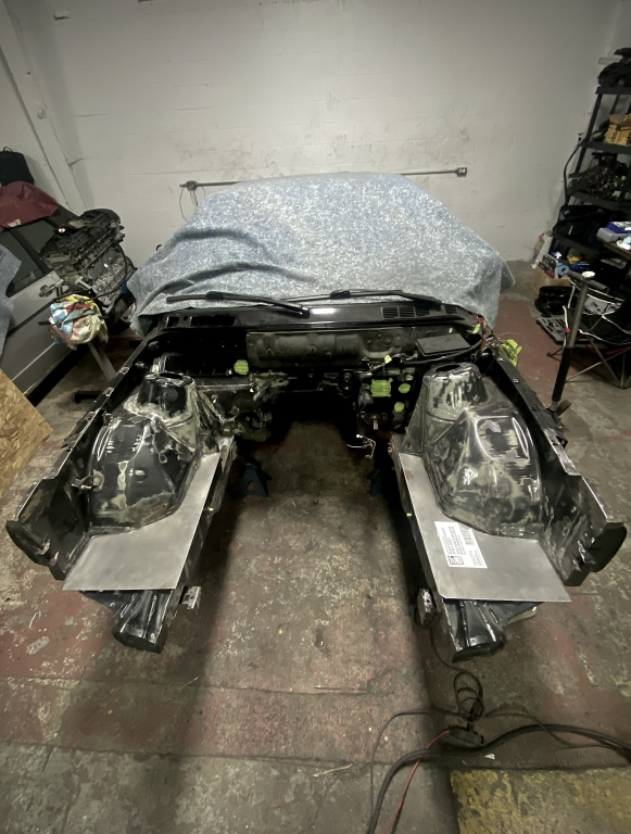

Well this is as she sits at the moment
We are officially up to date
Time to get to work on putty this coming weekend
Hopefully I can get progress done quickly
Lots of parts stacked up, but winter is going fastLeave a comment:

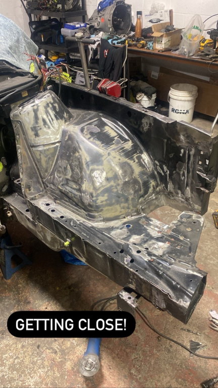

Grinded down any rust underneath, cleaned up welds and hit it all with Self-Etch Primer and then Filler Primer
Ready to undercoat the wheel wells and get to the next step of putty in the engine bay!
Driver side
Griding down welds, never ends
This part honestly lasts forever
Driver Side ready to be coated as well nowLeave a comment:

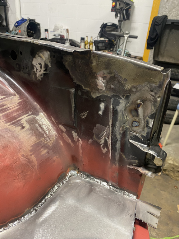

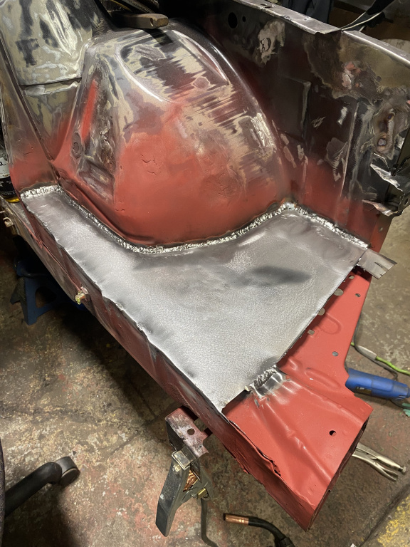

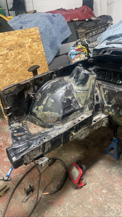

On to the next side! Rust converted applied and Ready to be coated
Driver side cut down to size
Plated off
Test fit rad support again
Reshaping inner fender

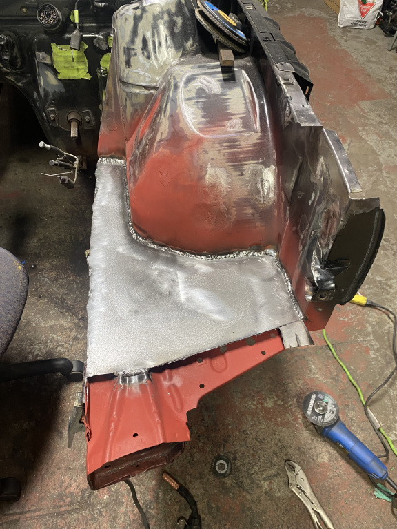

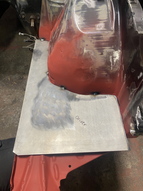

Planning on what to do with the edge, don't want to leave it open to road debris
Fully welded in
Leave a comment:
This will be so worth it at the end!

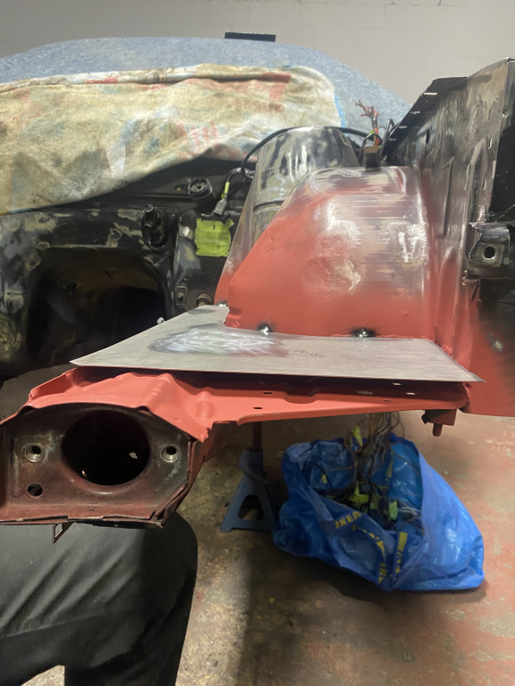

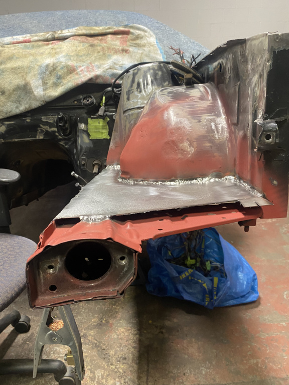

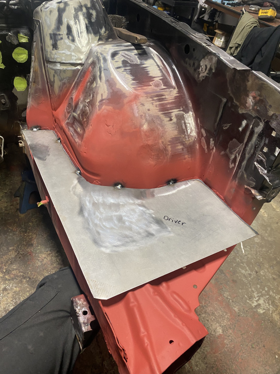

Cut out all the rust and start reshaping the edges to prepare for the plates to be welded in
Same thing on passenger side
Weld-through primer and first plate tacked in
Will cut the edge off with after it's welded in
