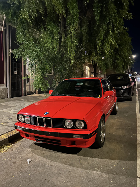

        Back on the road! Big refresh on the front suspension. Will be riding a bit to get the fuel system cleaned out. Then take her for a smog test. Does anyone have any tips to help? I just did a stomp test and got back only 1444 code. Which is no faults. Car still smells like it is rich on fuel. Exhaust had white smoke the first 10 minutes. After driving it had gone away.
        • BarlosE30
          • Apr 2024
          • 17
          Still spraying the front bumper trims pieces. So will get better pictures once those are done.
          Ride height is so much better for my neighborhood. Can actually get off my driveway without ruining the front!
