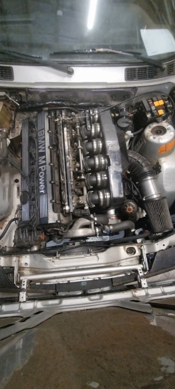

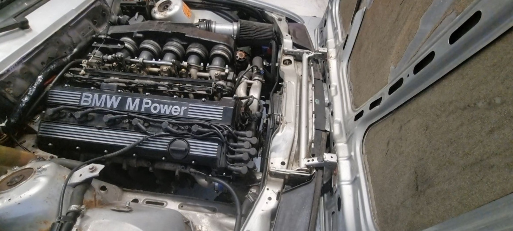

                        At this point I had reached the spring of 2024, I think it was March-April. From here it went quite quickly, I worked on the car every day after work. The snow also started to melt and spring began to approach. I had the goal of getting it drivable by May, although a lot of cosmetic work on the bodywork and inside the car remained, so I wanted to get it drivable anyway.
                        I started adapting the cooling system, here I used an e36 m3 radiator and mounted it at the front, in addition to the original s38 thermostat housing.
                        Click image for larger version  Name:	Resized_20230413_210759.jpg Views:	0 Size:	198.3 KB ID:	10133345
                        Click image for larger version  Name:	Resized_20240406_150231.jpg Views:	0 Size:	178.9 KB ID:	10133346
                        Furthermore, the exhaust was welded, used original s38b36 manifolds, and welded the rest myself, not the perfekt result, so I think maybe I will make a new one in stainless eventually, but this should work for now at least.
                        Click image for larger version  Name:	Resized_Screenshot_20250109_121643_Gallery.jpg Views:	0 Size:	104.5 KB ID:	10133347
                        Electrically, I don't have pictures of it, but it was quite easy to adapt to hook up. Had to make a new plug on the wiring harness and add a cable for the speed signal to the speedometer.
                        Click image for larger version  Name:	Resized_Screenshot_20250109_122500_Gallery.jpg Views:	0 Size:	121.0 KB ID:	10133349
                        I eventually got it started, but then it sprayed petrol in all directions, so I ordered new gaskets around the nozzles as these were bad, because I didn't want the car to catch fire.πŸ˜‚πŸ”₯
                        Click image for larger version  Name:	Resized_20230429_123406.jpg Views:	0 Size:	125.8 KB ID:	10133348

                              Here is an update from this summer and autumn 2024.
                              As I said, the car started now, but had the o-rings for the nozzles changed first, before it was safe to drive, and then it was ready for a test drive.
                              Click image for larger version  Name:	Resized_Screenshot_20250116_091841_Gallery.jpg Views:	0 Size:	201.8 KB ID:	10133798
                              I was so ready and excited for this day, because the S38 engine in the e30 has always been a dream for me. So I was feeling like a little kid in an amusement parkπŸ˜‚
                              Here is a picture of the e30 before the test drive.
                              Click image for larger version  Name:	Resized_20230519_150519.jpg Views:	0 Size:	90.9 KB ID:	10133797
                              As I said, I haven't spent much time on the cosmetic aspects of this car yet, so it's not finished yet.πŸ˜…
                              But I got to drive and test it, and yes, it spins like that.
