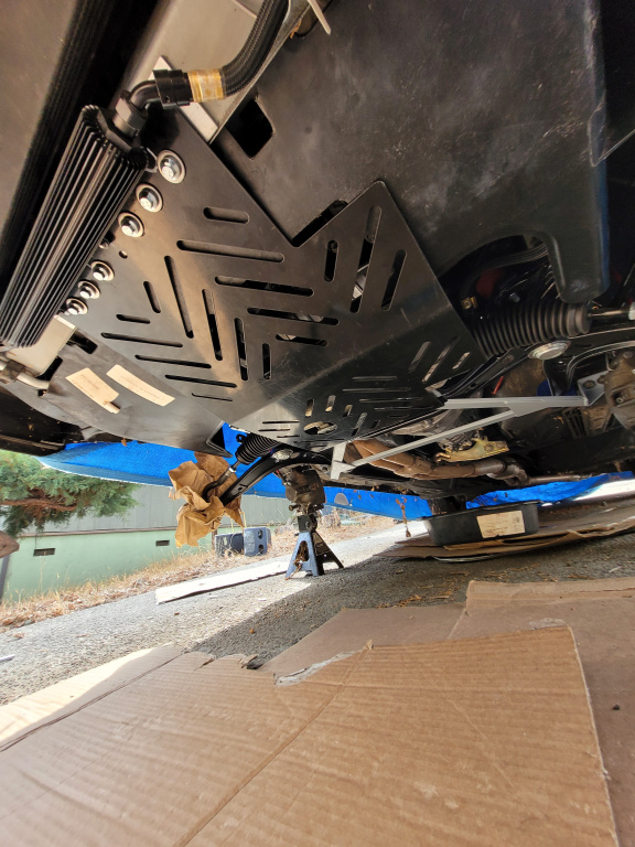

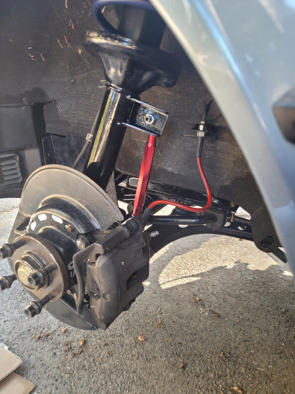

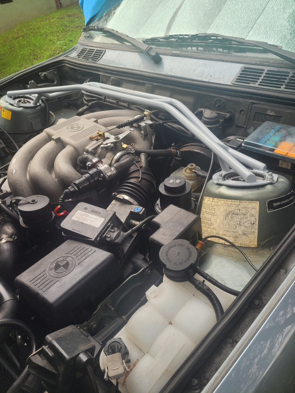

    Hi guys I wanted to make a late introduction of my e30 as I now have it in semi presentable shape finally. I just completed a front suspension rebuild which was pretty extensive. This included:
    Reinforced front subframe
    New offset CA bushings with new CA arms
    H&R OE sport springs
    Koni Yellows
    Ground Control Sport Strut Mounts
    M3 style endlink mounts
    New sway bar bushings
    Self-rebuilt and installed Z3 Rack conversion
    Chase Bays PS hose and cooler setup
    Rebuilt Front Calipers
    Braided brake hoses
    RaceSkids skid plate
    StrutbarWorks Strut Brace
    StrutbarWorks Under Chassis Brace
    Baffled Oil Pan
    12.5mm front wheel spacers for the new wheels that aren’t on yet
    Wheel stud conversion

    I just got my first drive in it after doing all this work so I am happy as a clam right now. The only
    “issue” I haven’t figured out is an intermittent steering creak that only happens in a specific range of wheel travel on the left side and only at slow speed or no speed. I checked for rubbing, strut nuts retorqued appropriately etc.

    *Note: PS cooler is not mounted where pictures show, I just didn’t have another photo on hand besides ones taken during mock up​. My vision for this car is to make a highly streetable fun car that still has creature comforts but can also be whipped around at the autocross.

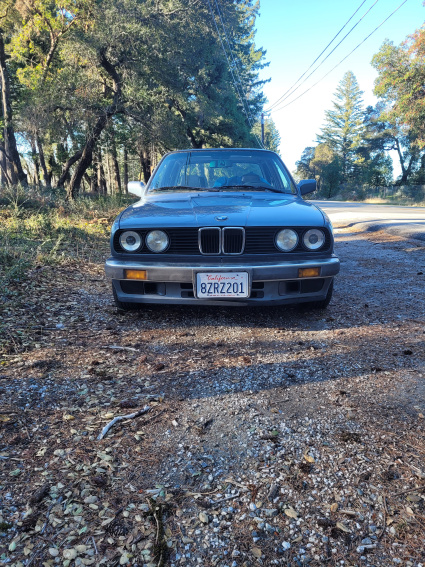

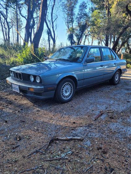

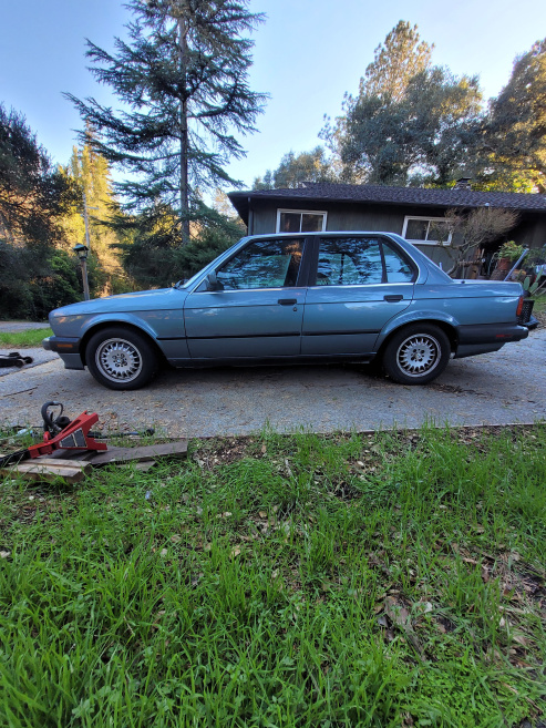

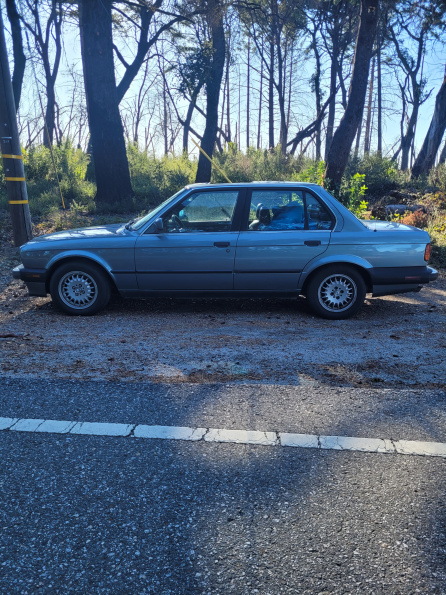

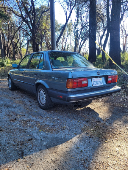

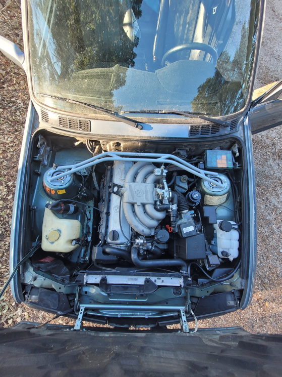

        I'm no photographer, quite bad actually, but here's a few more snaps I took recently before discovering the master cylinder was failing. Luckily this happened on an empty road and the brakes worked enough to get me home safe.

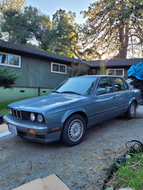

          Uploading one picture for the archive. H&R OE Sport springs sitting too low in the rear. I didn't realize this has happened to others until doing a search to compare. At least this lets me see how I feel about the spring/shock combo. I definitely want to firm up the rear shocks for body roll control but it rides nicely.
            You can use the thicker upper E46 rear spring pads (direct swap, in place of the E30's rear lower spring pads) to raise the rear a bit. I had to do this on my 318is. There are also aftermarket adjustable/stackable rear spring pads for this very reason.
            • 88Sedan
              • Apr 2023
              • 278
              Current lower spring pads are 7.5mm and I have 15mm ones that will be installed later. This should result in roughly 12mm/.5" raise which might be enough. Do you know the thickness of the mentioned e46 upper pads? My normal DD needs some maintenance so I won't get to it for a while.
              • mike.bmw
                • Dec 2015
                • 1777
                Here's an old post with some info: https://www.r3vlimited.com/board/for...84#post7081484
