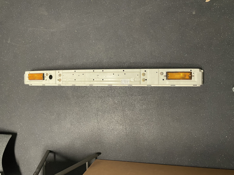

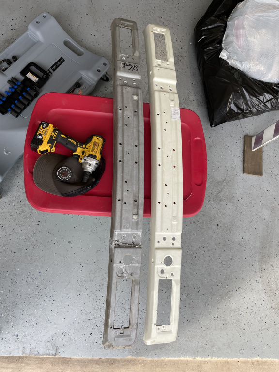

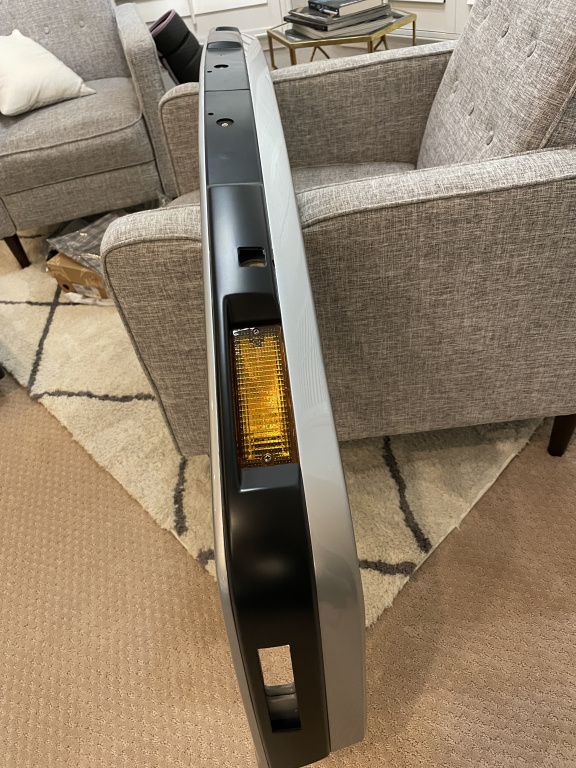

    Here's the bumper pieces.
    The gray is original piece that cracked. The white/cream colar version to the right is the new OE piece.

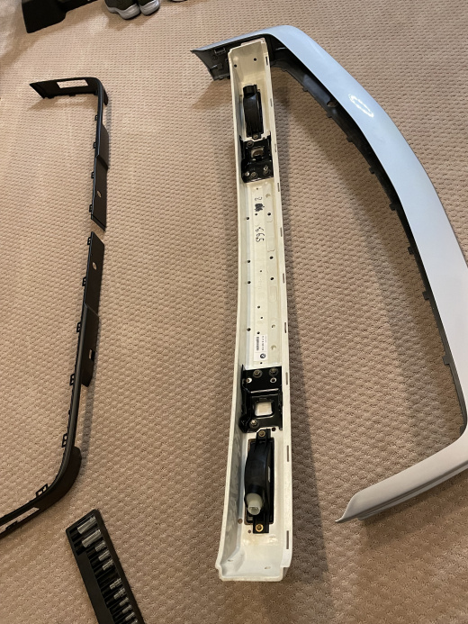

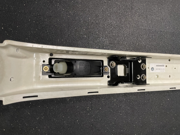

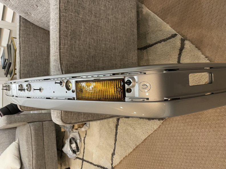

    Assembled it all in the house with carpeted floor to ensure I didn't scratch anything up. I picked up the freshly painted silver bumper, added all new new trims and lights. Reused (cleaned it and painted) some of the metal brackets.
    When ordering new black plastic trims, I decided to keep the U.S. version (with yellow reflector/light on side). I do like the Euro look as its more cleaner though.

      It's a puzzle and there's an order to put it all back together. For example, I remember you have some push pins/fasteners you need to before adding the black trim piece.

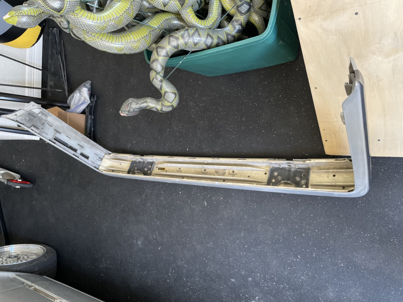

      Here's how the inside bumper fits into the outer shell (painted) bumper for reference point. This picture below is the damaged version.

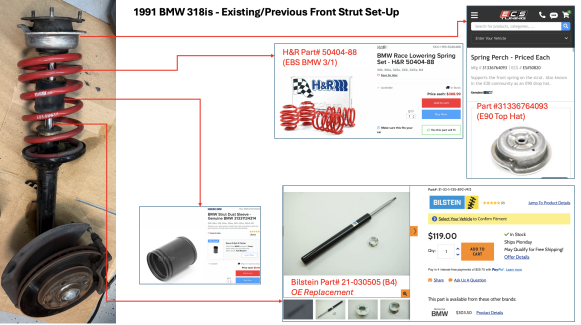

                Been researching and figuring out what I have before refreshing/replacing/ordering parts on the front struts. It is not OE set up as previous owner made some changes. Finally figured it out.
                Current Set-Up:
                - H&R Spring
                - E90 Top Hat (I could tell it was not OE as it was aluminum and thicker than OE used one I have in my part bin)
                - B4 Bilstein (OE replacement. Not sure why previous owner didn't use B8 since its much lower than stock)
                - Foam Bump Stop was completely gone (crumbled away..I could see the residual)
Name:	Screenshot 2026-05-03 at 7.22.04 PM.png

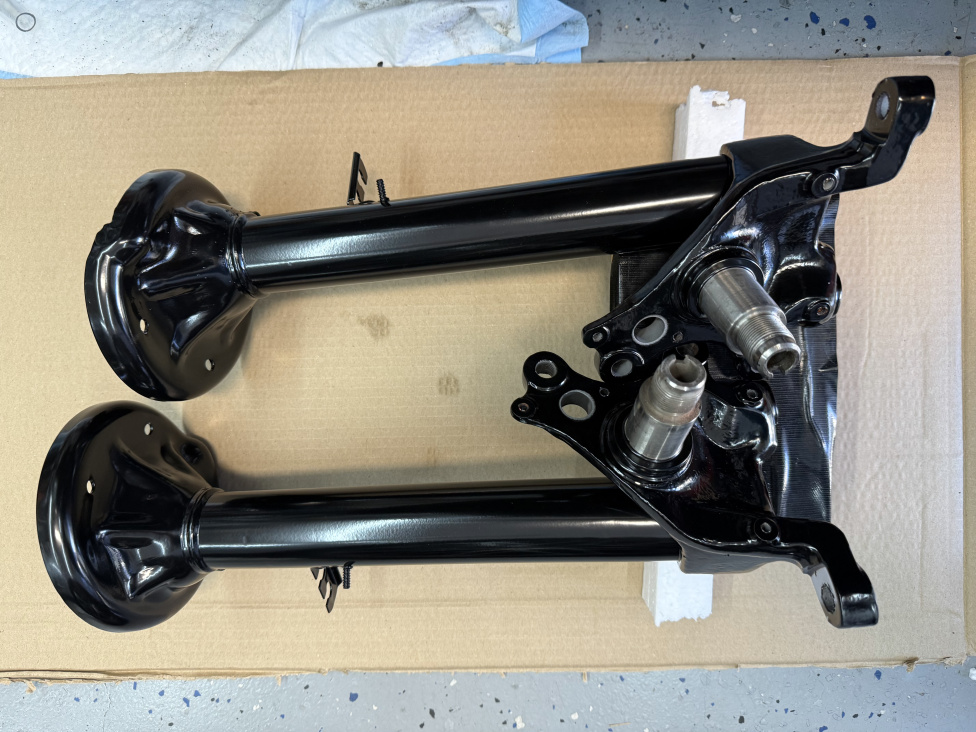

                  #53

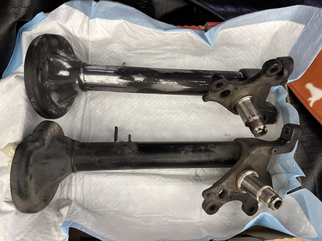

                  First order of business. Disassemble strut and get it cleaned up. It had some rock chips, cosmoline, etc. I thought about just sanding it down and spraying regular black chassis paint. But, decided to go with powder coating instead since it under road elements all the time and wanted this one to last for a long time. Top one is my attempt to sand. Gave up and had it blasted and powder coated. Looks like it came from factory now.

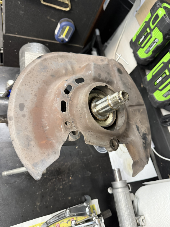

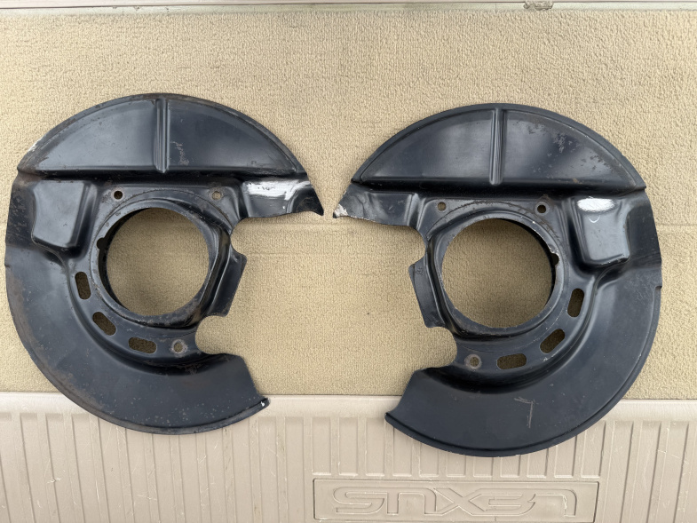

                          FRONT DUST SHIELDS
                          Just waiting for some final parts to come in. I was going to get new brake dust shields. At this time of writing, new OE shields are little over $100 each. But after getting it soaped/washed and scrubbed away decades of brake dust/road grimes, decided to just refresh the OE ones. Getting it sand blasted and powered coated. It’s in great shape. Minor surface rust in small area.
                          Here’s how it looks right now (before refresh) after soap washing it up. It has cosmoline on some area. It’s the white/yellow stuff on the paint. Cosmoline are so hard to take off.
                          Click image for larger version  Name:	IMG_6954.jpg Views:	0 Size:	220.5 KB ID:	10160863
                          Click image for larger version  Name:	IMG_6955.jpg Views:	0 Size:	240.0 KB ID:	10160864

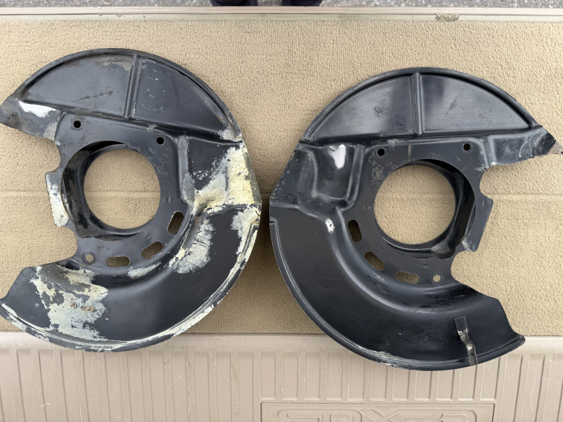

                            #58

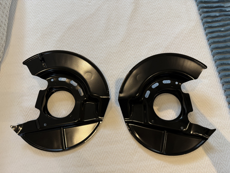

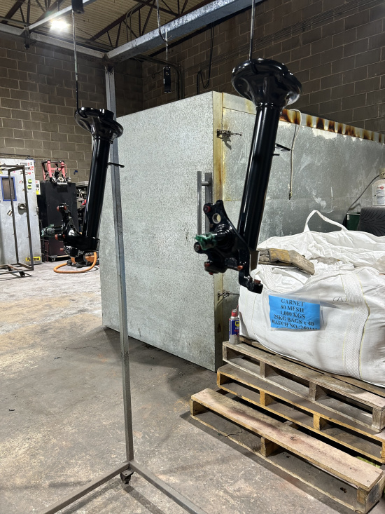

                            Here’s how it looked before washing it up…I thought it was completely surface rusted. It ended up being brake dust snd dirt.
                            Click image for larger version  Name:	IMG_6731.jpg Views:	0 Size:	179.0 KB ID:	10160866
                            Here's how it turned out after media blast and new powder coated. Good as new. Ceramic coated it as well to make it easier to keep it cleaner moving forward...at least for little awhile.

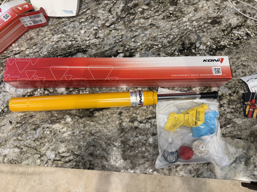

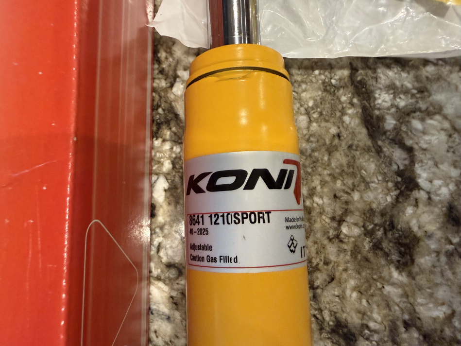

                              FRONT SHOCKS (KONI 1210 SPORTS)
                              Wanted to share the front shocks I ended up choosing, the differences and why...
                              When doing my research today (circa 2026) on the internet, reddits, facebooks, forums, etc., many found Bilstein B8's to be little stiffer than Koni's. Not 100% if this is true. This was just nice to know. I ended up going with Koni's for few reasons...
                              1. Koni's were on sale ($200/ea vs. $250/ea).
                              2, Koni's are adjustable. This is a nice feature.
                              3. Appears the front Koni's are easy to adjust from the top.
                              I found 3 yellow front Koni versions that fit E30. This was little confusing but I think I found the differences:
                              1210: Shorter for lowered springs (mainly used on E30 M3s)
                              1021: Longer/extended length (mainly for E30 coupe and sedans)
                              2277: Used for E30 convertibles
                              I went with 1210's. Between H&R springs, E90 Top Hats, etc., I figured I needed something shorter than normal. Couple forums posting was happy with this set up on their E30's (non-M3). Previous owner had the Bilstein B4 (OE replacement version) with the H&R springs and E90 Top Hats, so I was able to compare the two. Just FYI, when I was dismantling the current set up, I didn't have to compress the springs. I think this is because the B4 had longer shaft with shorter springs.
                              Box Label:
                              Click image for larger version  Name:	IMG_6957.jpg Views:	0 Size:	239.4 KB ID:	10160882
                              What comes in the box:
                              Click image for larger version  Name:	IMG_6861.jpg Views:	0 Size:	342.6 KB ID:	10160883
                              Click image for larger version  Name:	IMG_6862.jpg Views:	0 Size:	245.3 KB ID:	10160884

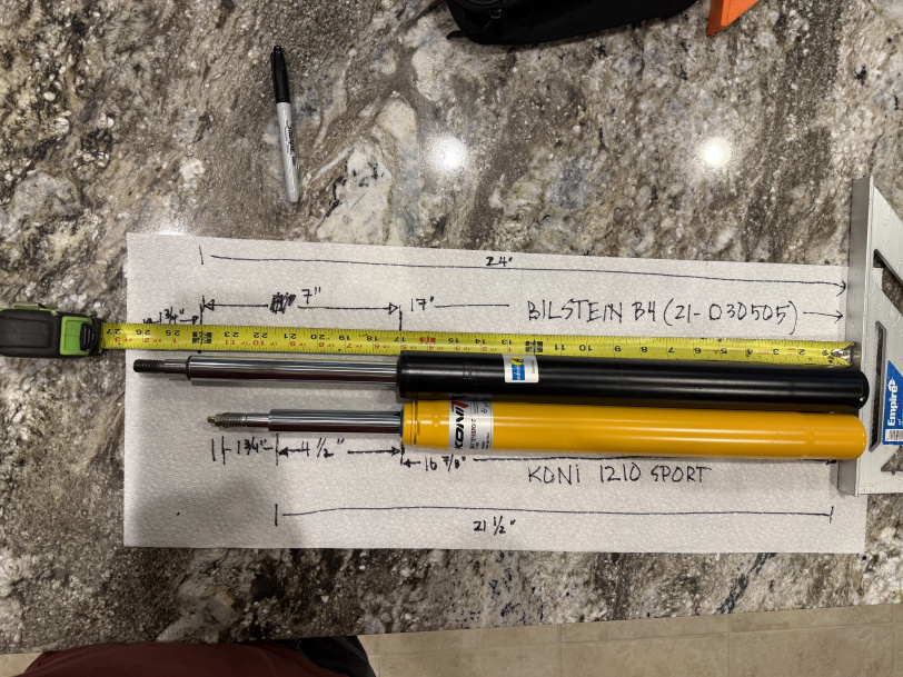

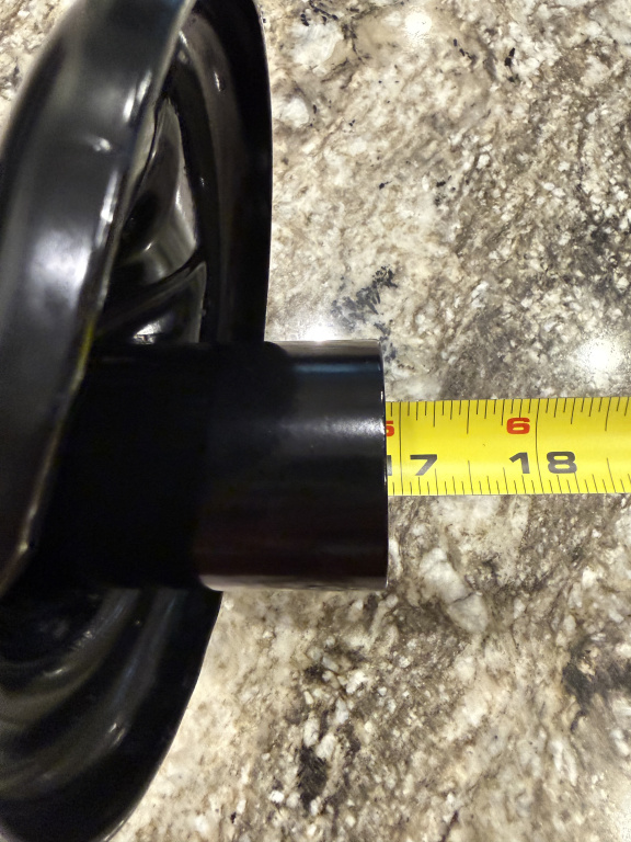

                                #60

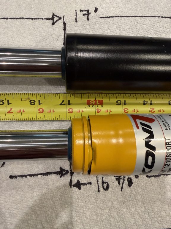

                                I couldn't find any measurements at all for the 1210's against OE (at least with Bilstein B4) set-up. So, here's my measurement comparisons. Hope this is helpful for those looking for it.
                                Total Length (fully extended):
                                Bilstein B4: 24"
                                Koni 1210: 21 1/2"
                                Shock Body
                                Bilstein B4: 17.0"
                                Koni 1210: 16 7/8"
                                - basically the same body length. What's interesting is the E30 Strut is 16 7/8".
                                Shock Shaft Fully Extended (not what to call it)
                                Bilstein B4: 7.0"
                                Koni 1210: 4 1/2"
                                - Koni is 2.5" shorter than Bilstein B4
