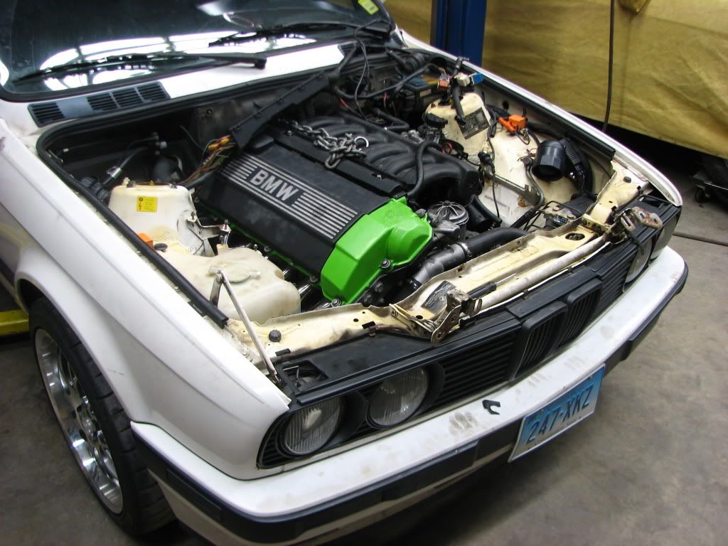

        Oh and btw, the engine is in. Fitting it with the headers and tranny already on is a royal PITA.

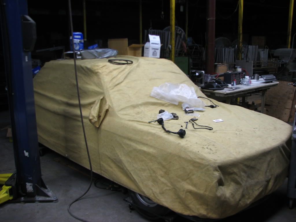

        And the E28 is feeling unloved with all the parts stacked on the cover.
        and then the fun begins tomorrow and this weekend hooking everything back up, fabbing the exhaust, etc.

            Well the car is running, but having some issues. Coolant gauge seems to be inop and the cooling system refuses to bleed. Seems like the thermostat isn't opening or the water pump isn't circulating.
            Other than that, the car ran great! No leaks and fired up the first time with no issues.

                What Rad you using? did you use the e30 clt temp sender in the cylinder head?

                  Did some searching in the 24V section and even though I swapped it into a 318i, looks like I should have used the M20 single pin temp sensor.

                    Originally posted by So Live View Post
                    Sweet! Looks good dude. How you been?
                    Good dude, good. Busy with work and the endless car projects. Hows everything going with you?
                    Using M42 Radiator and no I haven't used the E30 temp sender. Thinking that may be the case. Do you have to pull the intake Manifold to get at it?

                      m42 rad is a pain to bleed. make sure the cars cold, start it turn the heat on high open the bleed screw on the rad. rev the motor to like 2-3k rpm till you get coolant out the bleed screw. It took me a few cycles to get mine bled.
                      Ehh, its a lot easier to get that sender out with the intake off but it is doable with it on. find a mirror and a good light lol. Im pretty sure you can fit a deep well socket over the whole sender which makes life easier...

                          Yeah, I tried filling the top hose all the way to get coolant to the heater core, then jacked up the rear and revved it up to like 2.5K. The heat was cranked up all the way too and I couldn't even get heat. Shut off the motor so it wouldn't overheat.
                          I've got some good cordless drop lights and a nice mirror, guess I'll give that a try lol.

                            ^You need to jack the front of the car, not the rear.
                              Yeah your right.
                              Ben like i said it took me a few cycles of colt to hot to get it to start bleeding

                                Alright, I'll give it a shot. BTW, that sensor took about 4min to R&R. Just pulled off the MAF and intake and it was easy access. Deep swivel sockets ftw!
