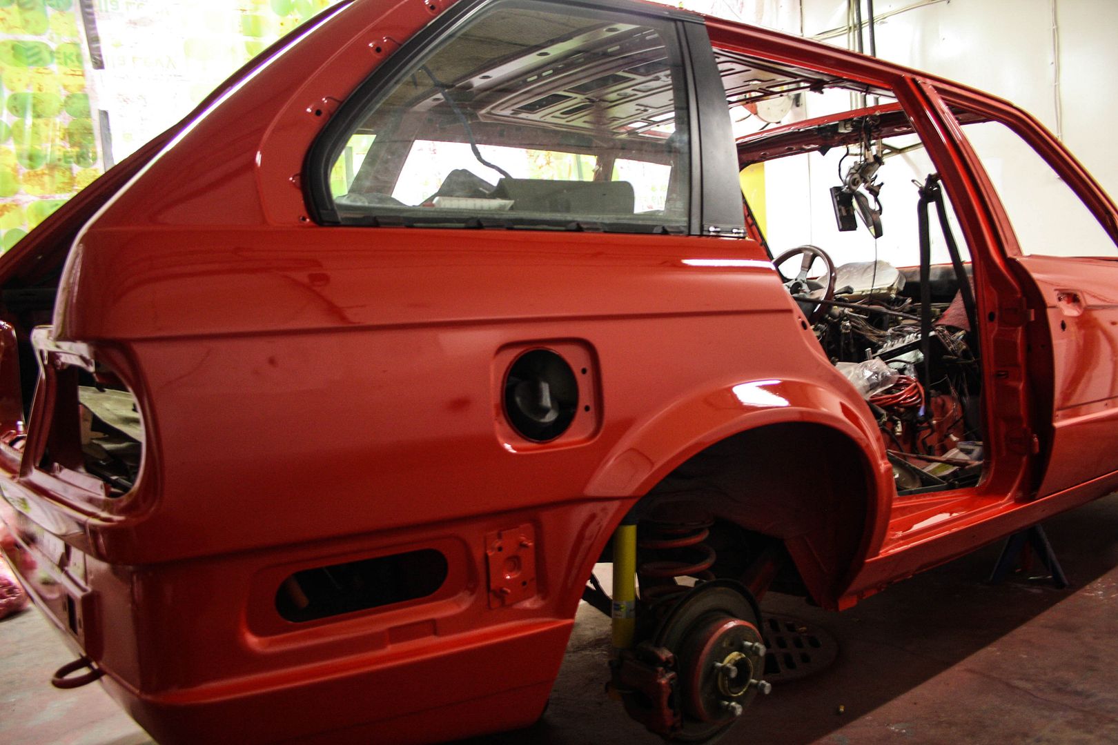

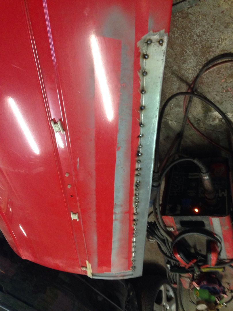

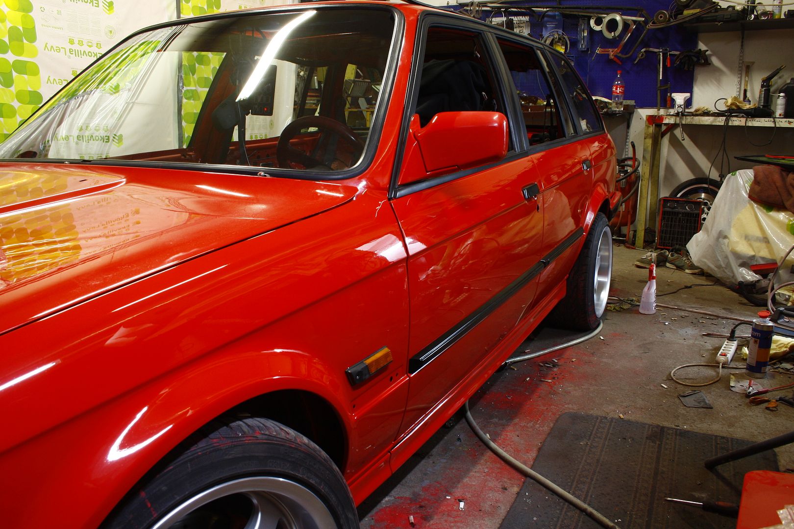

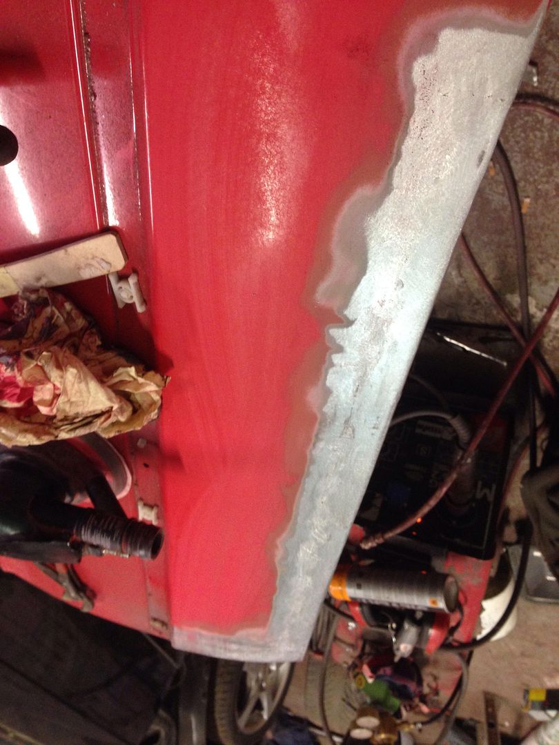

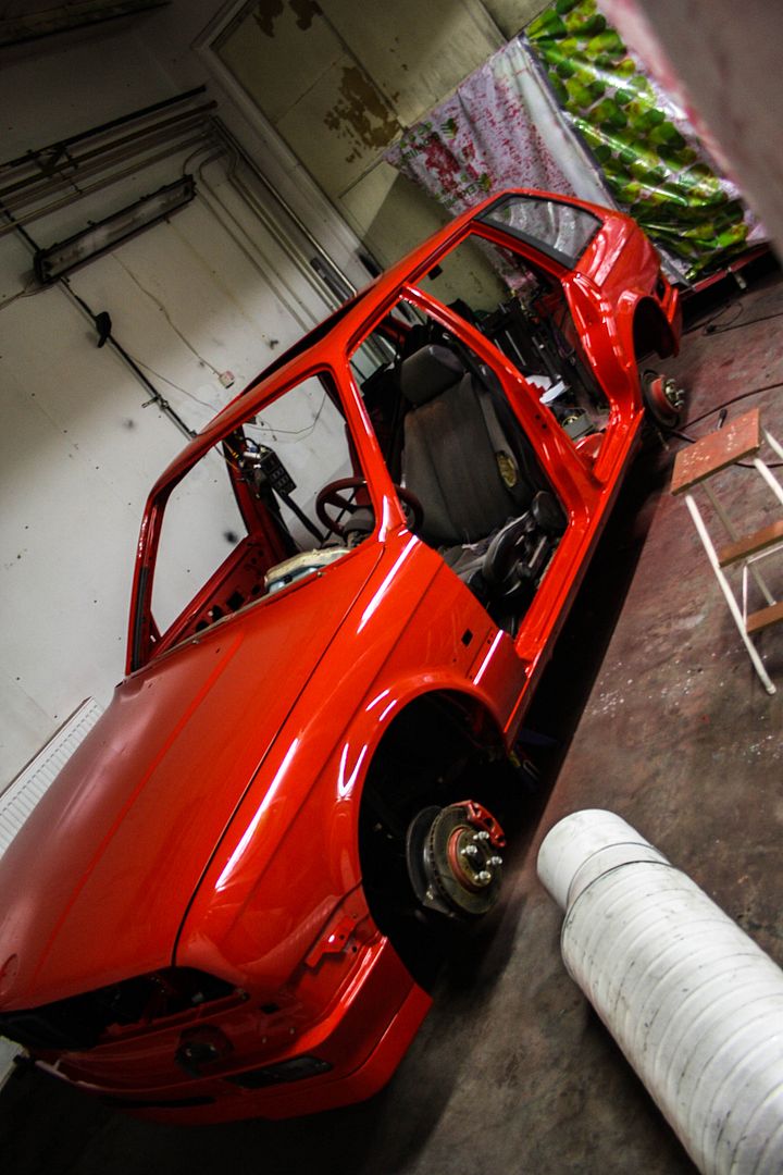

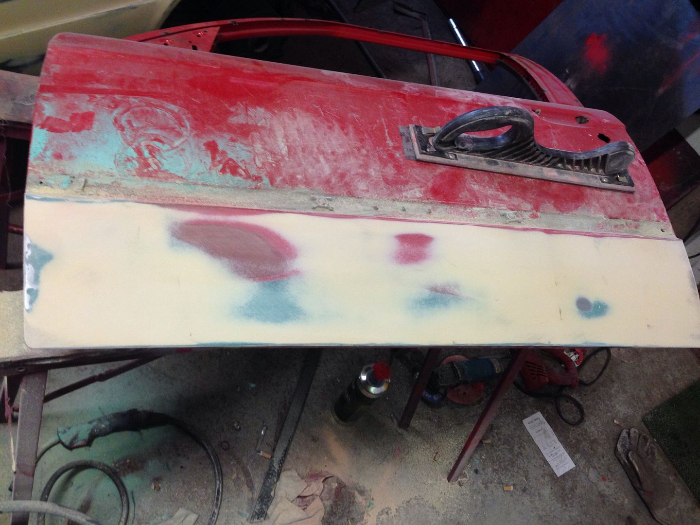

      Drivers door had seen better days,i looked for a decent conditioned door for replacement but after few week of searchin. Decided to fix the old one,so...
      My english isnt so good so i let the pics do the talking.
      I dont have any photos of the painting process itself
      But the car was painted in the garage,with my 2 brothers.
      The whole painting process was done without "bodyshop".
      But a few photos after removing the masking.
      Let the body cure for few weeks,at the meantime painted the bonnet,doors,and other pieces. The pictures are at a random order,not as a timebased.
      At the past few weeks(nearly a month) been finishing the paintjob and assembling doors,bumpers,and all the little stuff.

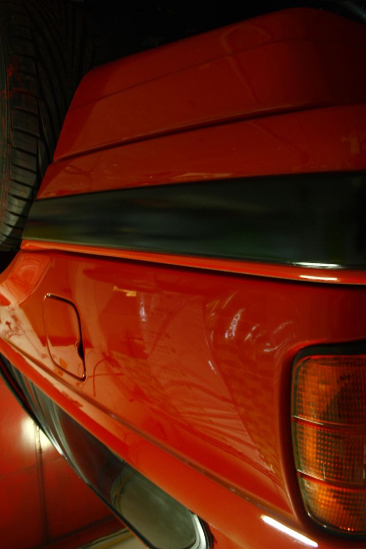

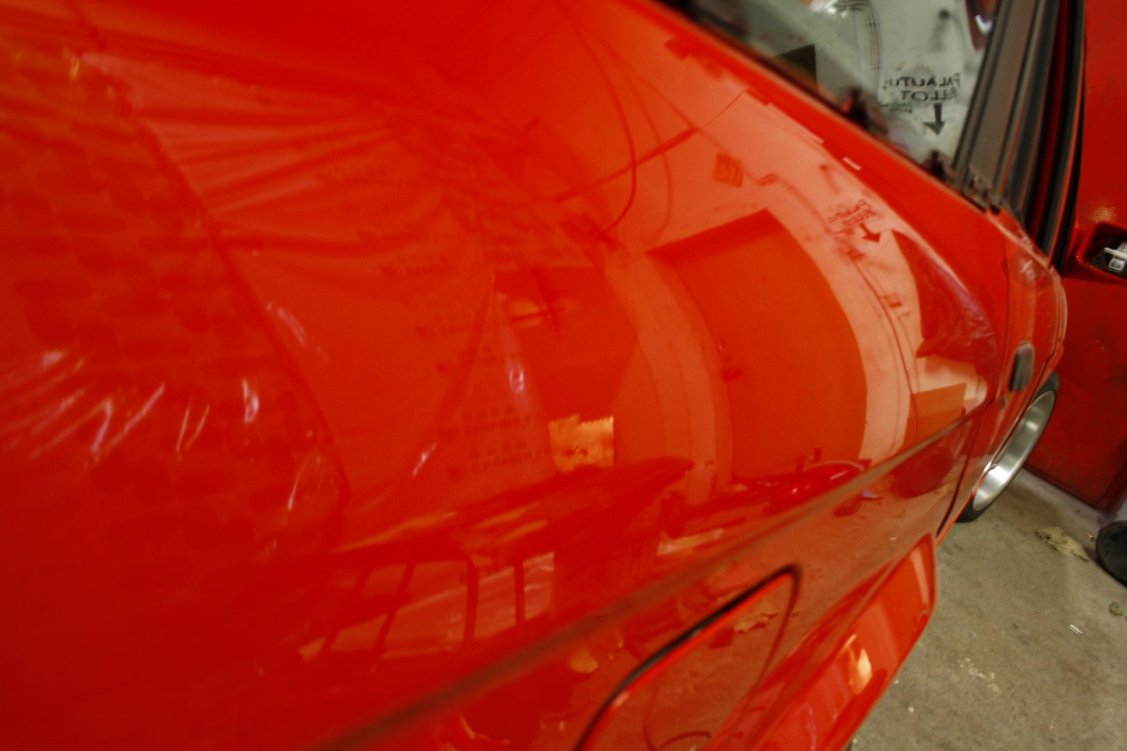

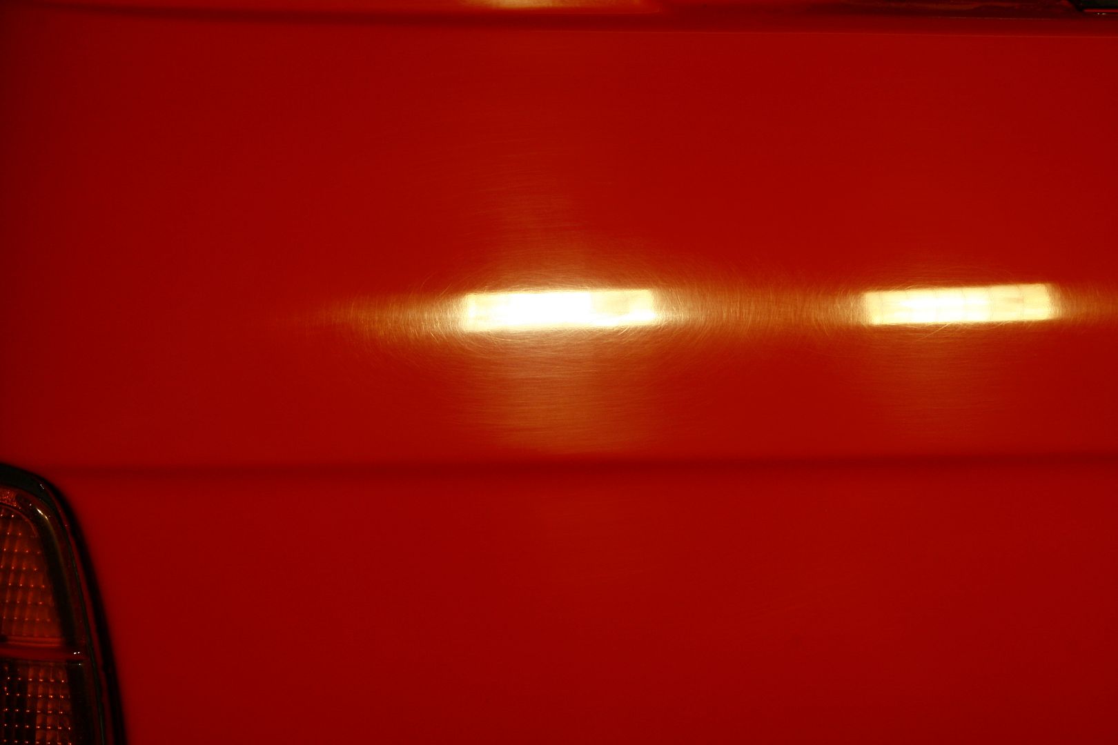

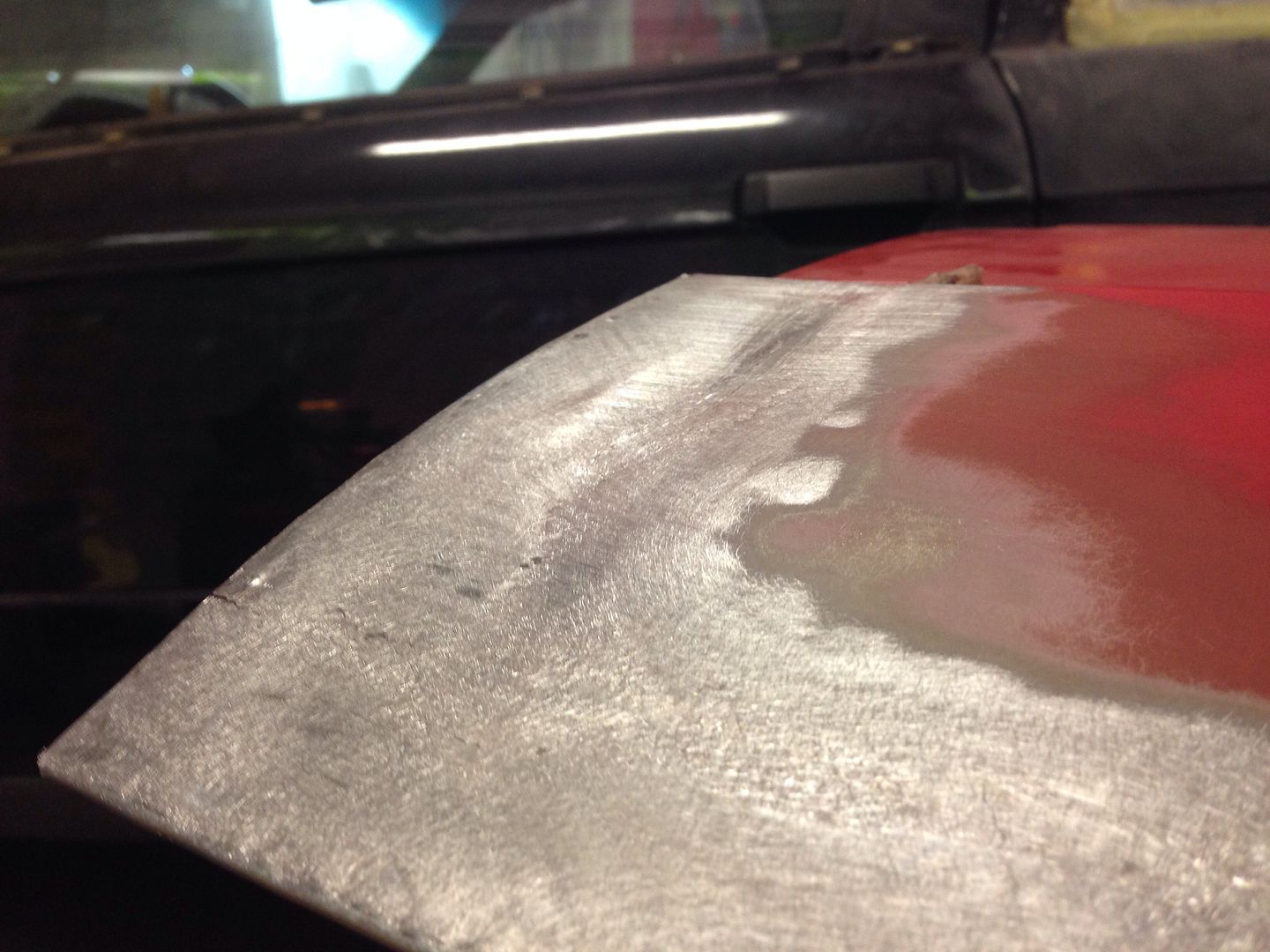

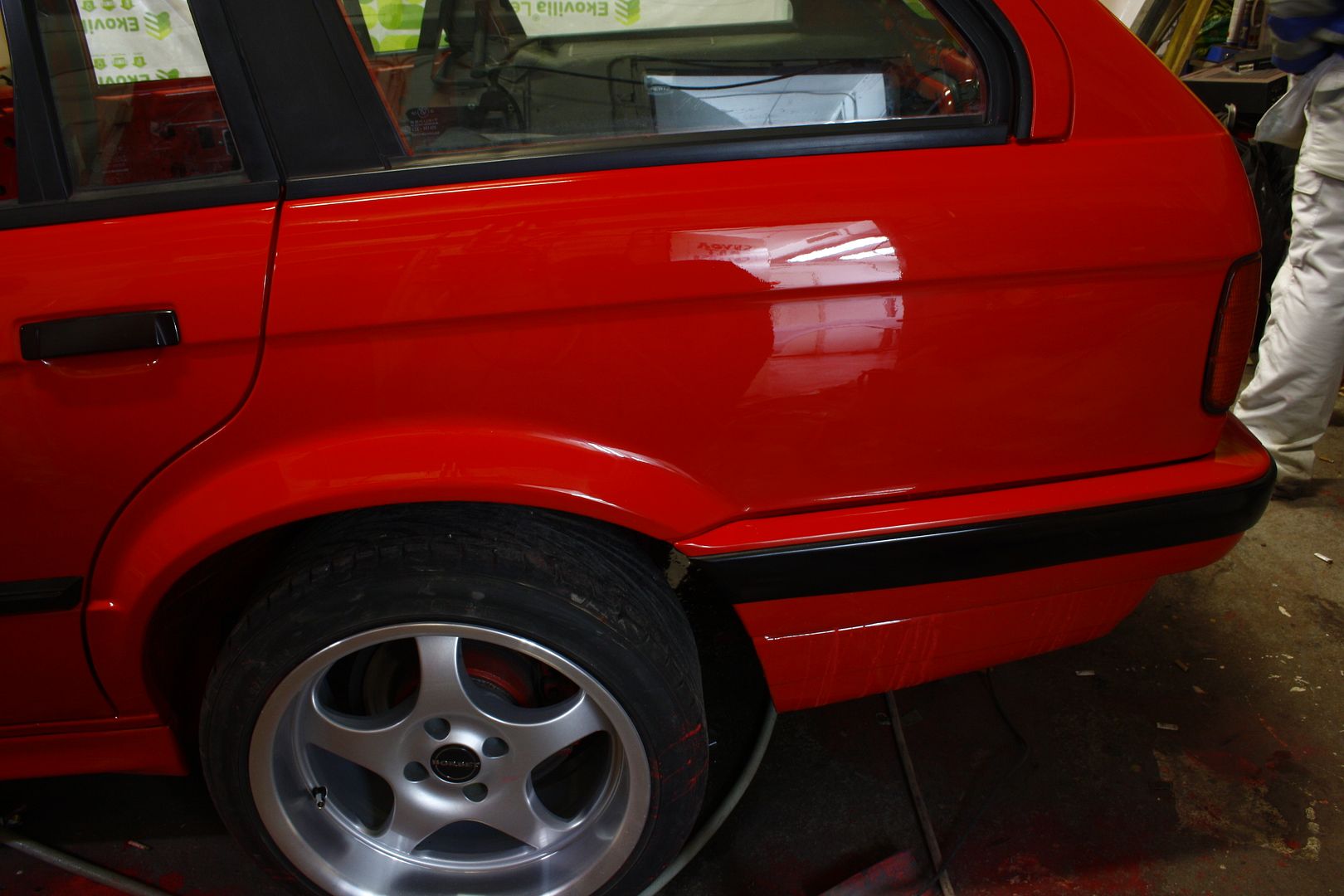

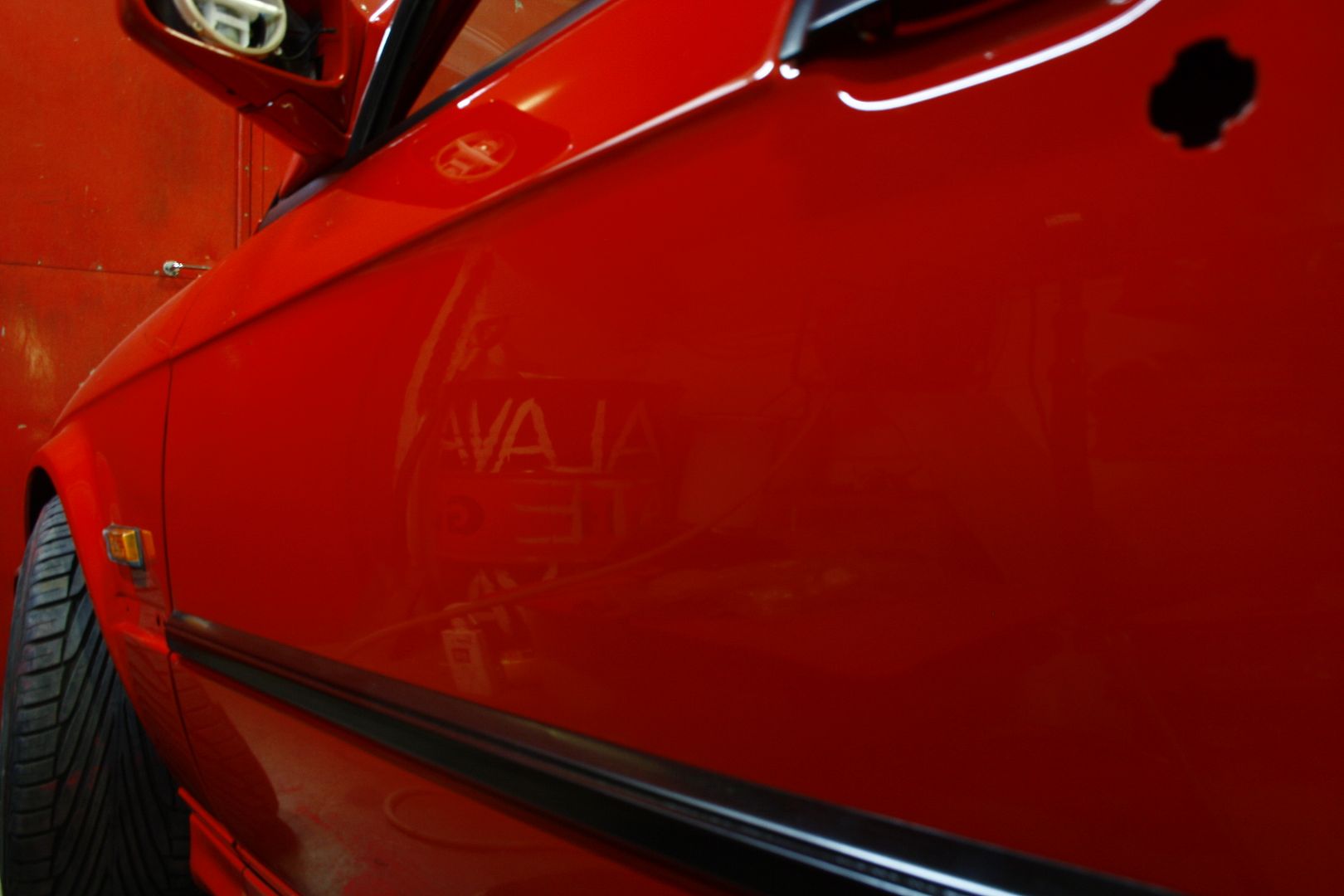

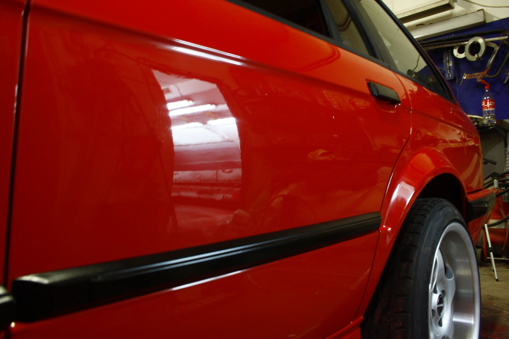

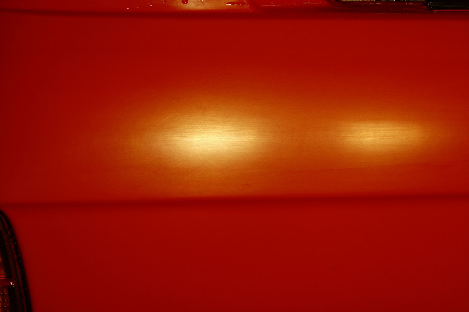

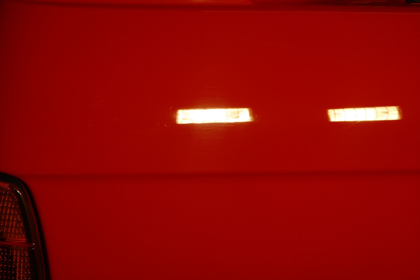

        Getting the desired result took a LOT of work!!
        Iwata WS400
        P2000 Grit wetsand by hand,the whole car
        P3000 Abralon with a DA sander+Scholl S0(cutting compound) with a rotary polishing machine
        S2 Orange compund
        S17+ compound
        Drivers side allmost ready,the finishing buffing needs to be still done when its fully assembled.
        wait for the next post..

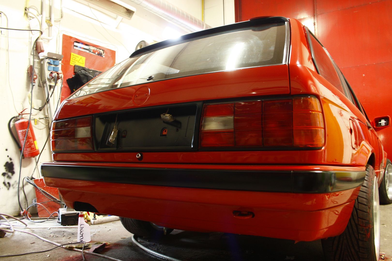

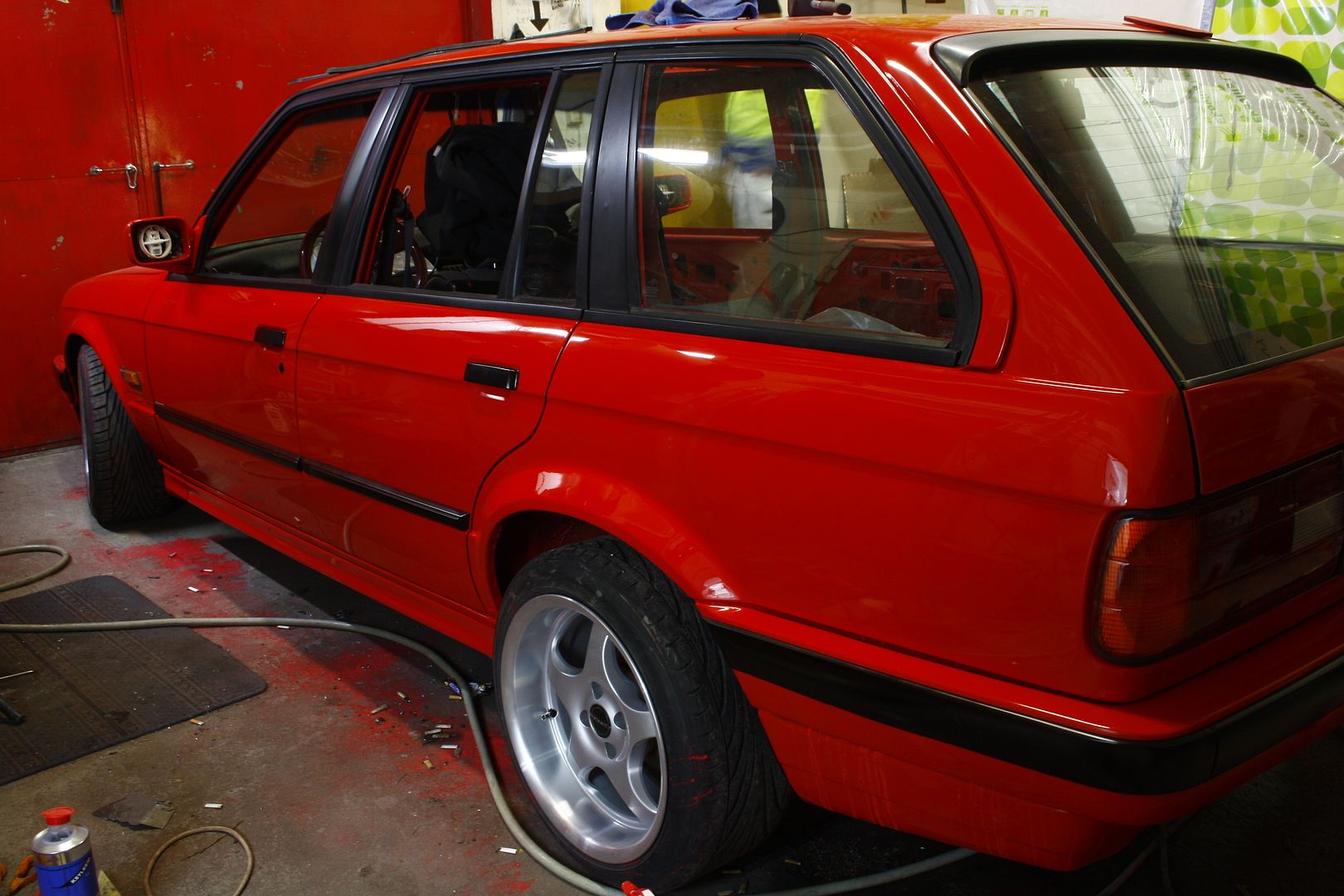

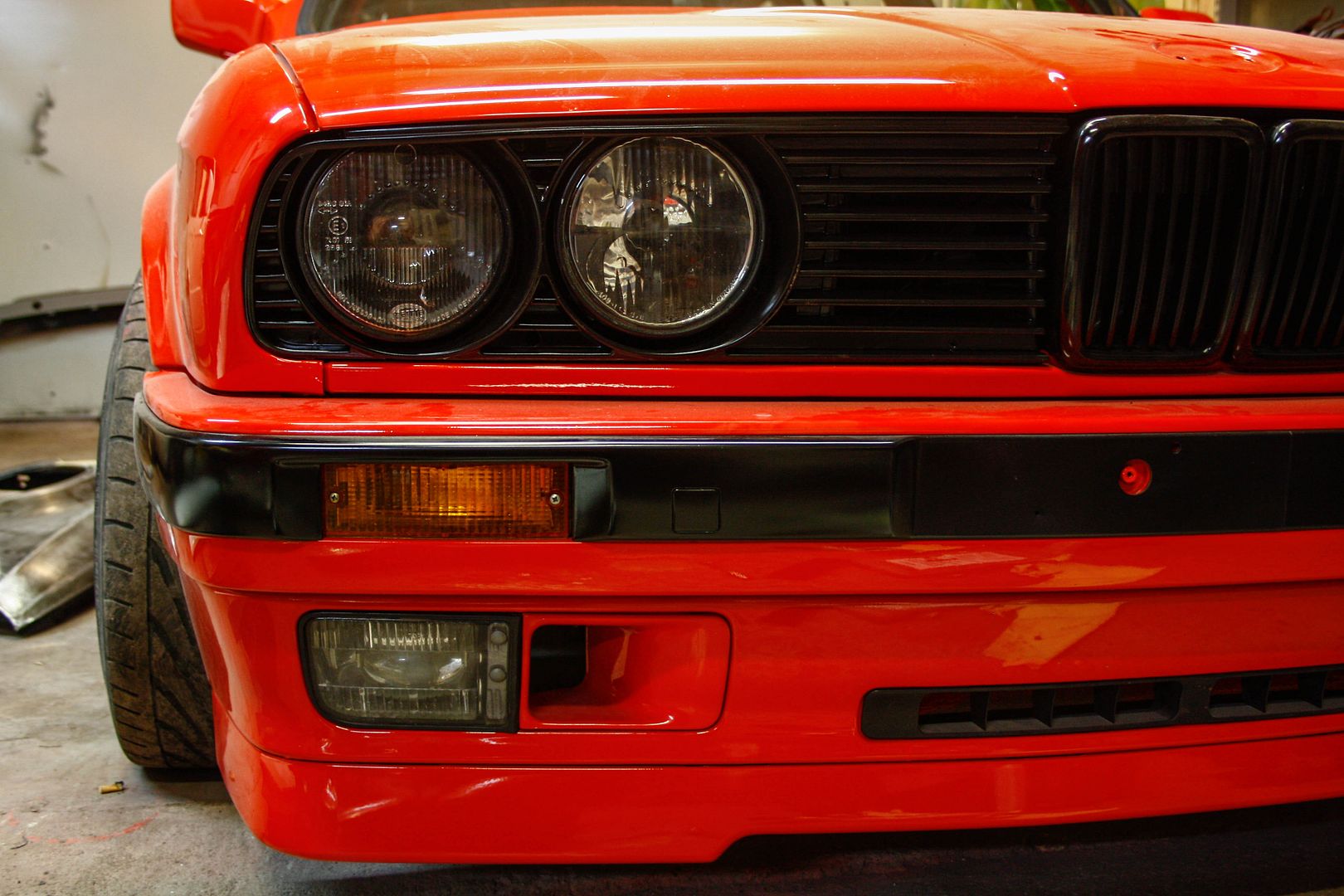

          New windshield installed
          All the trims and sideguards etc got a PPG:black basecoat ja DP8177 semigloss clear.
          Photos are sadly taken too close because theres no room to take a long distance photos in the garage and theres a lot of snow outside so i cant take the car easily outside it would get stuck in the snow with those tires on :(
          I have a pair off MHW black tails but ive been now looking the car with stock tails and i think im going to keep them on because its looking so much lighter and fresh with the shiny new red paint!
          But the front end is gonna be assembled with this combo.
          The original Carrot indicators and black headlights.

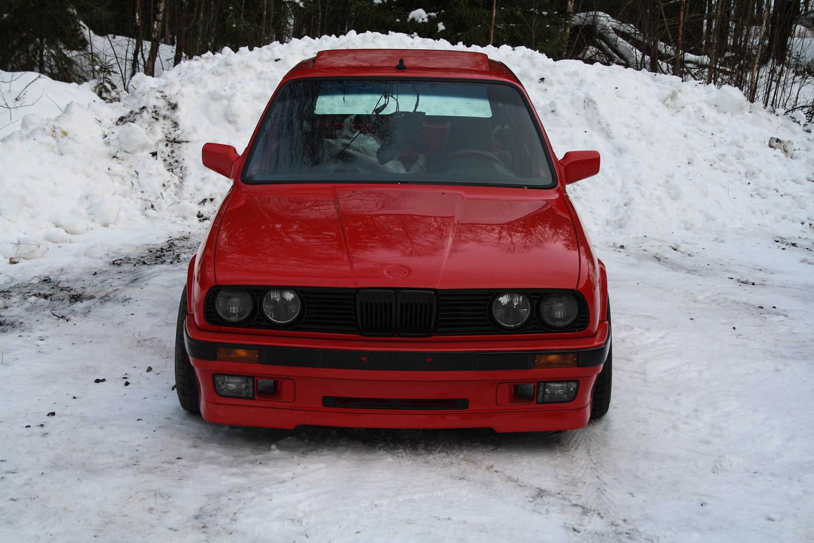

                  Took the car outside when cleaning garage.
                  took few photos before taking it back in.
                  Disassembling design touring and moving parts to this one is what ive been doing lately.

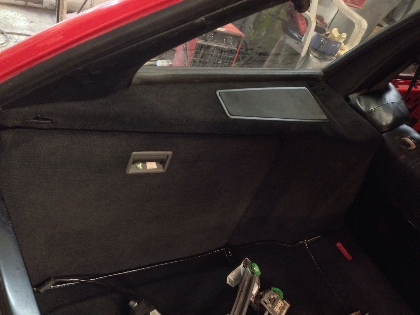

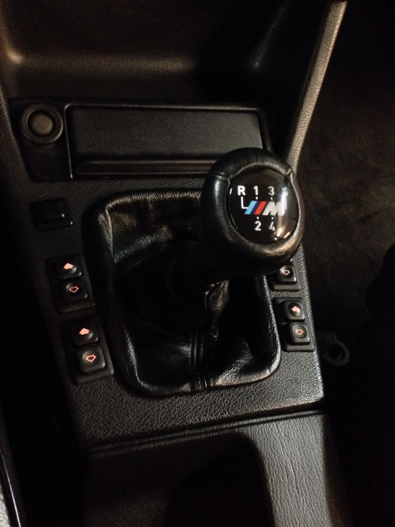

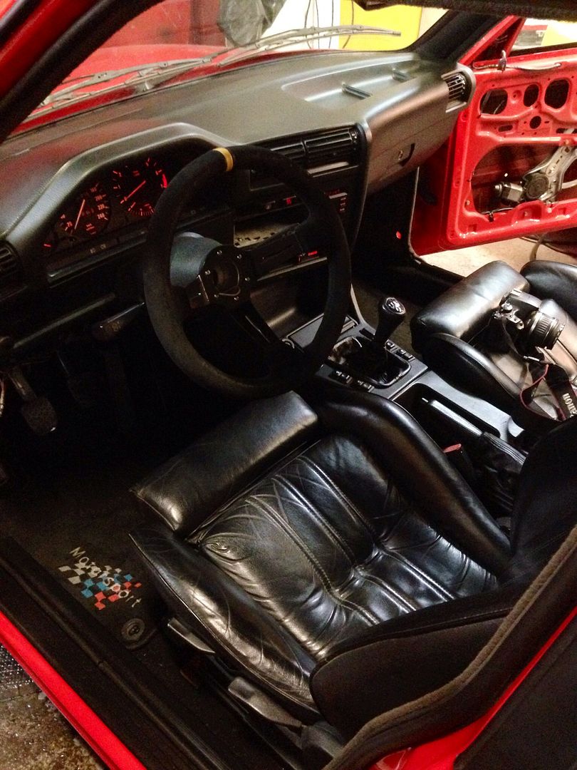

                        Little things here and there.
                        Interior almost done
                        Sorry for the crappy pics
                        And what was installed
                        -locks changed,central locking fitted and works
                        -Front power windows
                        -Rear Power windows
                        -Black headliner
                        -Trunk compartment carpets painted black
                        -Floor carpet painted black&fitted
                        -Sport leather seats fitted
                        -Seat belts washed&fitted
                        -Center Console with all the buttons
                        -trims etc.
                        +lots of cleaning and other stuff

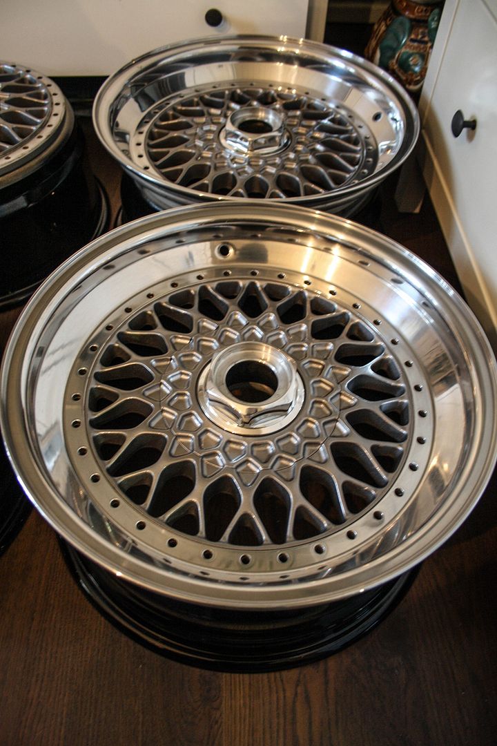

                        And a couple things changed..
                        [IMG][/IMG]

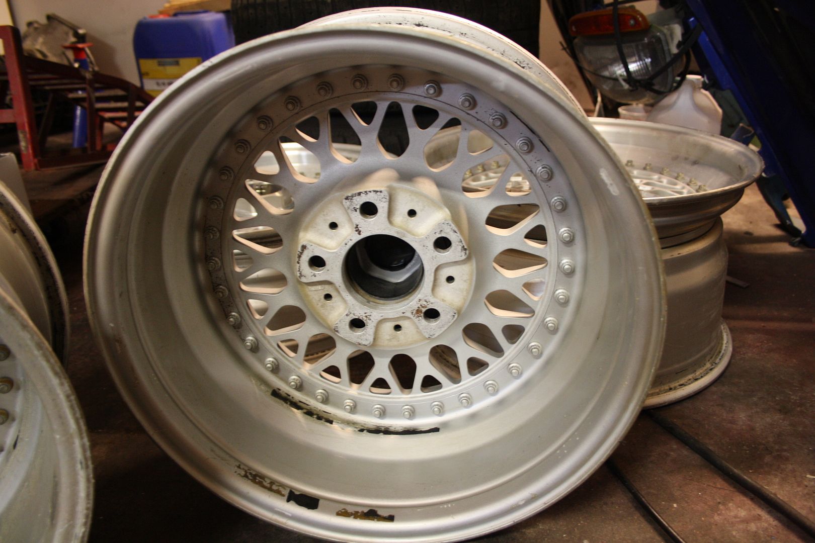

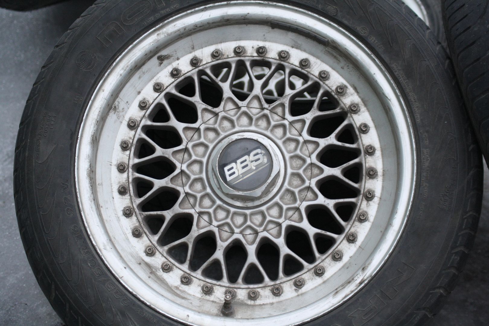

                        Bought a nice set of
                        BBS RS 005 7x16 ET14
                        BBS RS 022 9x16 ET24
                        E28 E23 E24 "rennsport felge"
                        For those to fit straight to this car
                        Needs a little hub job
                        Cure
                        E30 M50 Touring
                        • Osku
                          • 104

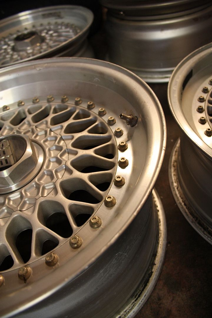

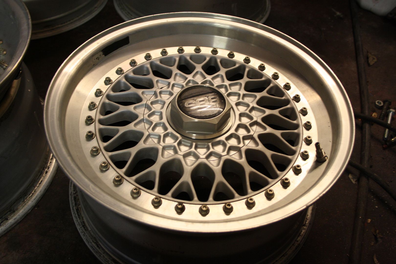

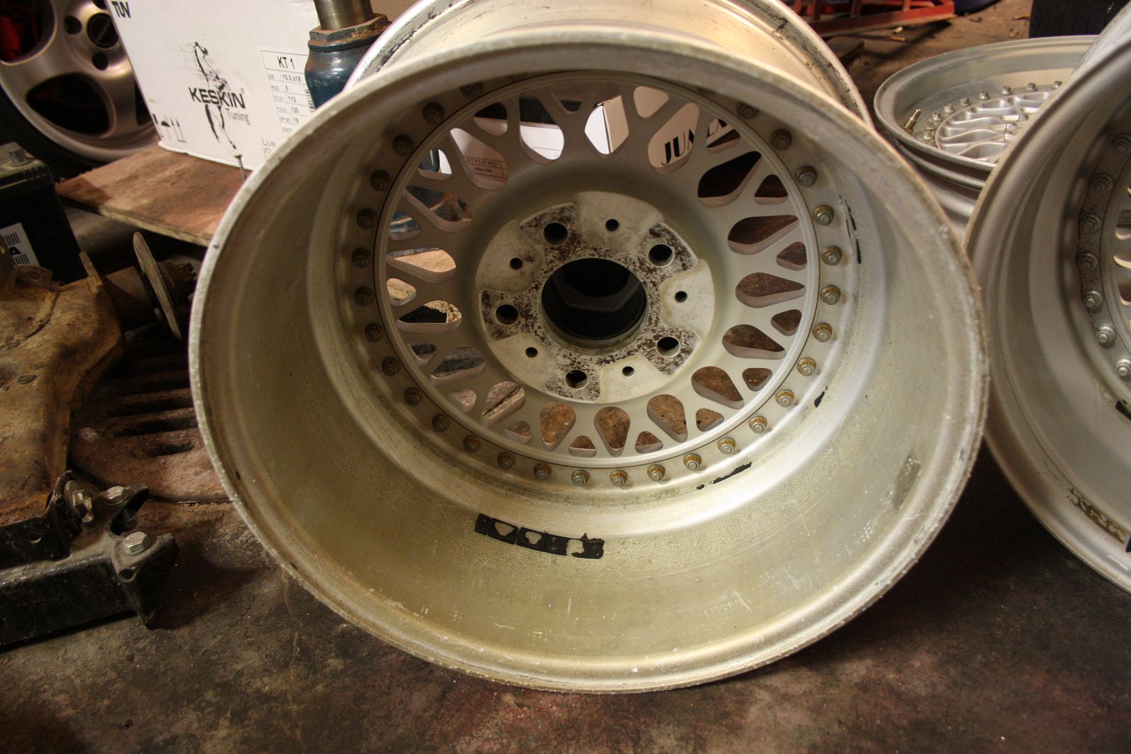

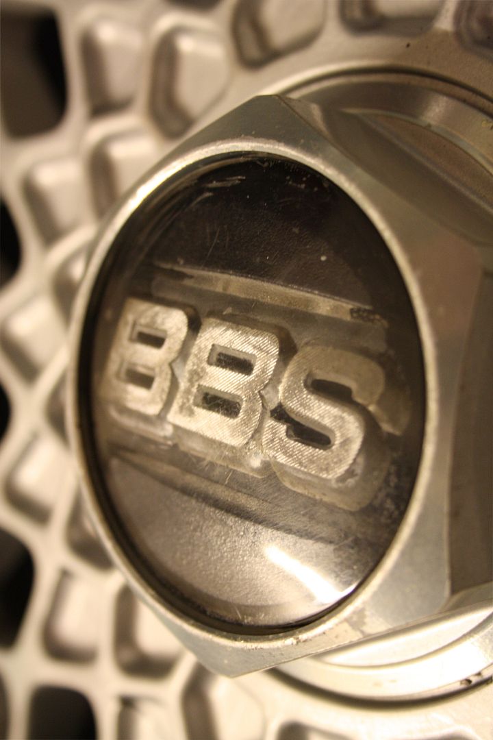

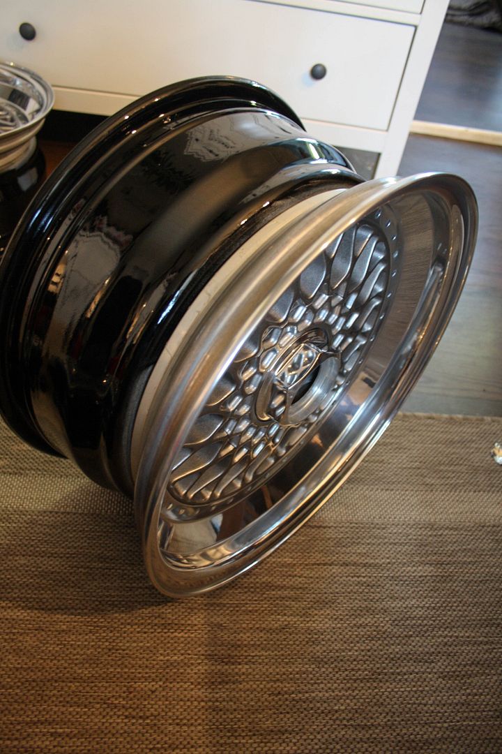

                          #87

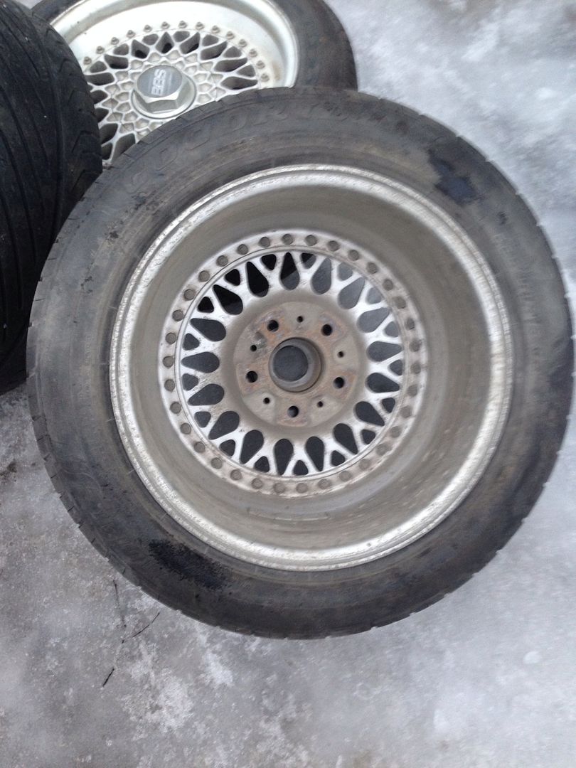

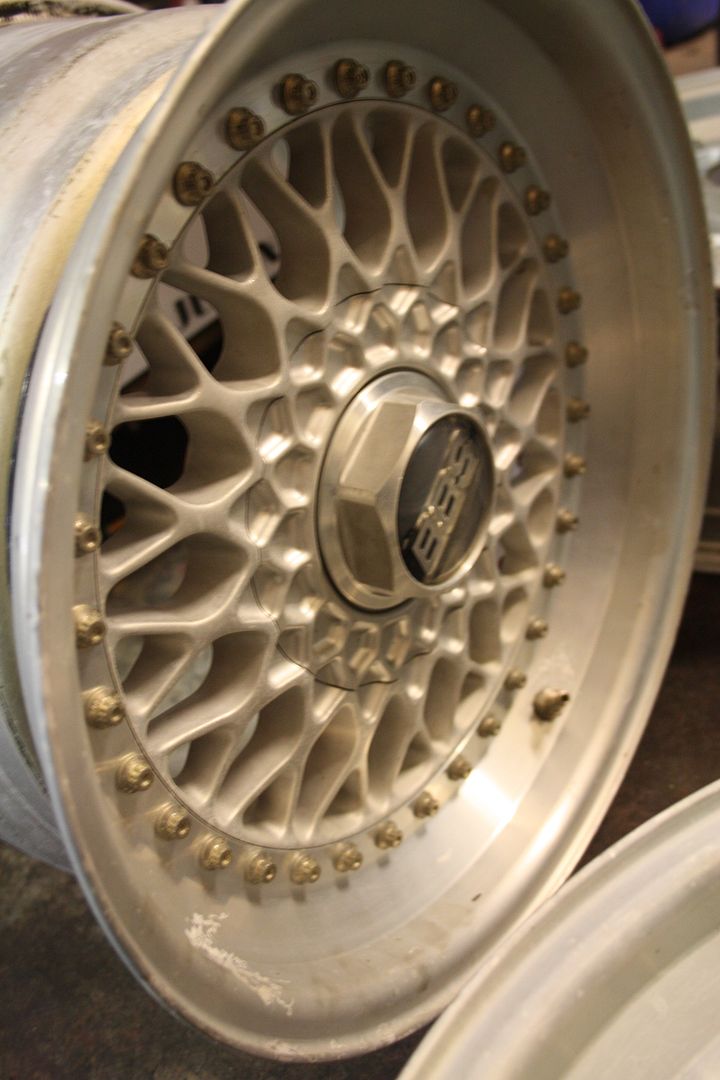

                          Those in the box are Z4 rear hubs.

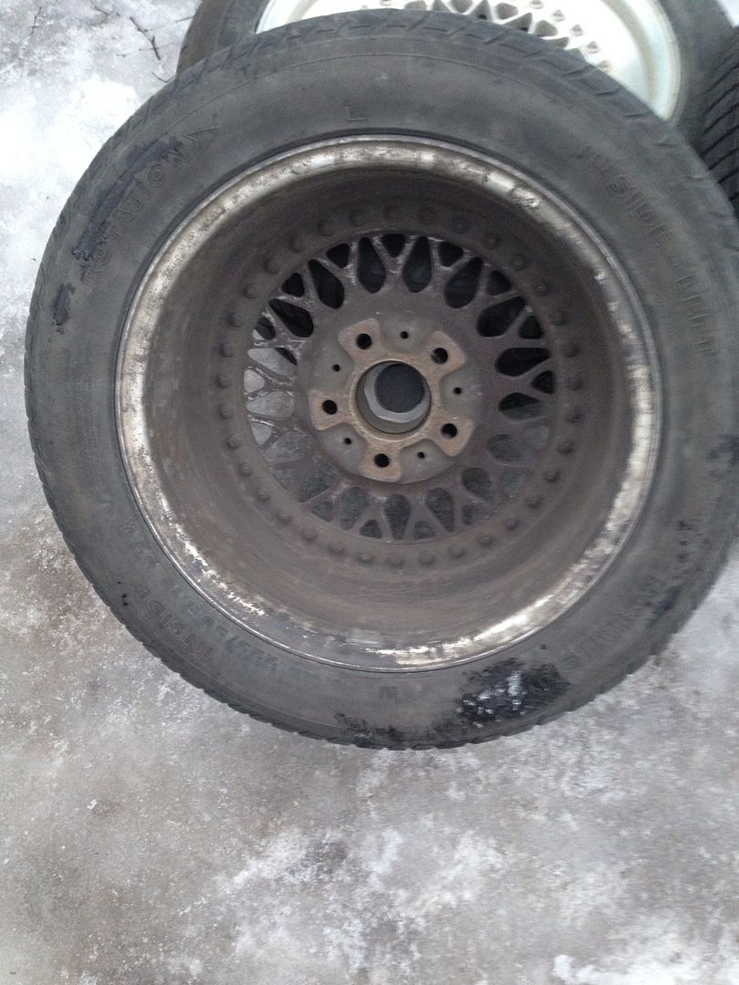

                          Heres a few fotos of the BBS
                          Solvent,wheel acid lots of cleaning later..
                          Lots of sanding polishing and other fixing.
                          E30 M50 Touring
                          • Osku
                            • 104
                            #88

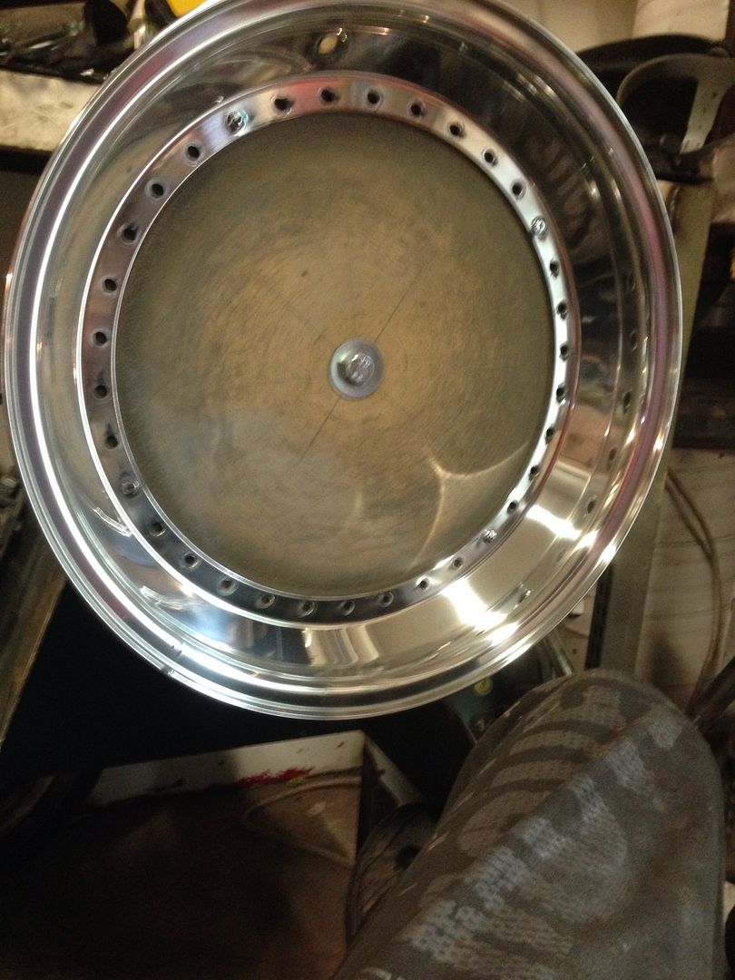

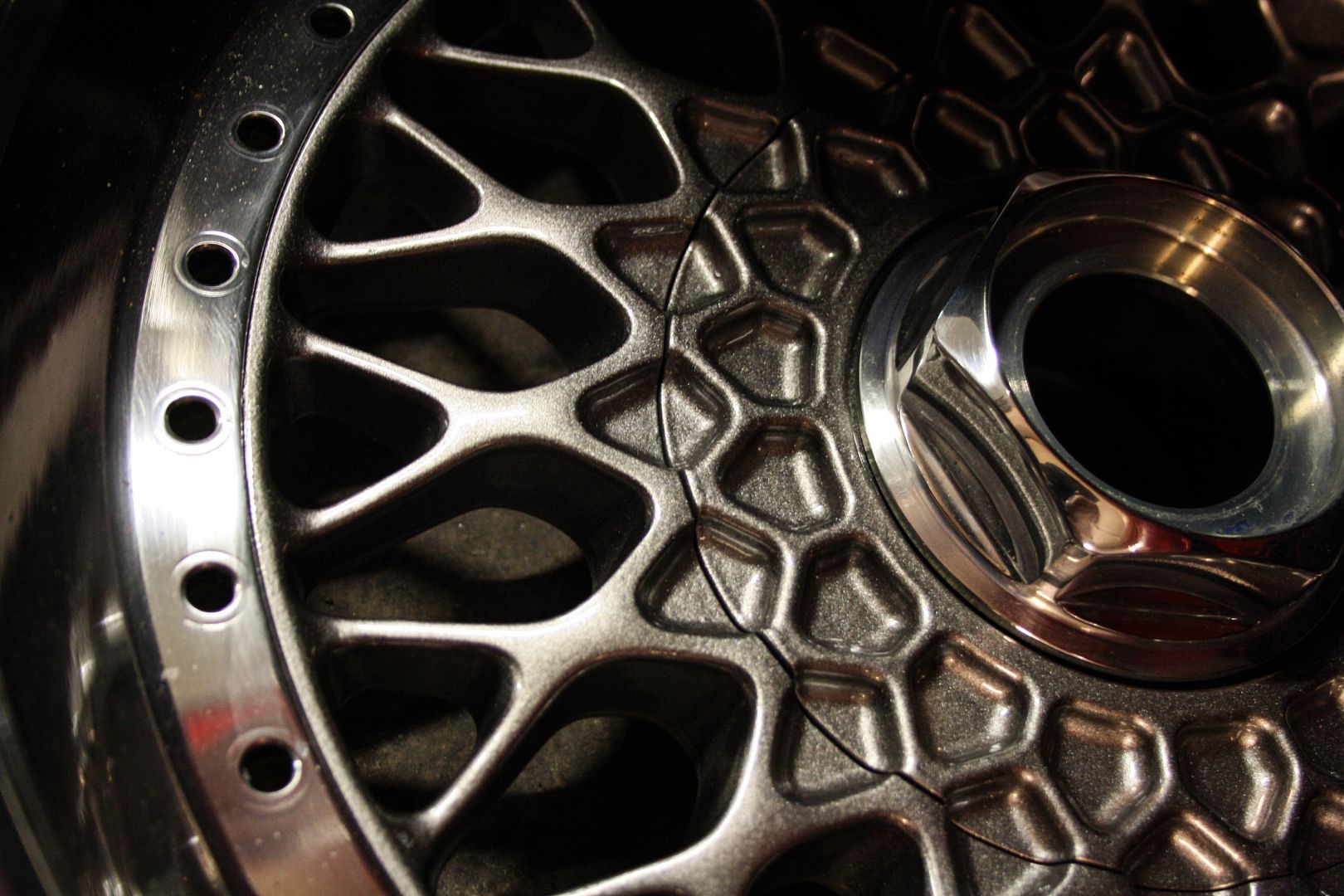

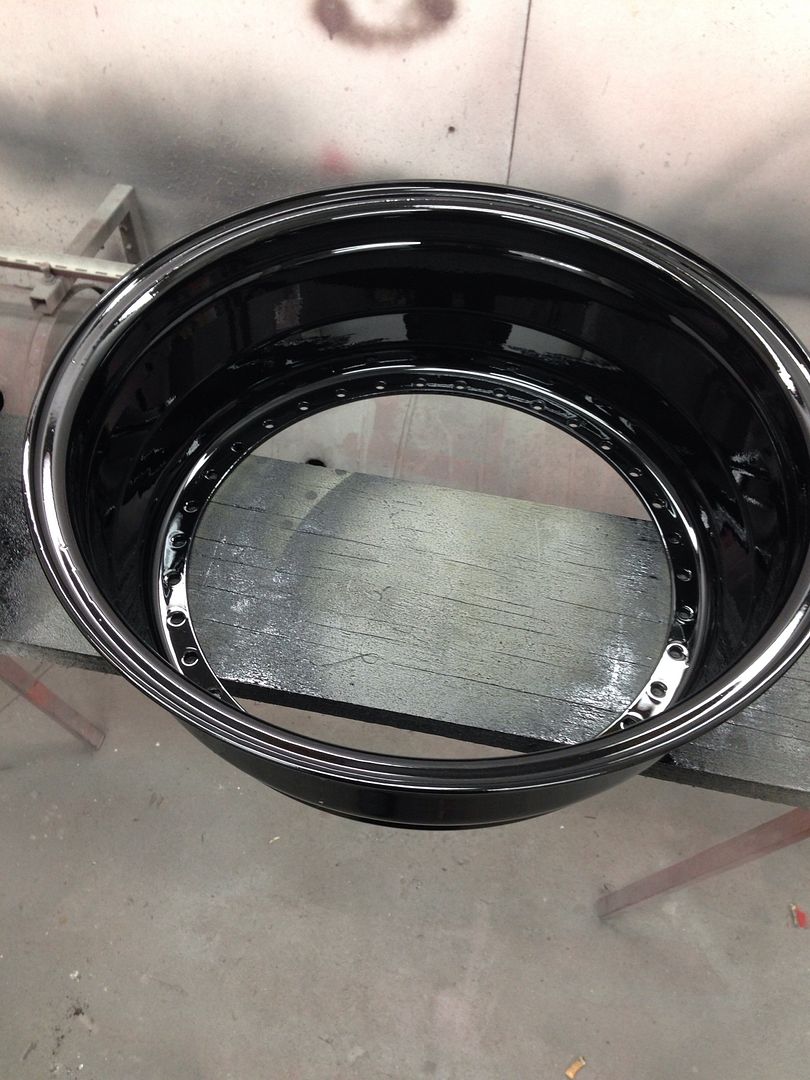

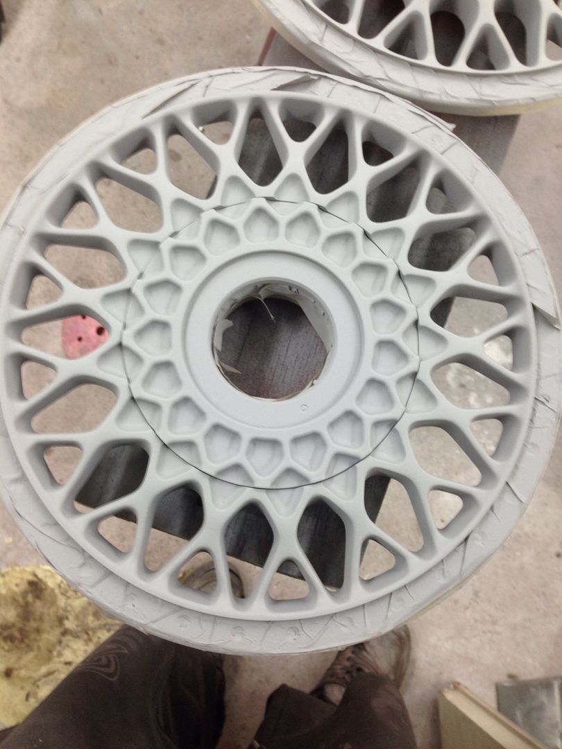

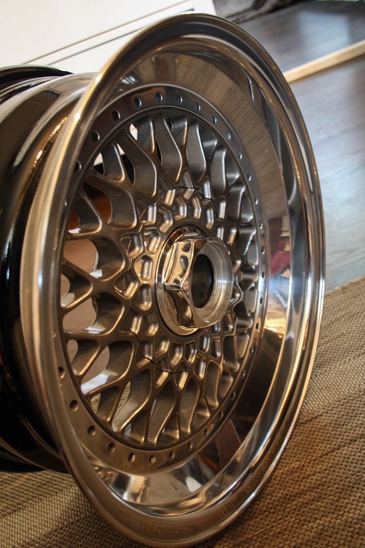

                            Painted the faces,carefully sandblasted
                            Few coats of primer
                            Little bit of fine sanding
                            for the shade of the wheel faces i wanted some platinum looking nice grey so i mixed a little pearls into one good shade of grey
                            Few hours of painting the basicoat& 2 coats of clear
                            inner barrels painted jet black with one coat of 2k acryl paint.
                            All parts painted took them to my home and thought that the rear wheel outer lips are good in front and rears are gettin 0,5" wider outer rings.

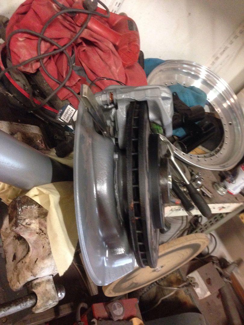

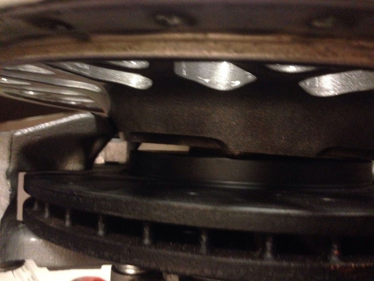

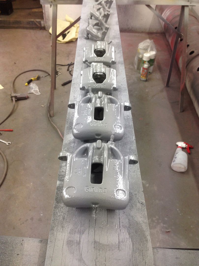

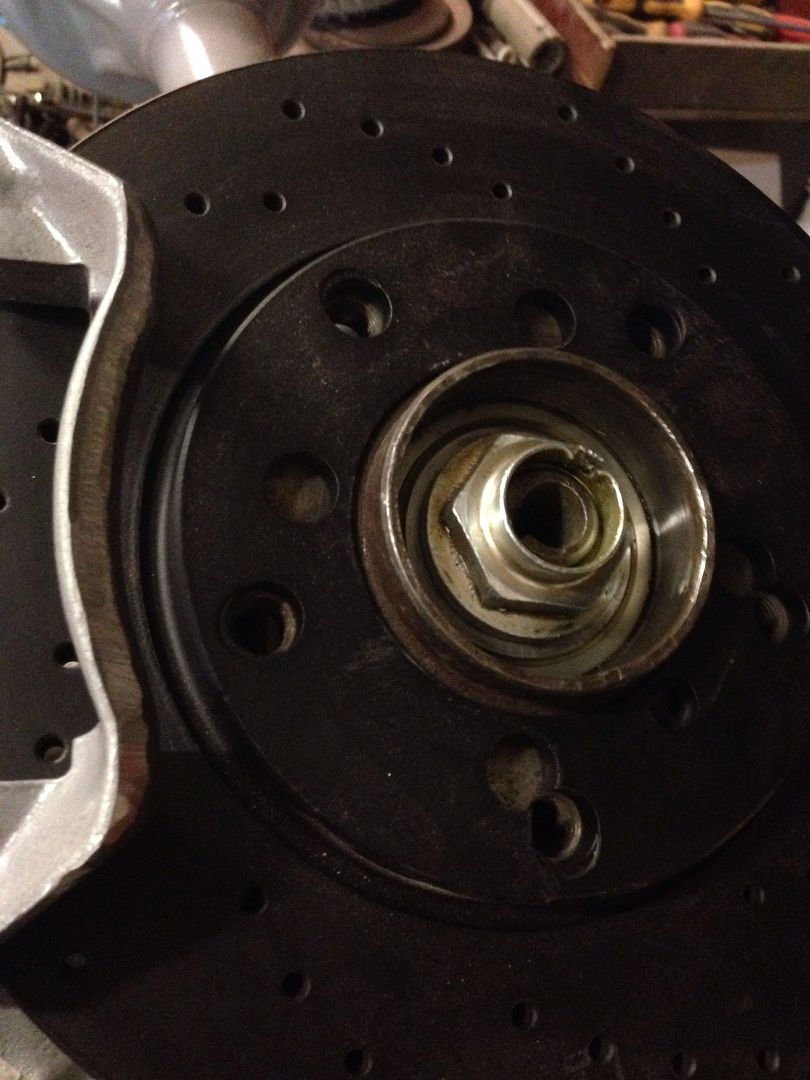

                              Brake calipers restored and painted,all the front&rear-axle parts sandblasted and painted with heavy duty "industry" paint.
                              Test fitted the front end parts,friend made fittings in the lathe for E36 front hubs.
                              Brake discs were machined too to fit with new hubs.
                              And because sun is getting visible and spring is coming i had to do few other projects to friends..
                              One nice color for a fighter GSX-R
                              little problems with new hubs&stock brakes+BBS
                              So take the "special" tool and make it fit,because i dont want to put spacers.
                              Now it fits nicely!

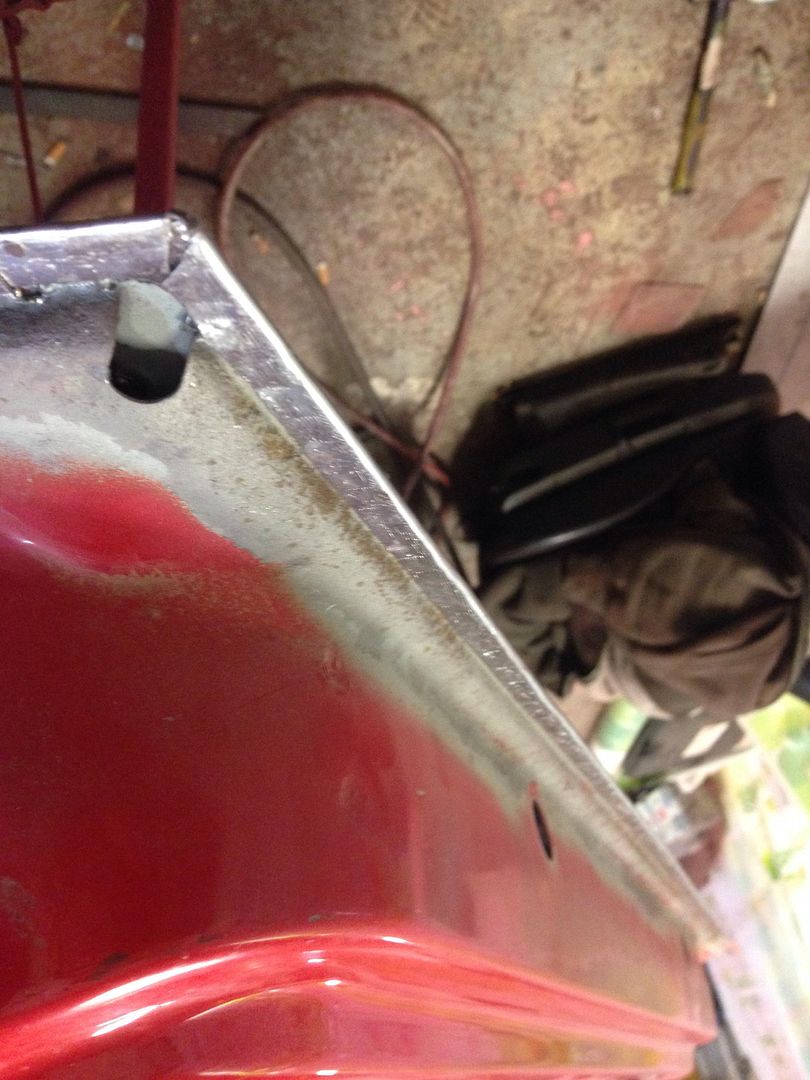

                              Little more job on the underside of the car needs to be done like the fuel tank has some rust issues,paint the wheel arches and make the underside look nice.
                              Change all the axle parts for these that i refurbished.

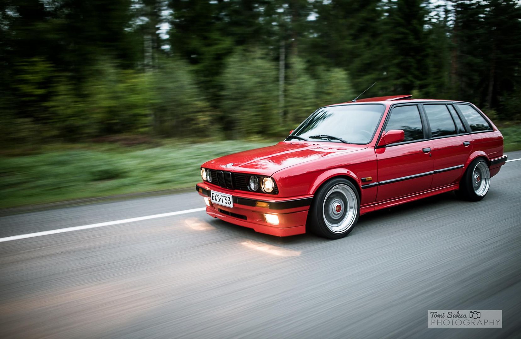

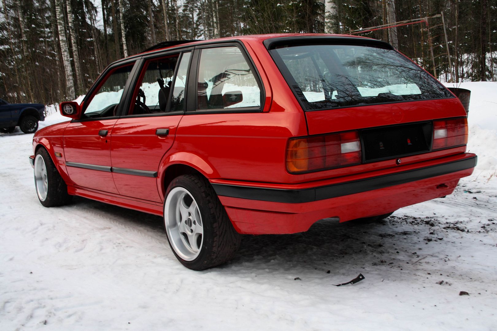

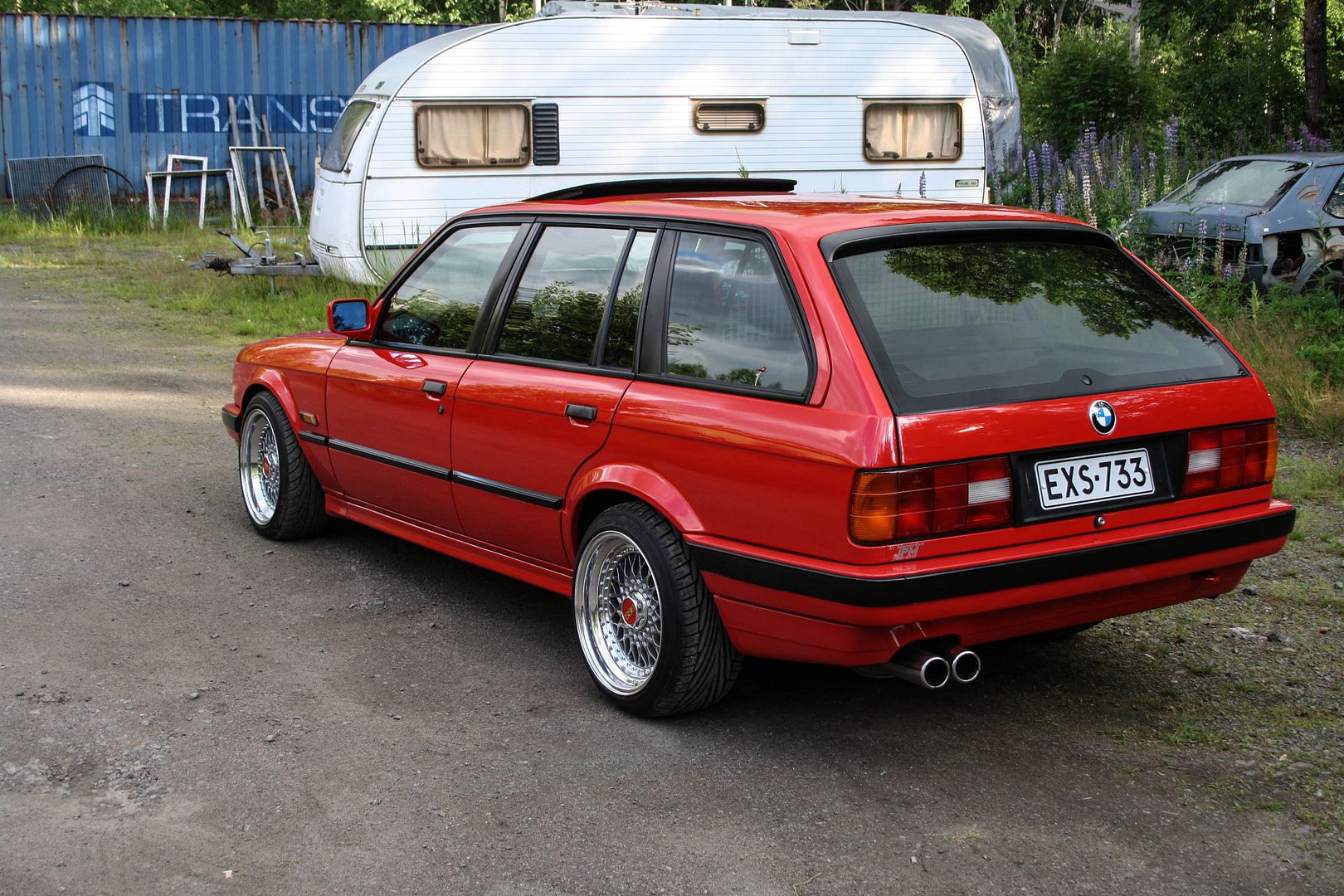

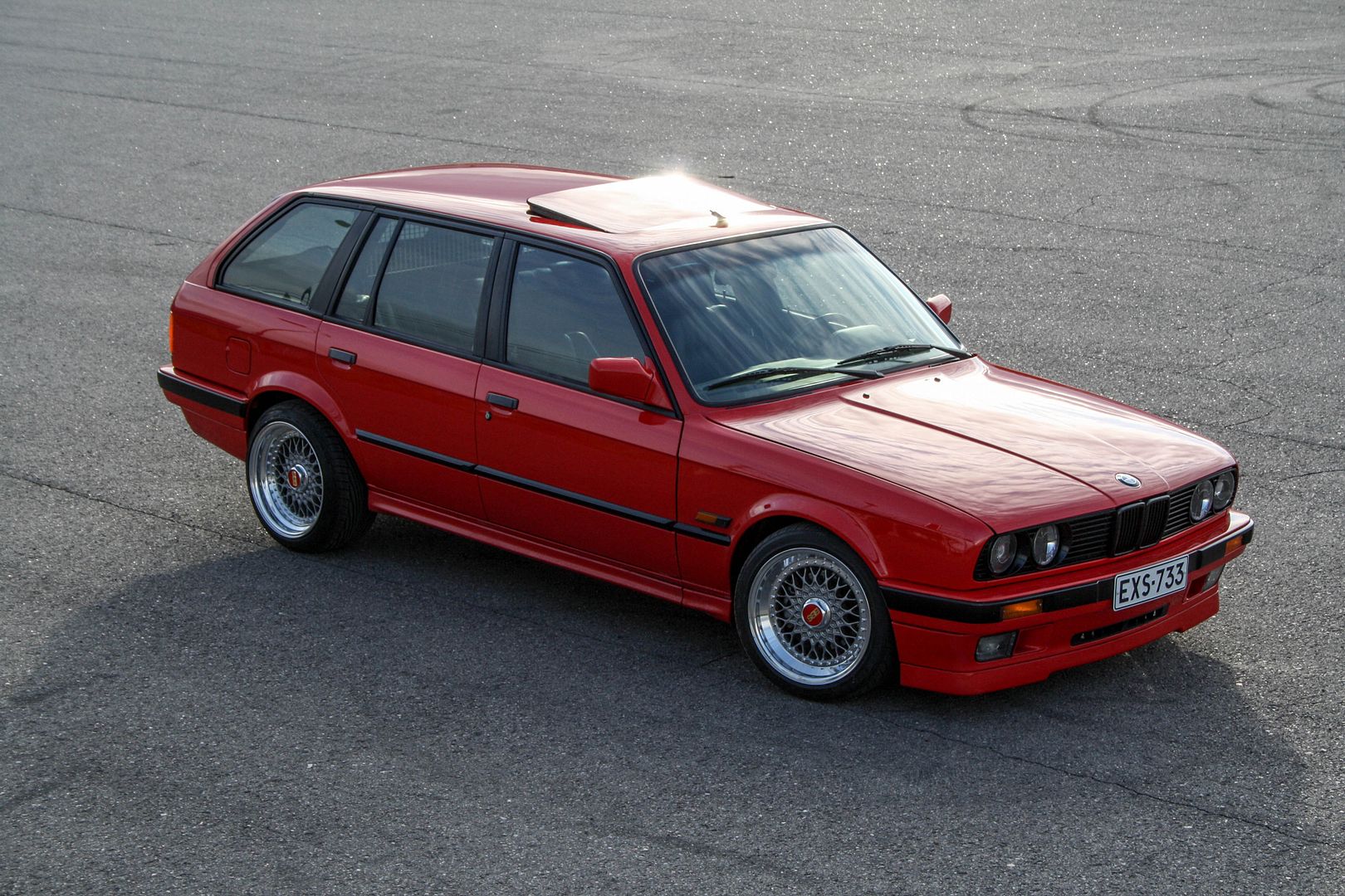

                                Long time no posts..
                                Been busy
                                ENJOYING THE DRIVING WITH THIS E30

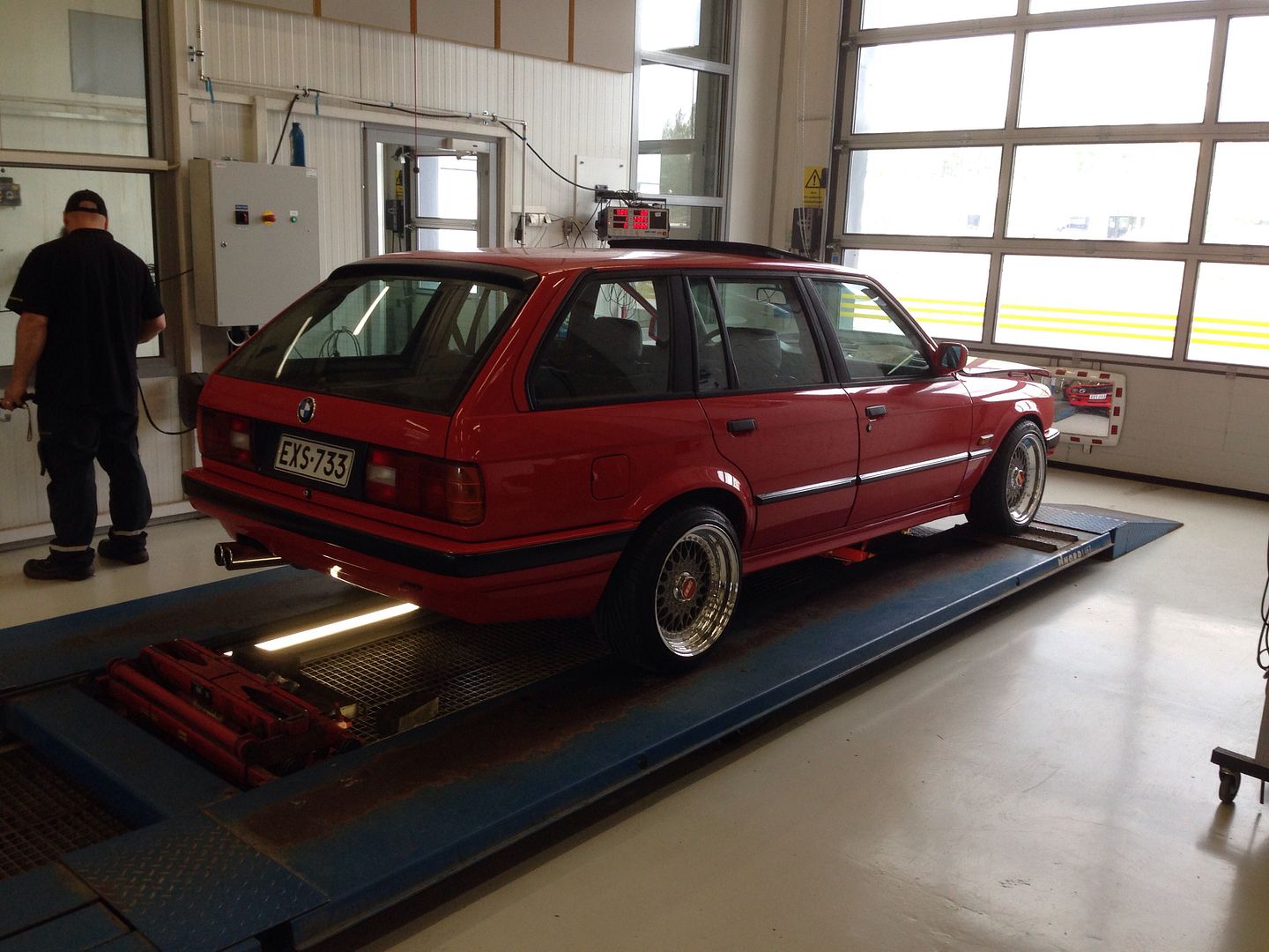

                                Car was assembled during summer,got thru the "registration inspection" and now ive rolled over 3500km with it and everything works well.
                                Few photos from this summer driving season,car is soon going to go to garage wait for next summer,i dont wanna drive with it during wintertime.
                                From the first drives that was driven,rear was a little too high at that moment.
                                At the "inspection center"
                                Few shot from Bimmerparty
                                The biggest BMW event in skandinavia i think..
                                "Speedrace"
                                1/4 Mile just driven for the fun of it.. not so good time
                                Few driving shots taken by my neighbour(<-- that is supposed to mean the person living near me) he is so enthusiastic to photographing he wanted to take speed photos of my car.
                                Ill add more fotos when i can collect a bigger set with good quality,sorry for the lack of interior pictures yet.
                                Feel free to comment ;)
