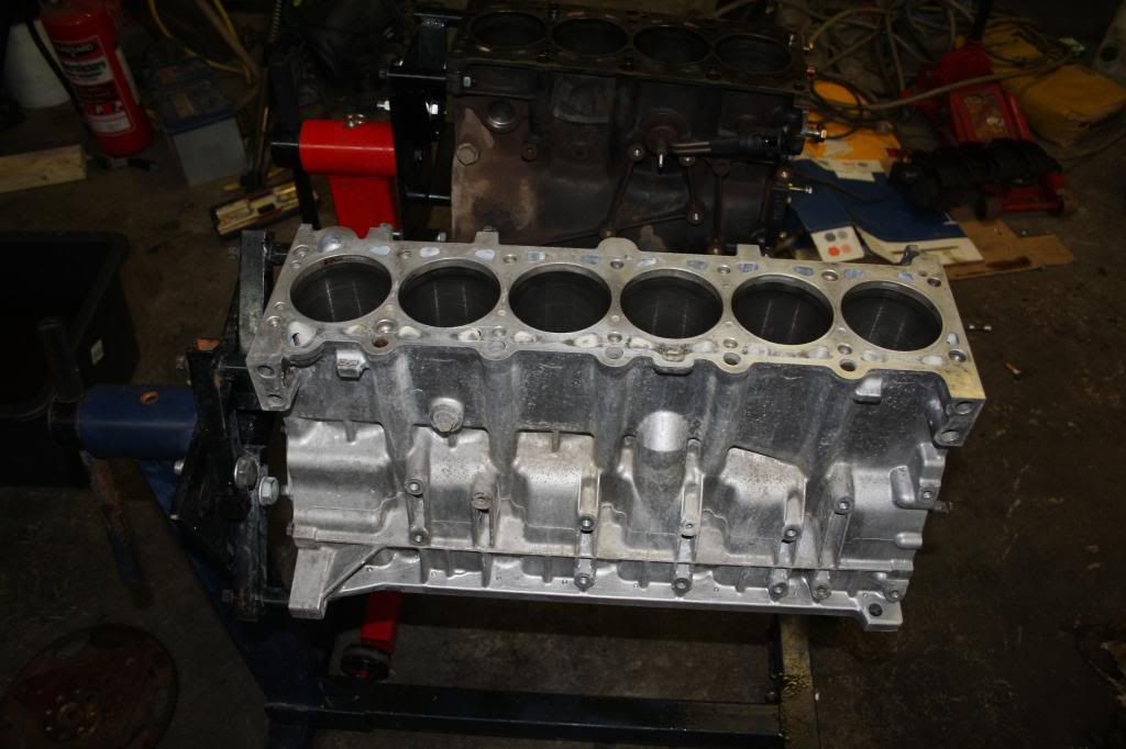

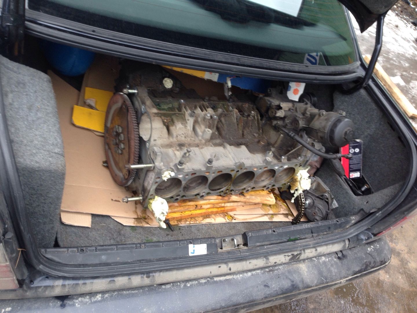

                So i pulled the engine out and decided to "fix it" a little..
                idea was to change the Crank from 2.8,make a restoration for the hole engine etc supposed to do a high compression "M50B28".
                As i started to tear the engine apart i was amazed how worn the hole engine was.. i was wondering how it still had stayed "running on"
                No hope for the steelblock the cylinders were so worn that it was easier to send it to junkyard..
                I started to look something littlebit lighter and powerful.
                Bought a M52B25 alublock and rotating assembly from E39
                With my little brother on one afternoon took the E39 engine out and lifted it to my E34 sedans "winterbeater V8" trunk
                laughed to 14 cylinders in one E34.
                The engine itself block is 22kg lighter than the M50B25...
                In few hours the engine was teared apart.
                Then i bathed the engine block in hot water and solvent so it became clean from all the brown stuff inside.

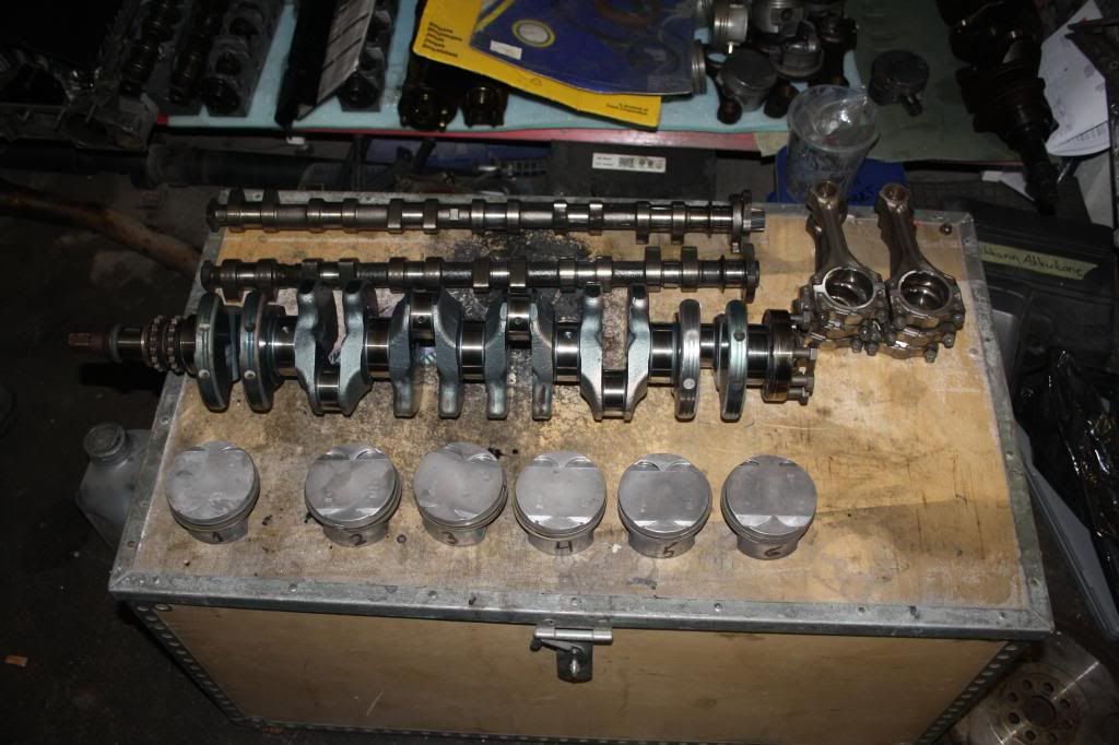

                So the block was good enought and i got the pistons on it to make even little higher CR than with the steelblock and pistons.

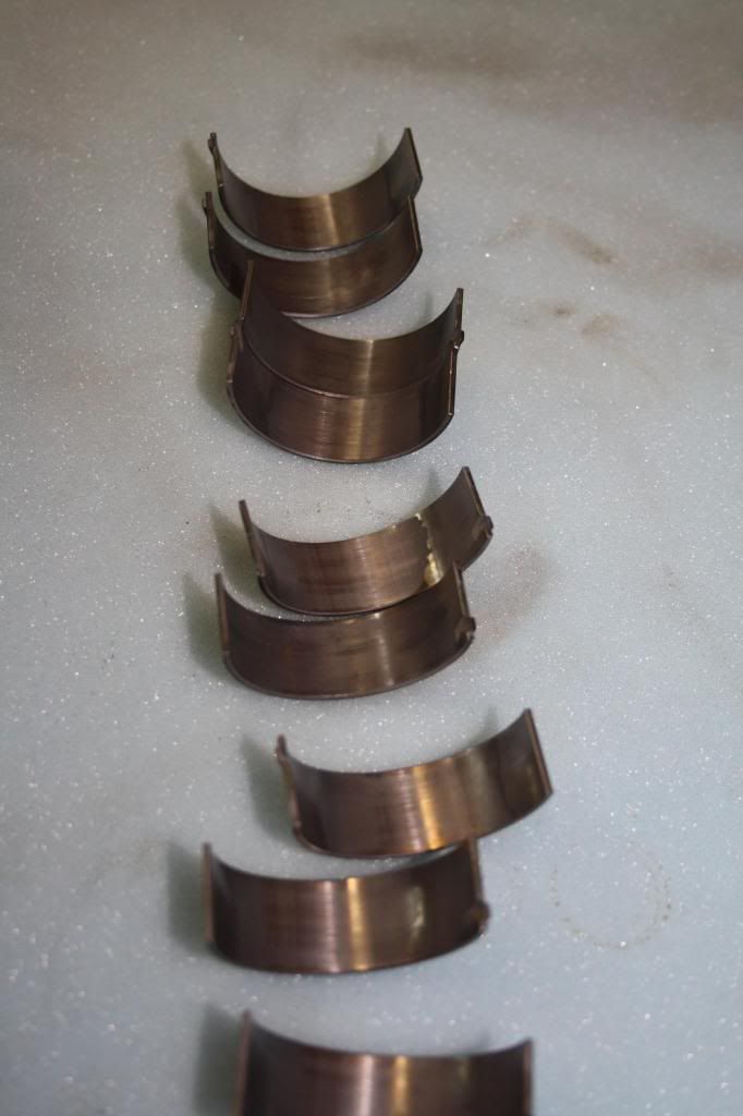

                So heres a little view at the parts that are going in
                M52B28 forged Crank "smurff blue"
                M52B28 connecting rods
                M54B30 intake cam
                M50B25 NV Intake cam to exhaust side
                M52B25 Pistons (from Nikasil alublock)
                Block washed and lifted to enginestand No friend needed!!

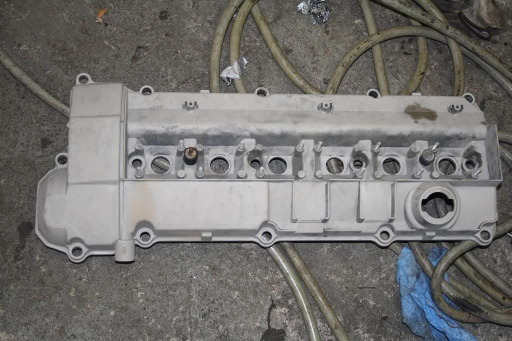

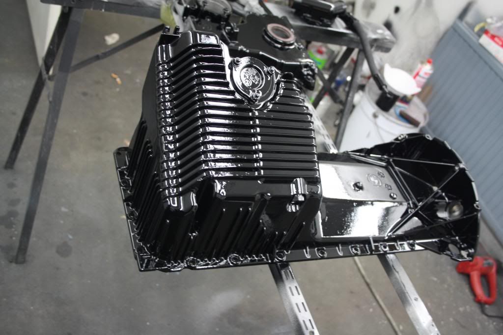

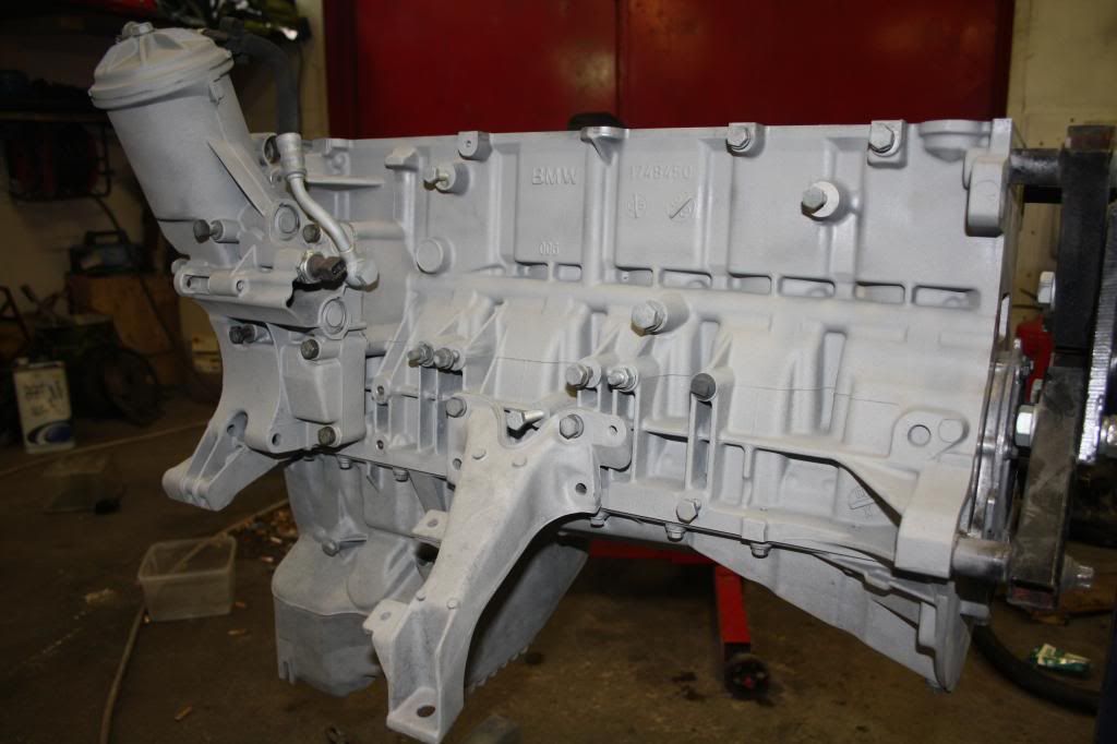

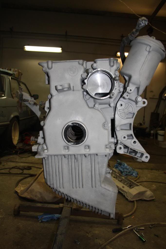

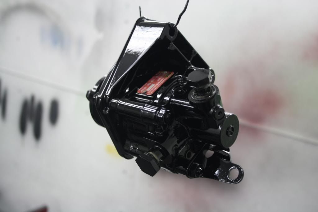

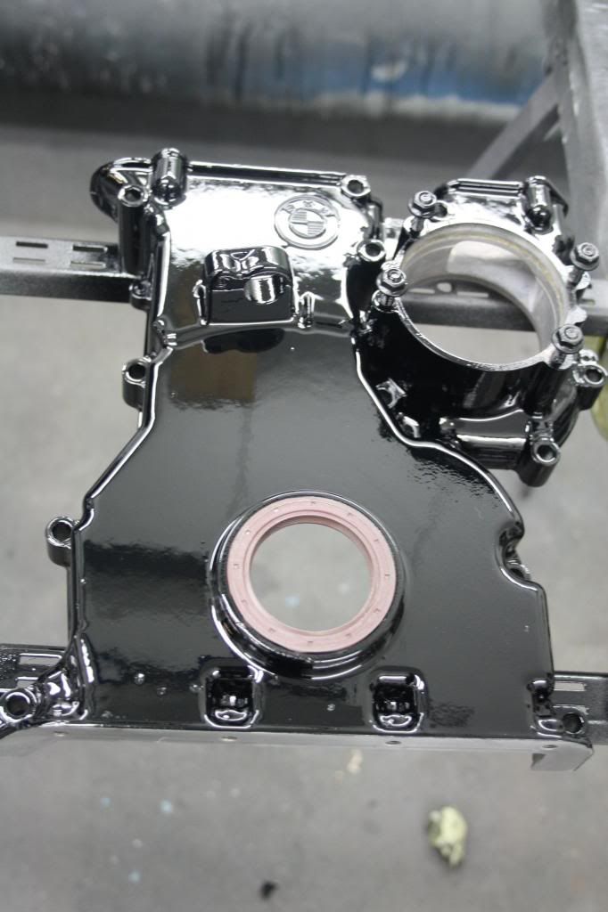

                  Assembled the covers,taped all the critical places and Sandblasted all parts.
                  Prepared for the wash primer soon that the aluminium doesnt "oxygen" or whats it is called..
                  After washprimer i srayed a nice coat of jet black 2-k acryl to the parts.
                  Aluminium "older 24V type" Thermostat housing.. Wont break like the plastic ones..
                  E34 oilpan
                  Valve Cover
                  All the other engine "stuff" were painted too.. including,startmotor,powersteering pump,alternator (pretty nice job to disassemble)
                  All the guys in our garage laughted to me when i said im gonna paint all the parts as good as i can.. Came up pretty nice..

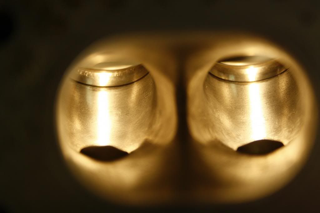

                  I did a little (40-60H) dentist work with the Cylinderhead.. Hope its gonna give me something in response
                  Exhaust ports are Smoothened and polished.
                  50/50 shot
                  Same job at the intake ports,these i left them a little more "rough" so the gas wont make drops in the channels.
                  Finished intake ports.

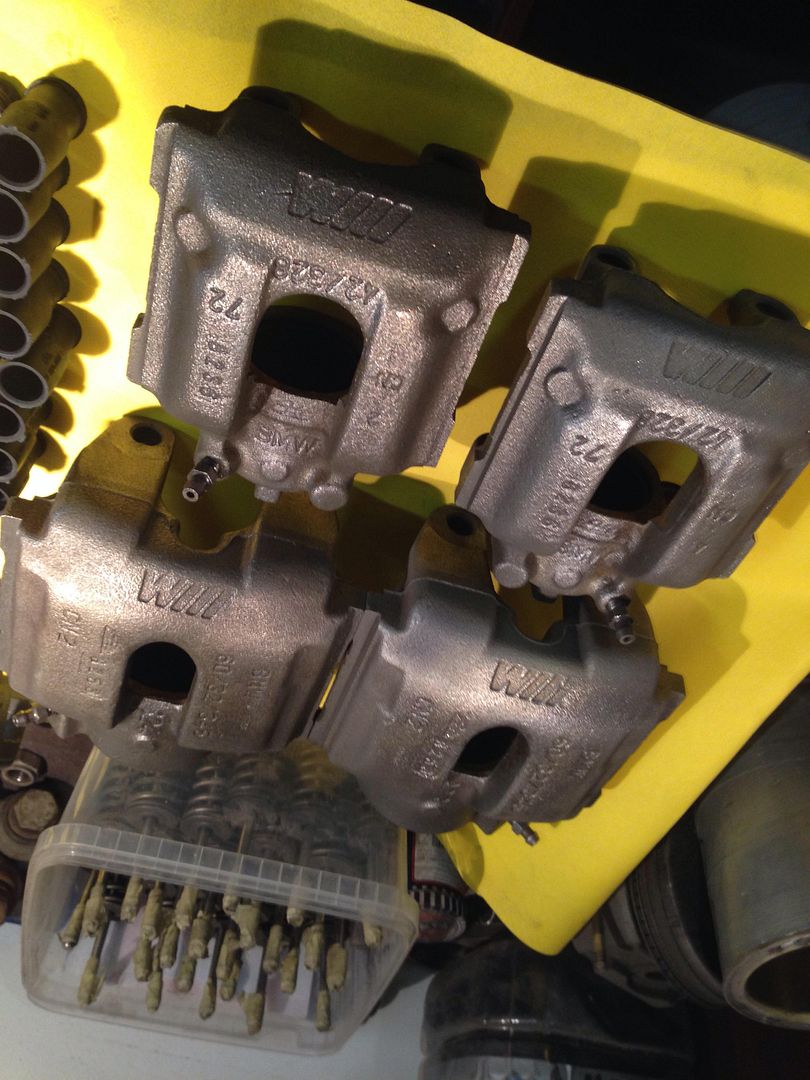

                      Few more bolts to the wheel studs.. more power to brakes and a few other mods..

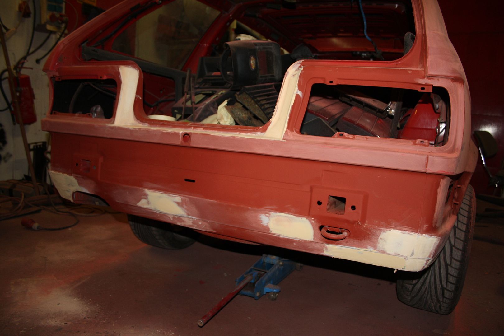

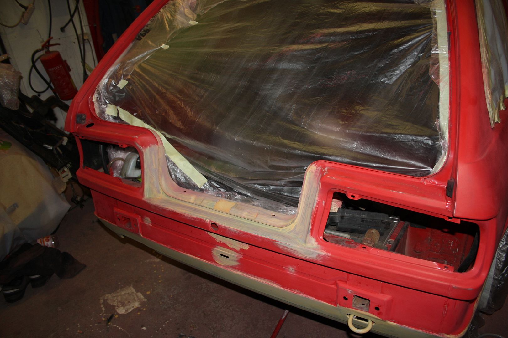

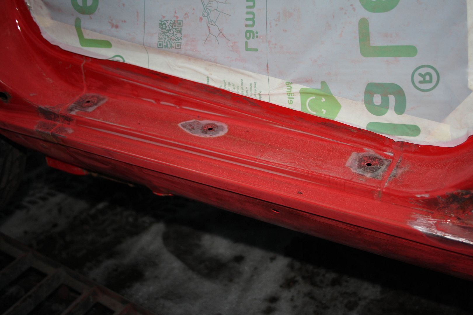

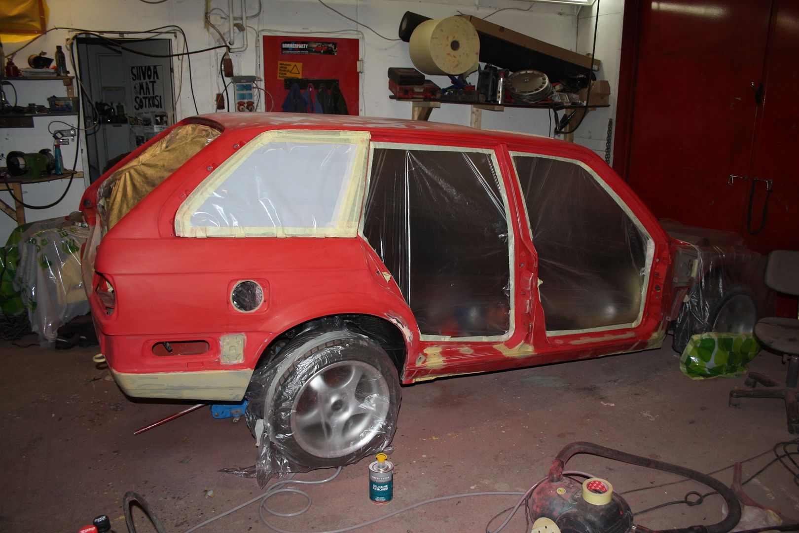

                                Been working with the Brillantrot
                                Prepping work for painting,little rust issues got sandblasted.
                                The "cargo hauling gap" or whatever you like to call it needed to be replaced,repair pieces from another car and welding,grinding,sanding.
                                Finally it was filled with a body tin(dont know what you guys call it) but with a torch and wooden piece it was applied. then a little bodyfiller and it was good to go.
                                Only 4 spots beside the cargo hauling area on entire body needed to be welded,guess i got lucky this time.
                                Suprised by a winter a little snow doesnt harm no one.
                                Notice my littlebrothers "stress toy" E21 in the background 430bhp/550nM torque..
                                (Stock M42B18,SwitzerS200turbo,MS etc Runs on Ethanol)
                                When its about the time his gonna get a burnout from daily job this machine makes a perfect job as an antistress rubber punishing therapist!!
                                Etch primer(rust prevention) to the bare blasted spots.

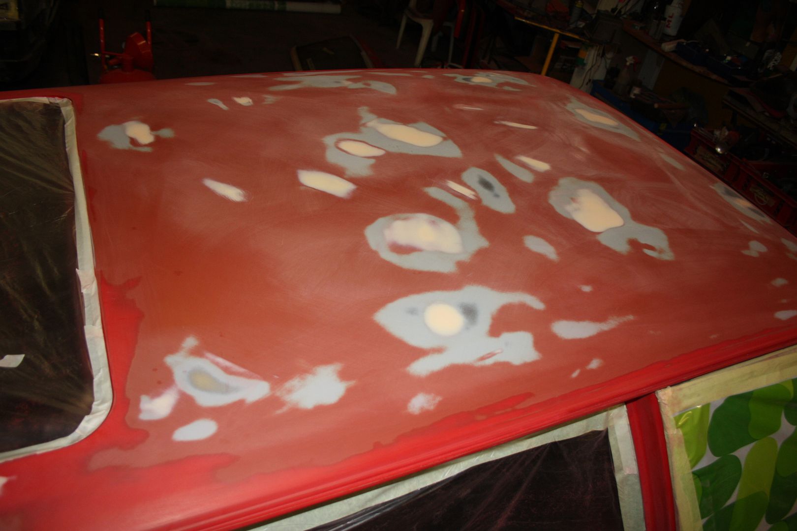

                                Little bit of bodyfiller and lot of sanding,sanding,priming and all the prepping work took almost 200hours.
                                Roof was one of the biggest issues.
                                25-30 litttle Dents all over(caused by "icerock" storm) and few bigger dents.
                                Will be adding more photos to this thread at the next post
