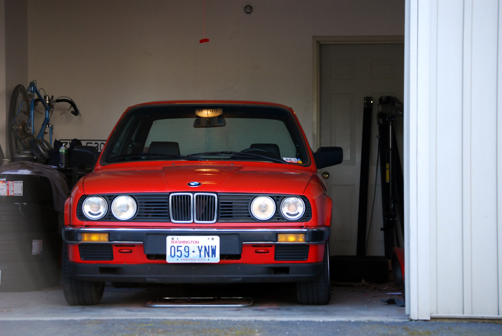

          Nope, I'm going with the complete eta intake.
          I know that it will cut flow, but for one, its what I have available and, two for some reason I really have the desire to build as good a motor as possable yet make the thing look as completly stock and mundane apperance wise as I can (aside from all the euro accoutrements). I want people to ignorantly look at my car as 'just another eta'. That may sound wierd, but it sounds good in my head.

            #140
            very very clean and well done car man !
            i love the valance

              Good work! Really nice example you got there!

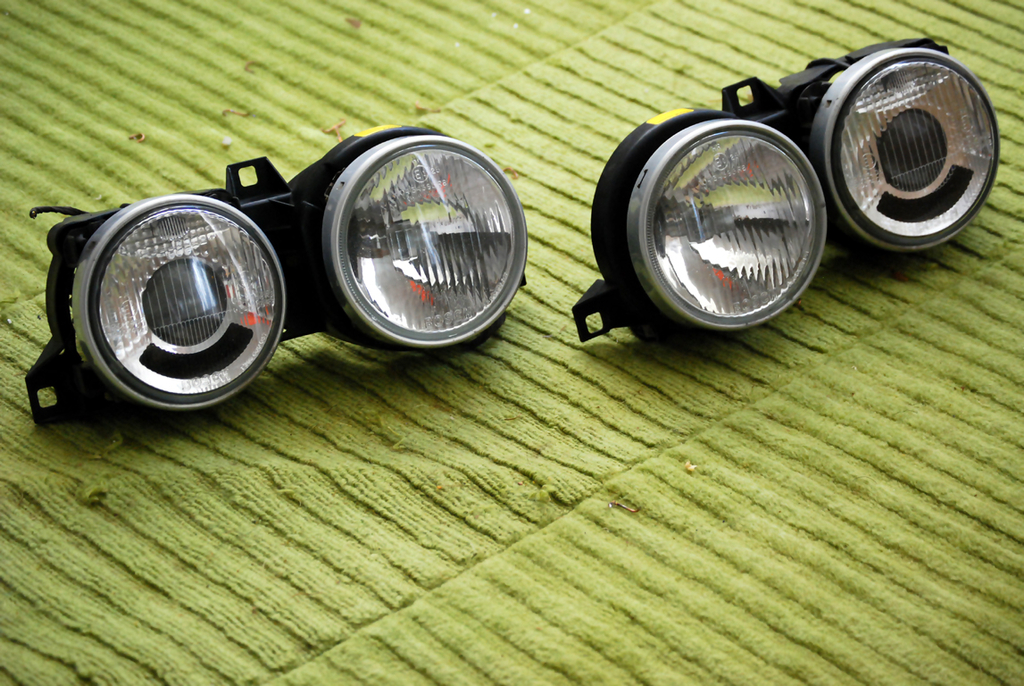

                Smilies!
                My Bosch Smilies came in last night and I got them all mounted and wired this afternoon. Unfortunatly one of my city-light and one of my high-beam bulbs are burnt, so I guess I can't really verify my work on those quite yet. The rest work great though...

                  Pretty, man. Simply beautiful.
