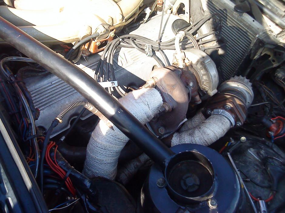

Engine:
-block has new bearings everywhere
-pistons is turn in a lathe at top 1.3mm off
-Head-gasget is a 2mm Mass gasget
-Compression ratio 8.5:1
-Megasquirt is for gasoline injection for now,but someday it´s gonna drive ignition also.
-HKS 46mm wastegate
-KKK k24 turbo (way too small)
-311cc injectors (way too small too)
-3" downpipe and hole exhaust pipe
-Copper clutch
-"Chinese" intercooler (60cmx30cmx7.5cm)
-Innovate wide-band lambda
-Walbro´s second biggest fuel pump
-adjustable fuel pressure regulator
-Getrag 260 with E36 ///M-3 shift axles (really short) :)

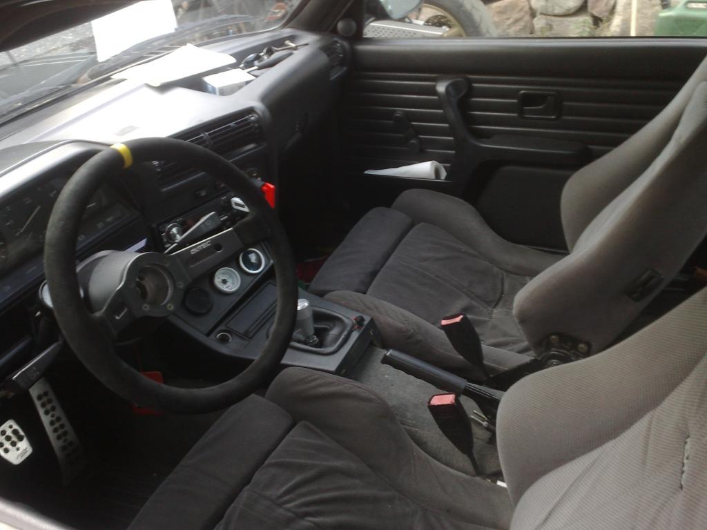

-Cosworth sierra front seats
-Momo steering wheel
-Boost,oil pressure,water temperature,air/fuel ratio gauges. first 3 gauges are Hartge´s original stand in front of ashtray. air/fuel gauge i´m gonna put in center consol where is original clock (right side of stereo)

First Dyno run give 0.5bar (i think 7.25psi?) 219.7 bhp and 293nm torque
car has been driven 1.2bar boost (i think 17.40psi?) now about 7 months,and have no problems.
i bought this car month and half ago and now i have allready been used to this power.
so i have now bought new 442cc injectors (should work just fine somewhere round 450 bhp)
i have been watching new turbo since i bought this car,but still havent found the right one.
i have been thinking a lot of a new turbo and my conclusion is Holset HX35 with 54mm compressor wheel and 60mm exhaust turbine.
with this turbo and these injectors and adjustable engine management i hope i get round 380 bhp.
turbo should do litlle bit over 400bhp with 14# outlet exhaust turbine.
and these injectors should do 450bhp.
so will see how much i can get out allmost stock m20b20 with this turbo and injectors.
i have one guy 300miles away who could have just like this turbo. so next week i must give him a callanyhow and i have to ask at same time does he got it still. if do,in few weeks we could have next dyno run.:) will see about it.
